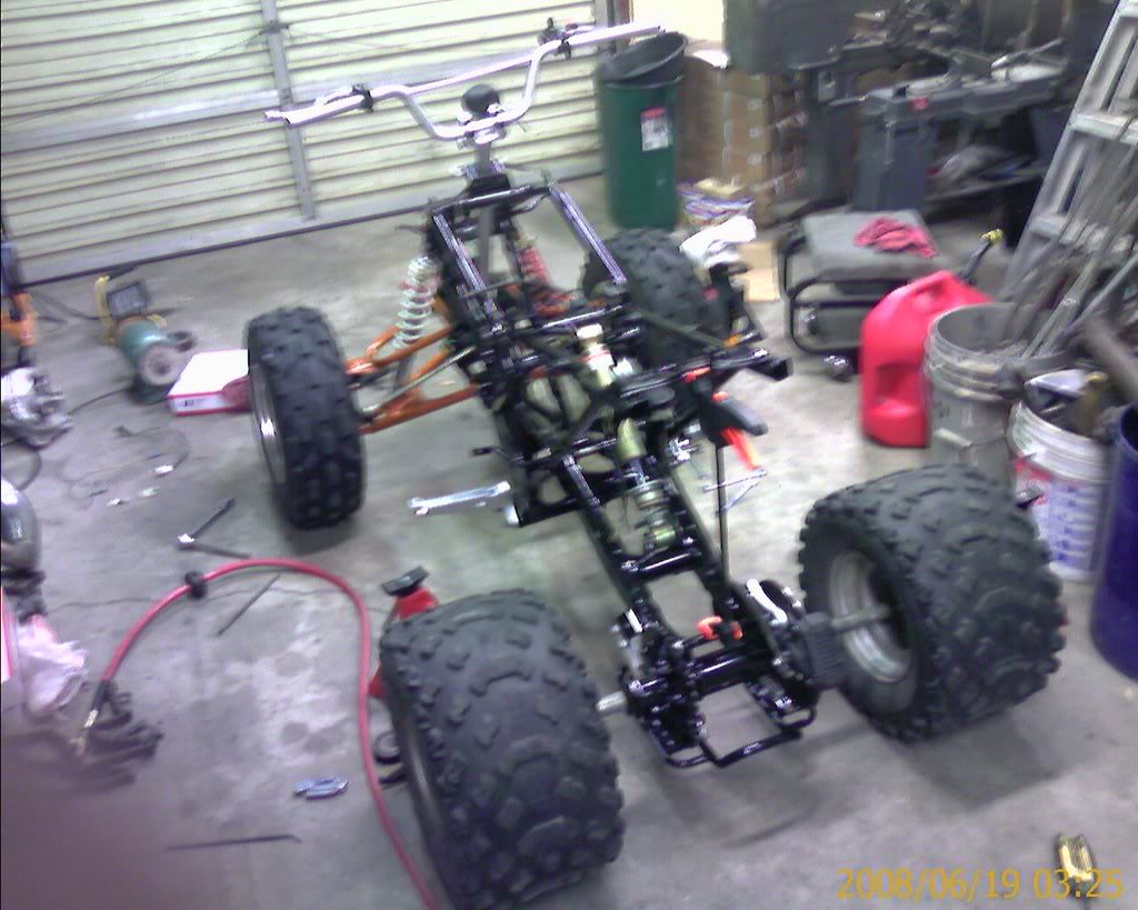

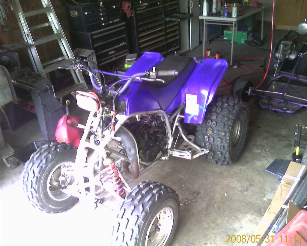

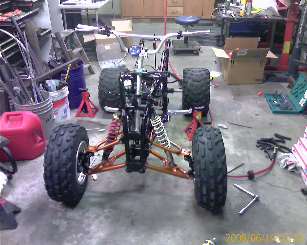

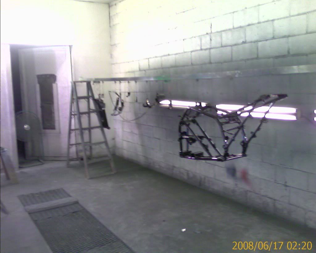

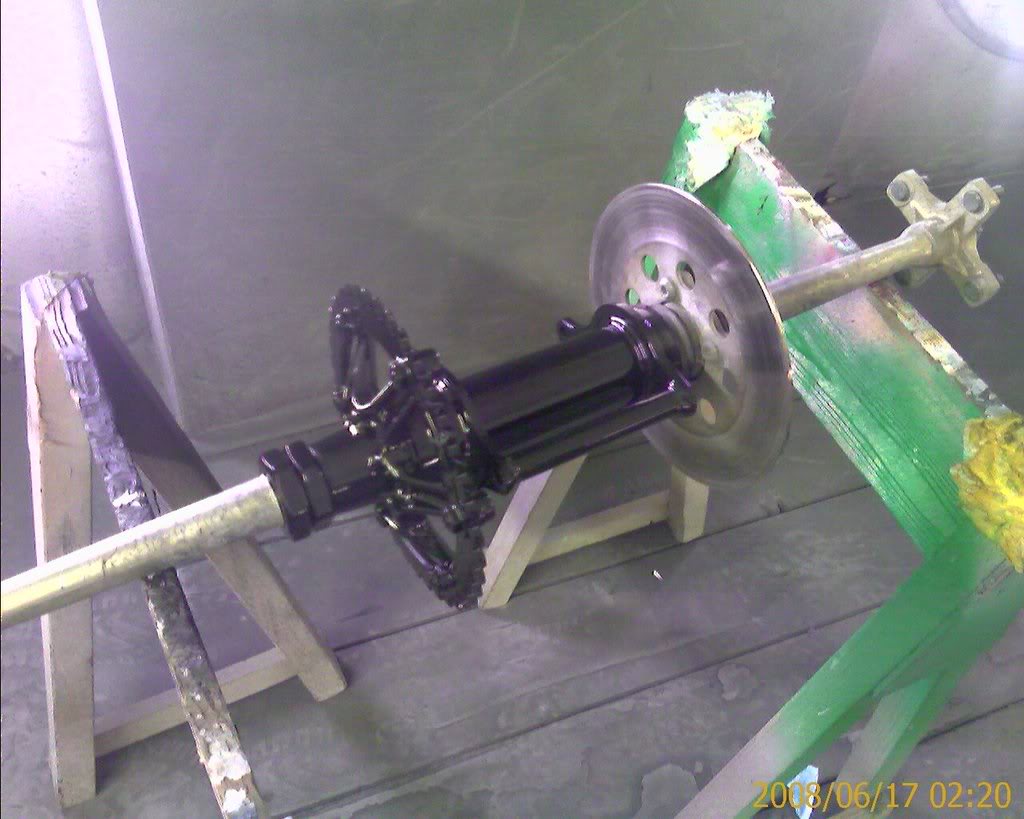

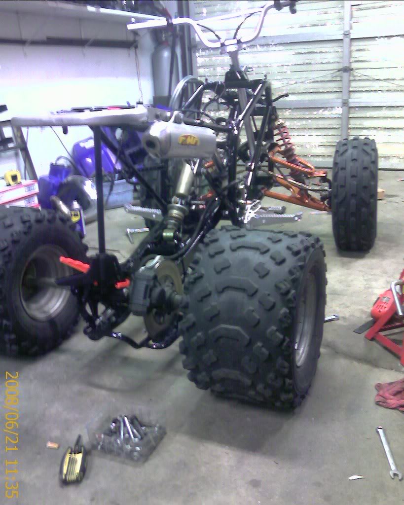

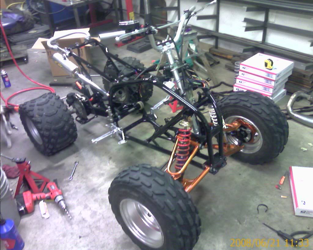

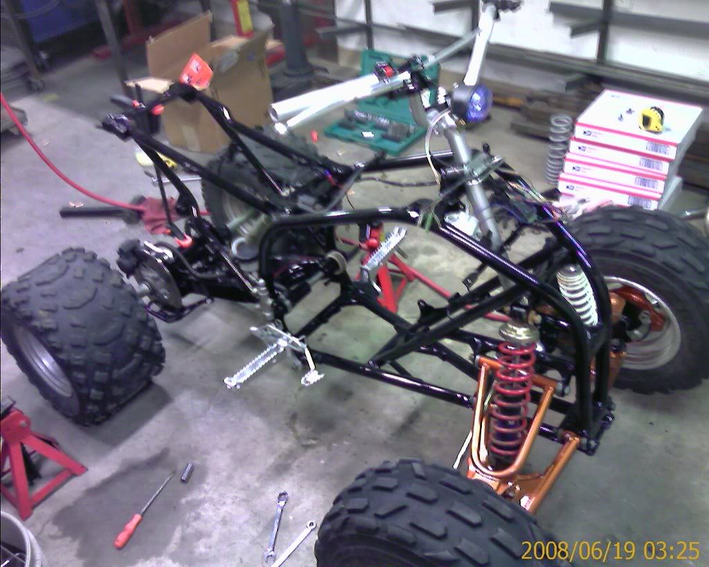

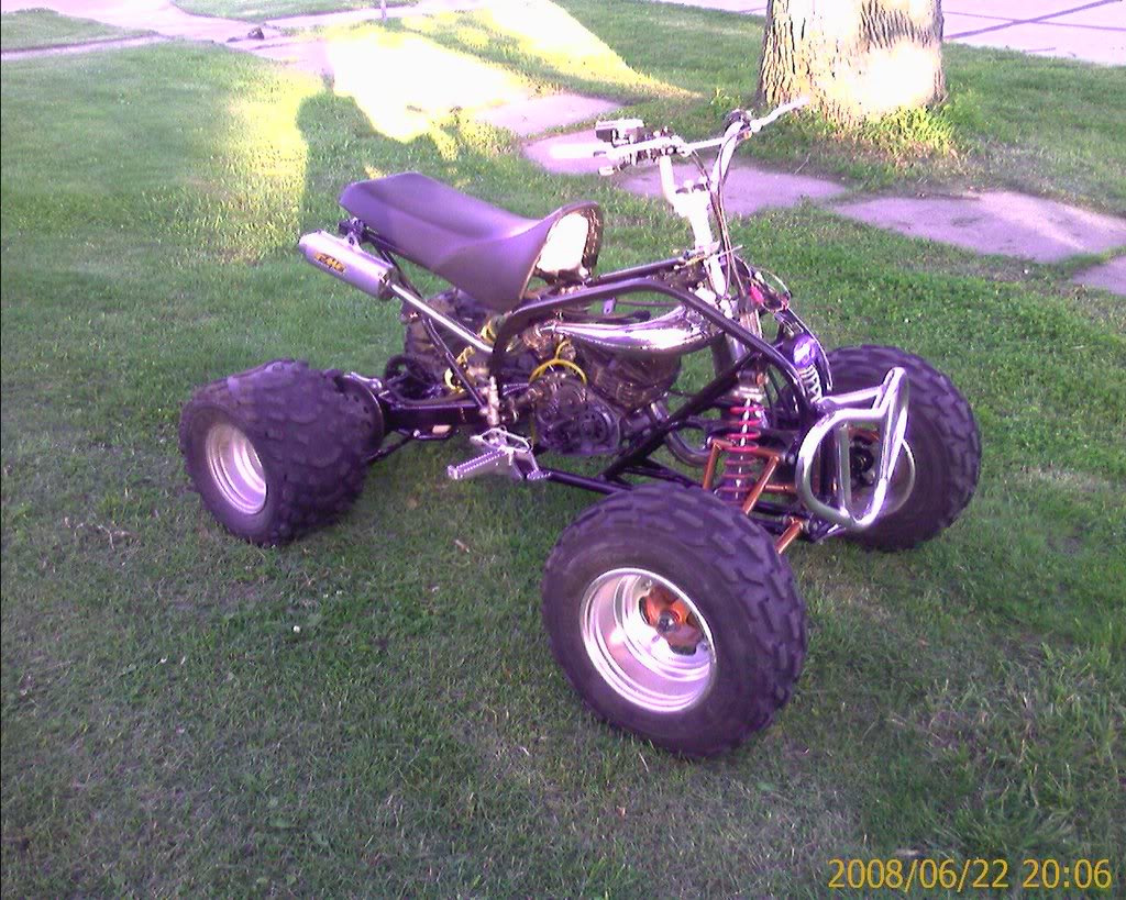

Here are some pics of my rebuild project, Shocks and rear tires are temporary until I get some others. Rear spring, waiting to decide on color (spreader clamp is temporary spring =). Waiting on motor shifter shaft and gasket to put that back in. Paint is Dupont Automotive base/clear from our mixing booth at the Street Rod shop. Color is Brazen Orange Effect. Plastics are not yet painted, I want to get the chassis done and set the plastics on and see If I want to do any modifying before painting.

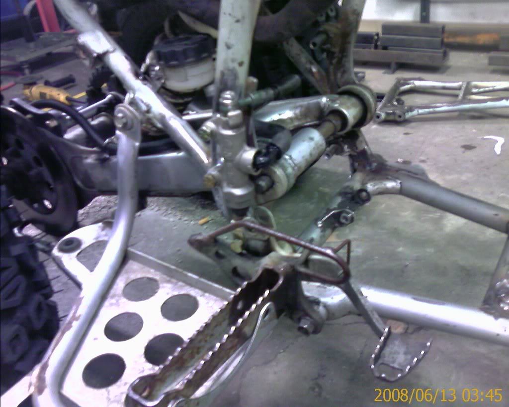

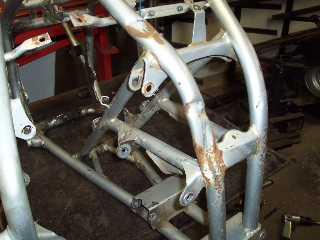

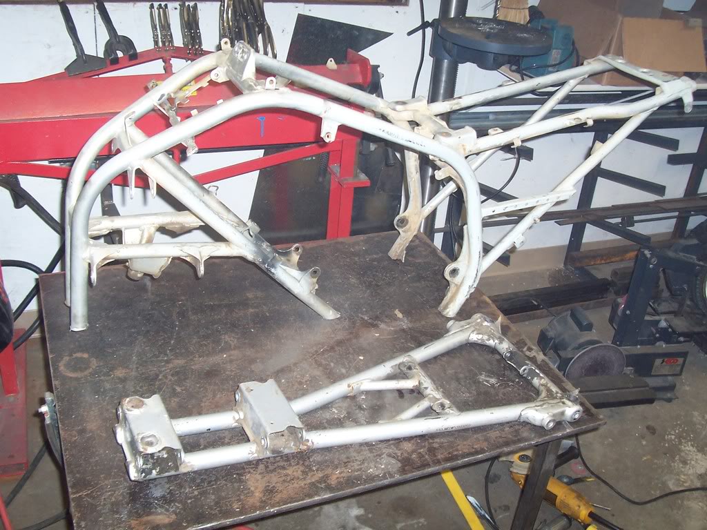

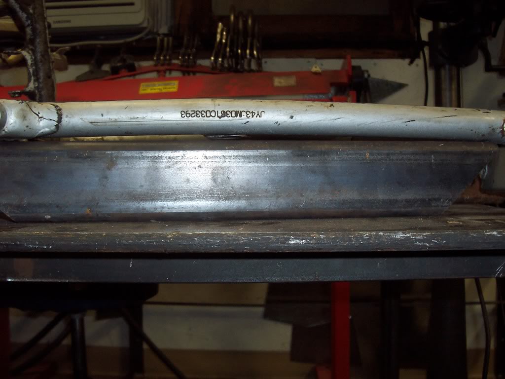

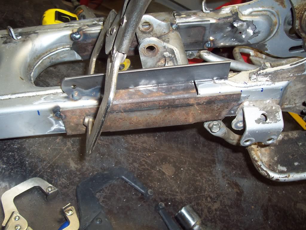

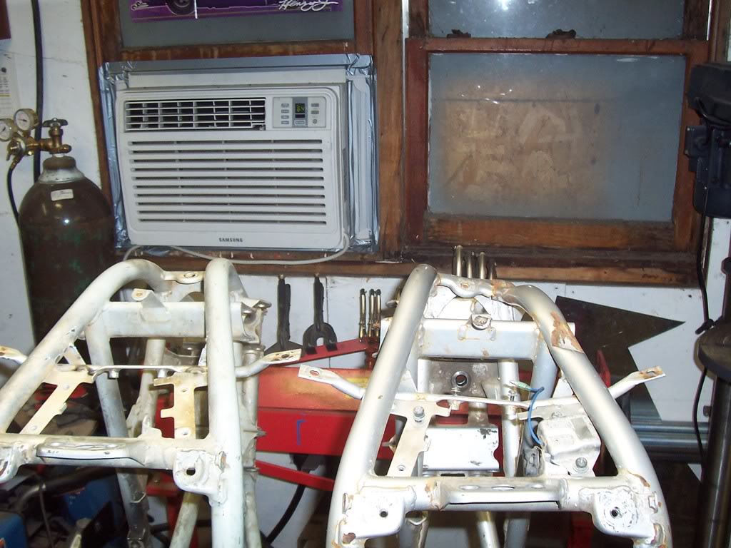

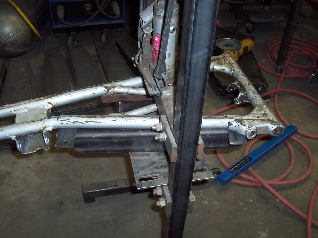

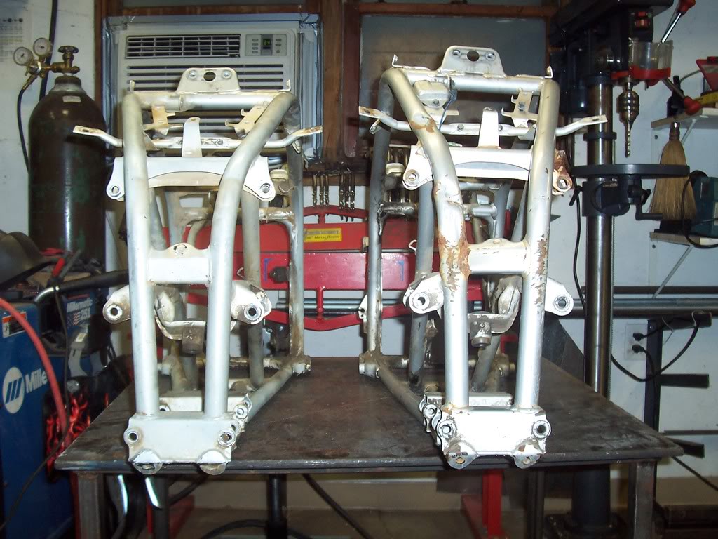

Chassis was hit real hard in the front, pushed it back and actually made the center of the chassis spread up and downwards. I got another chassis for $20 and used the top of it and the bottom rails from mine after straightening them in the press, and welded them up.

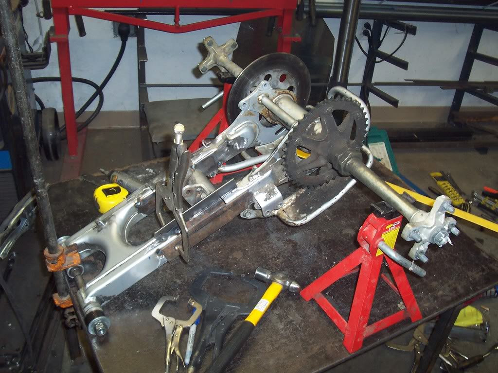

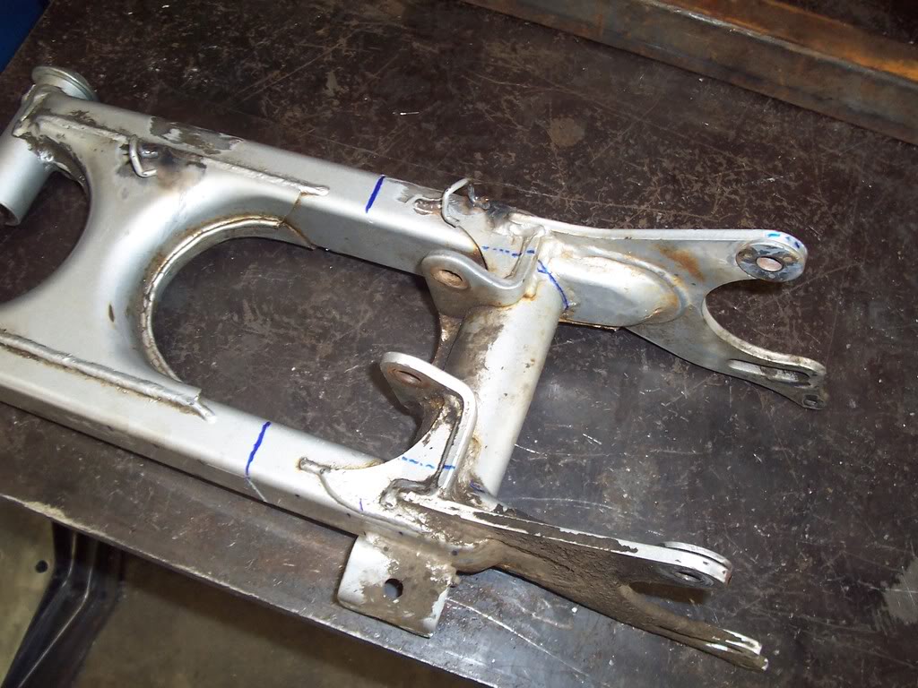

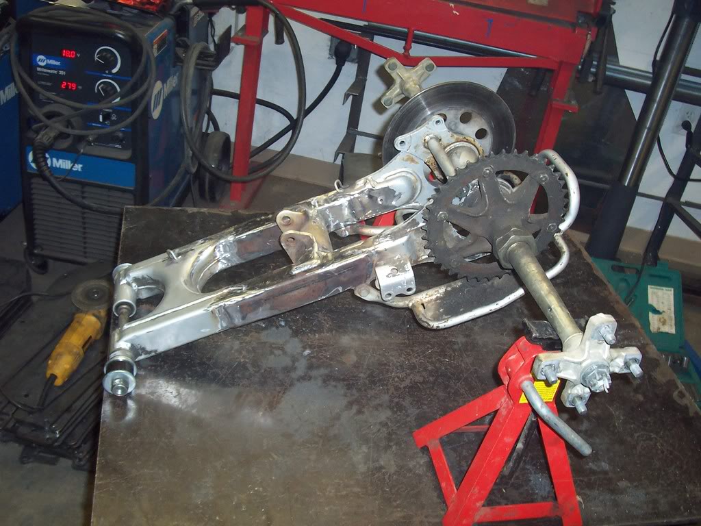

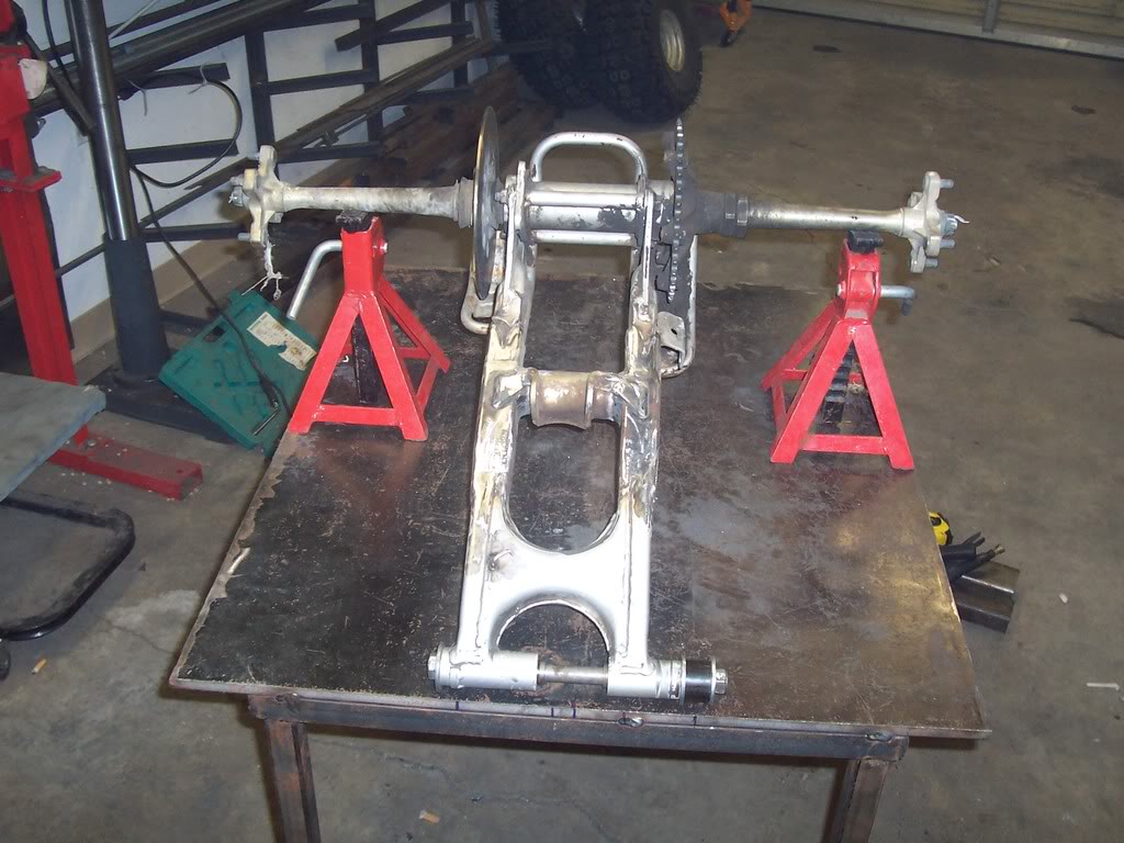

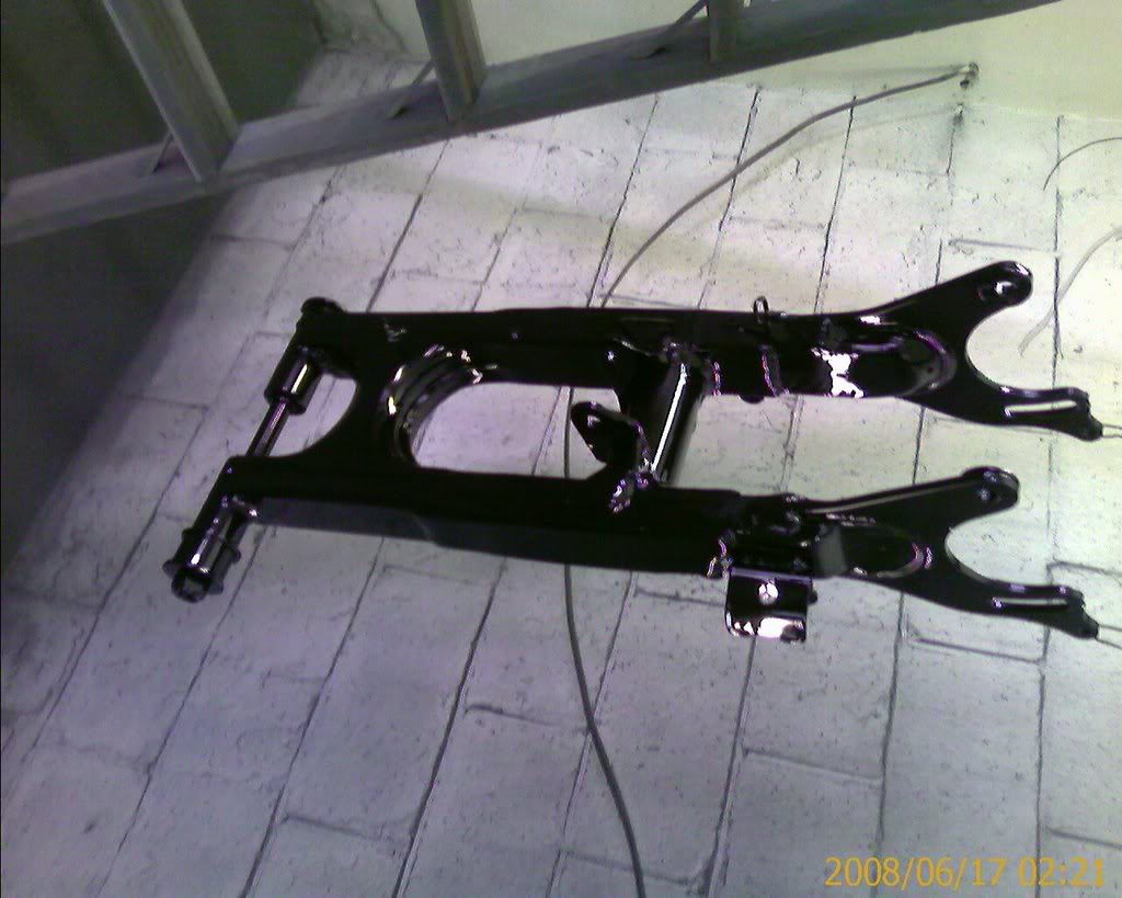

I also extended the swingarm +4 leaving the spring mounting were it is stock.

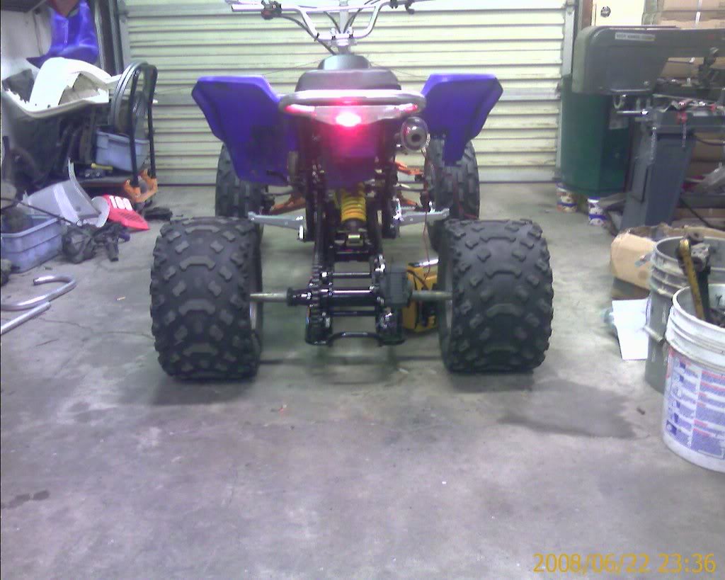

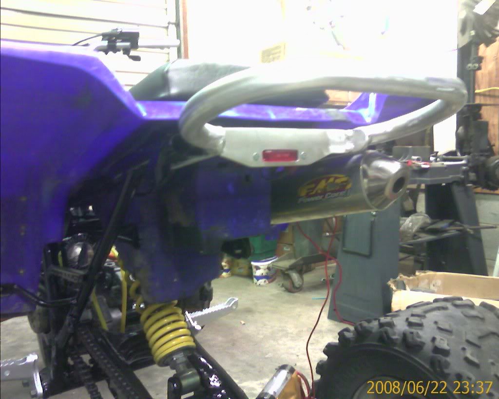

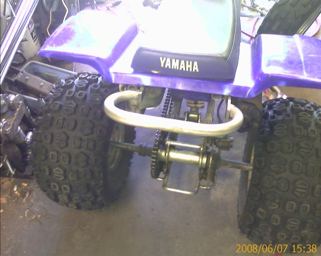

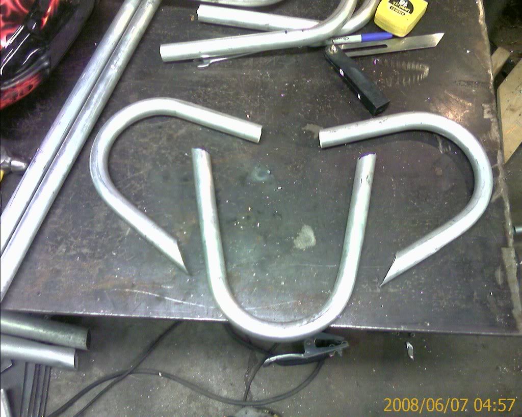

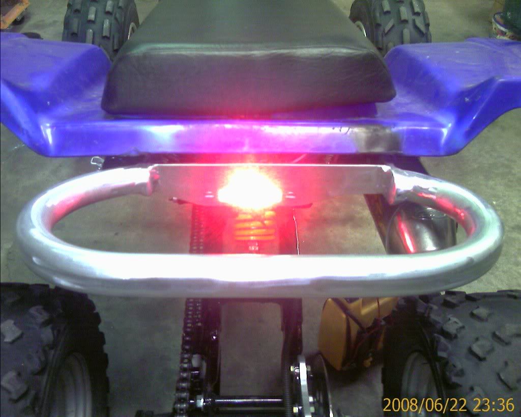

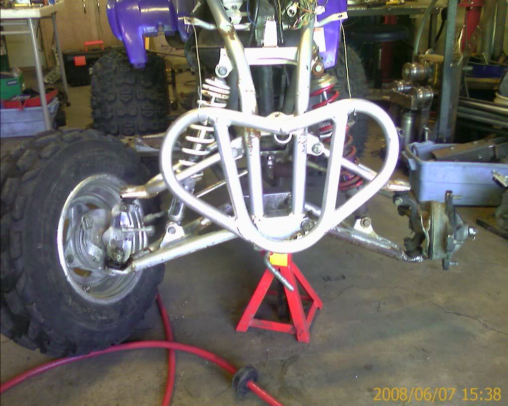

I made my own aluminum bumper and grab bar, they need brackets to bolt them on yet, finished welding, and some grinding, cleanup and polishing, but you get the idea.

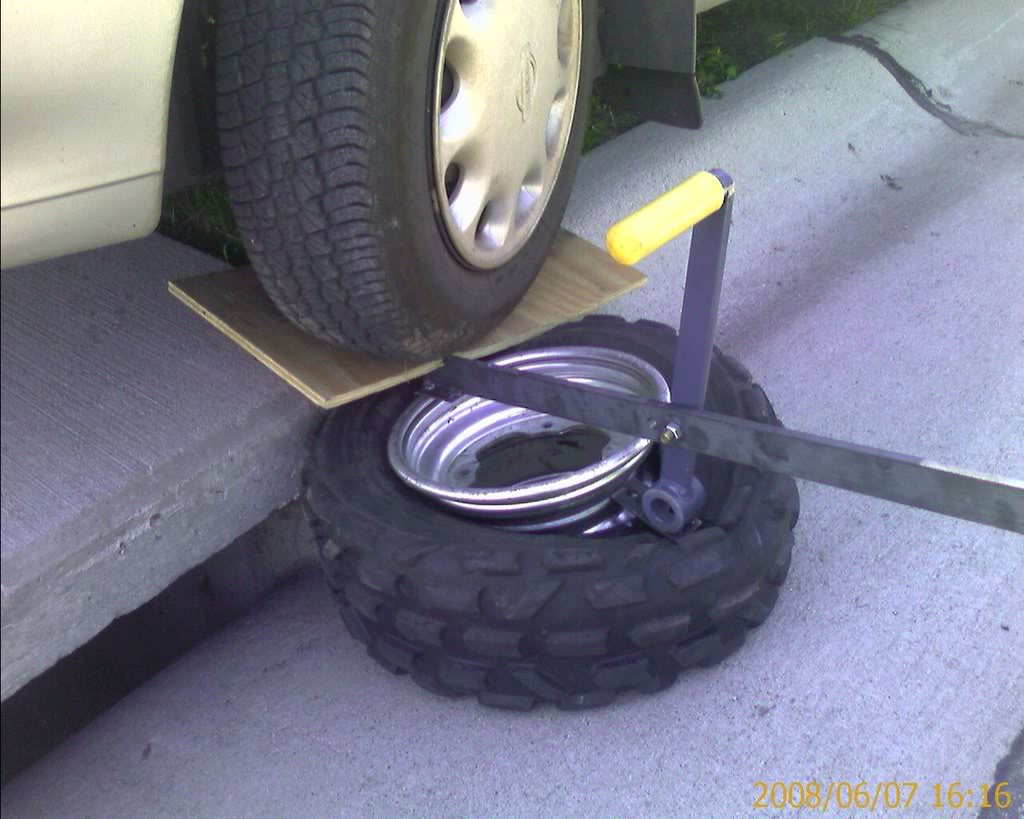

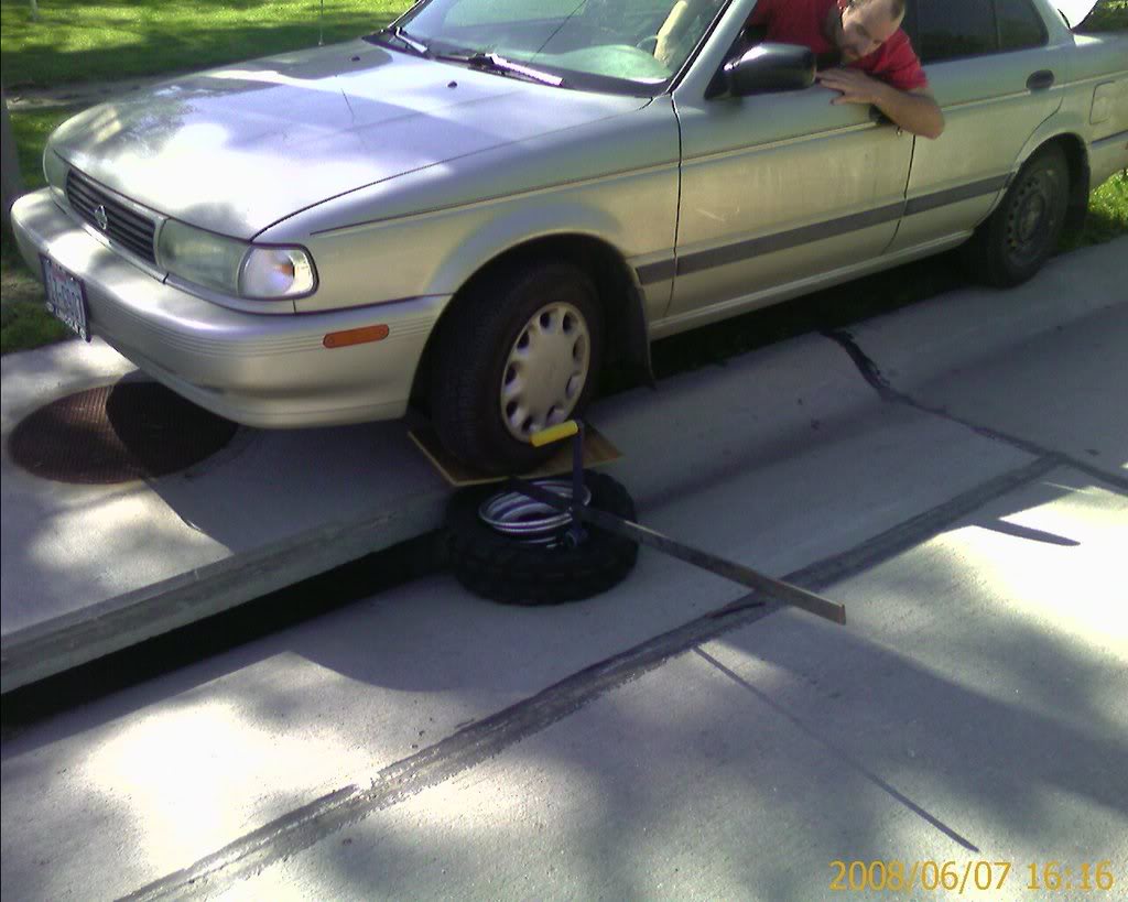

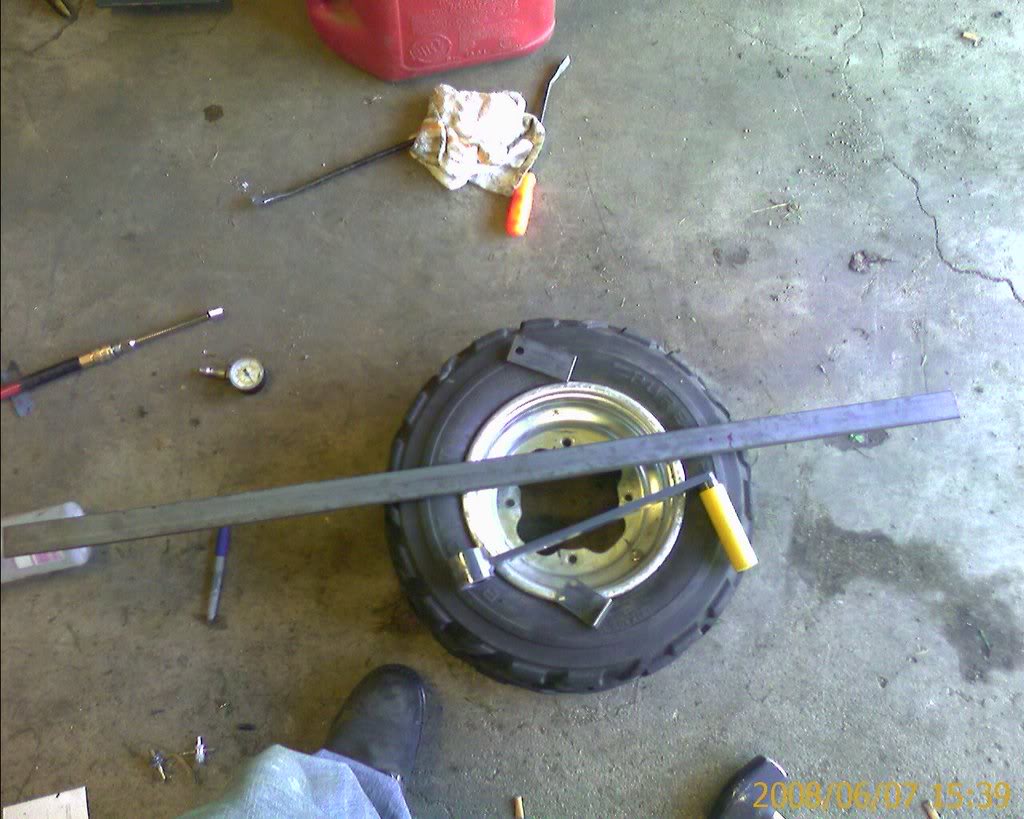

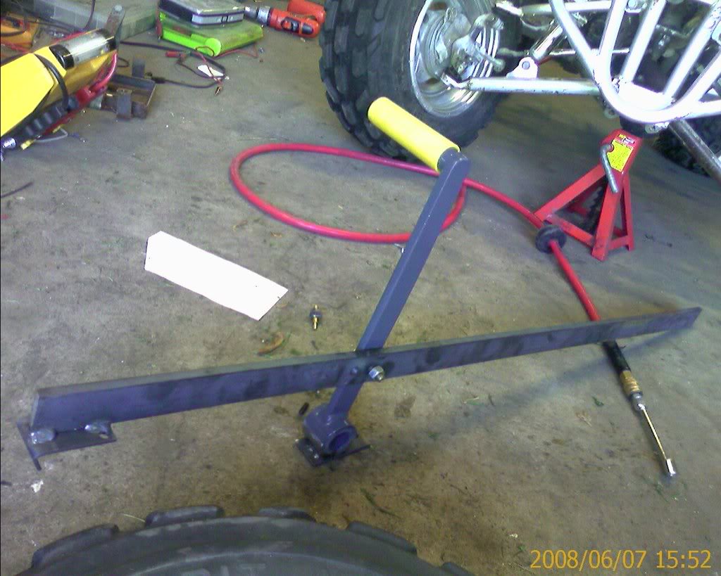

This also shows my quick homemade bead breaker, and my method of helping hold the rim down.

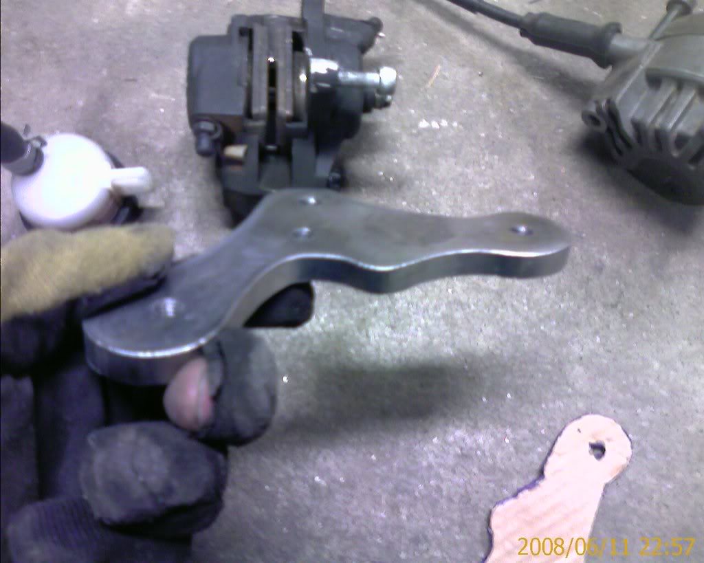

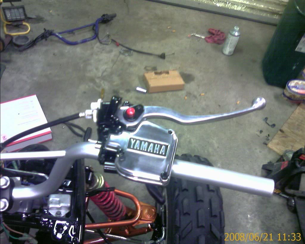

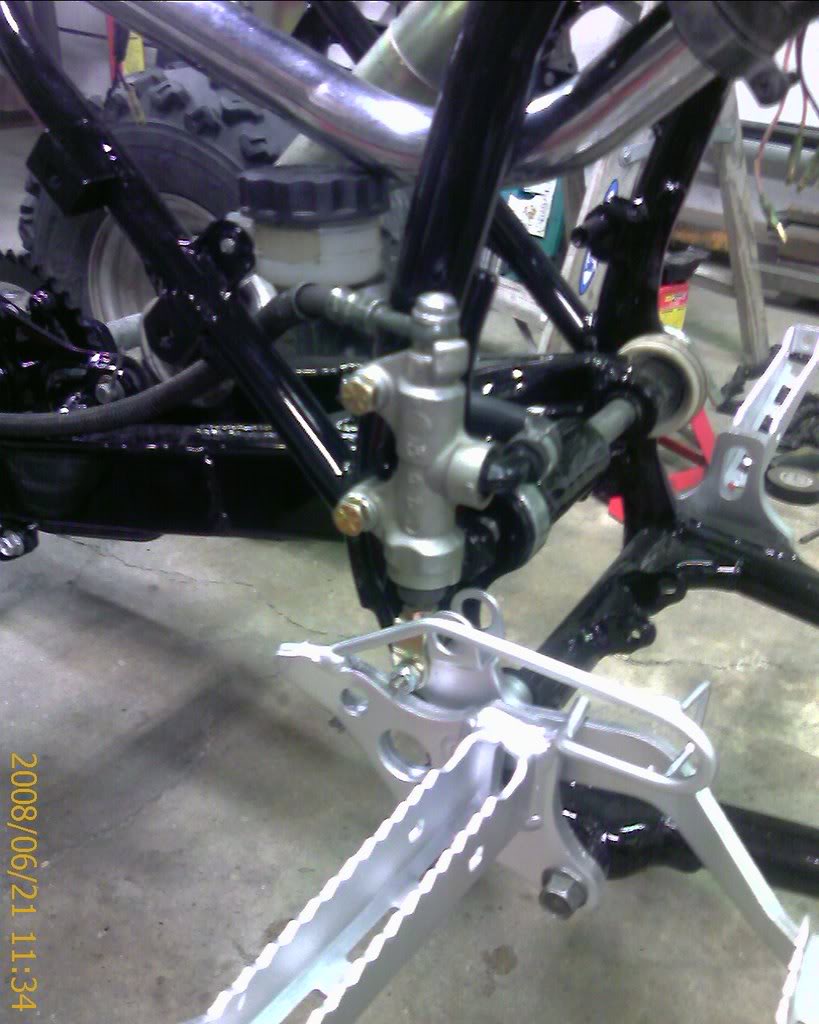

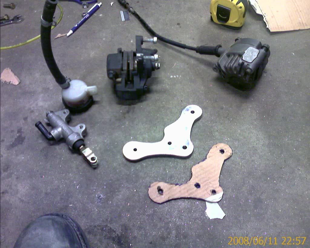

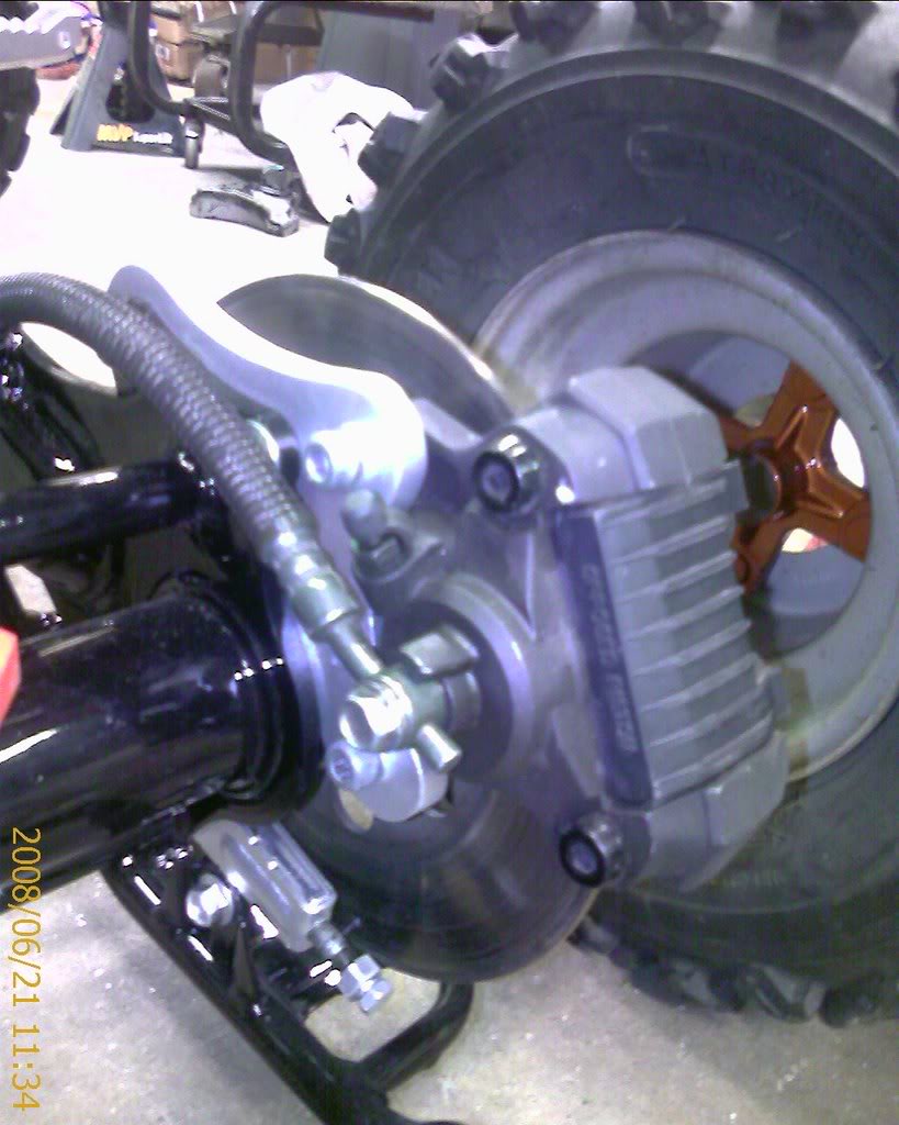

My hydro brake modification as well is in there too.
swing arm looks a lil crooked in the pics
I'll attest for the presicion and strength of his swingarm. I'm willing to bet the welds are bullet proof and you could use the thing as a straight edge. He'll be making mine soon, as soon as his is back in one piece. The pictures don't do this thing justice. I'll have to take my 6MP camera over and get some good pics.

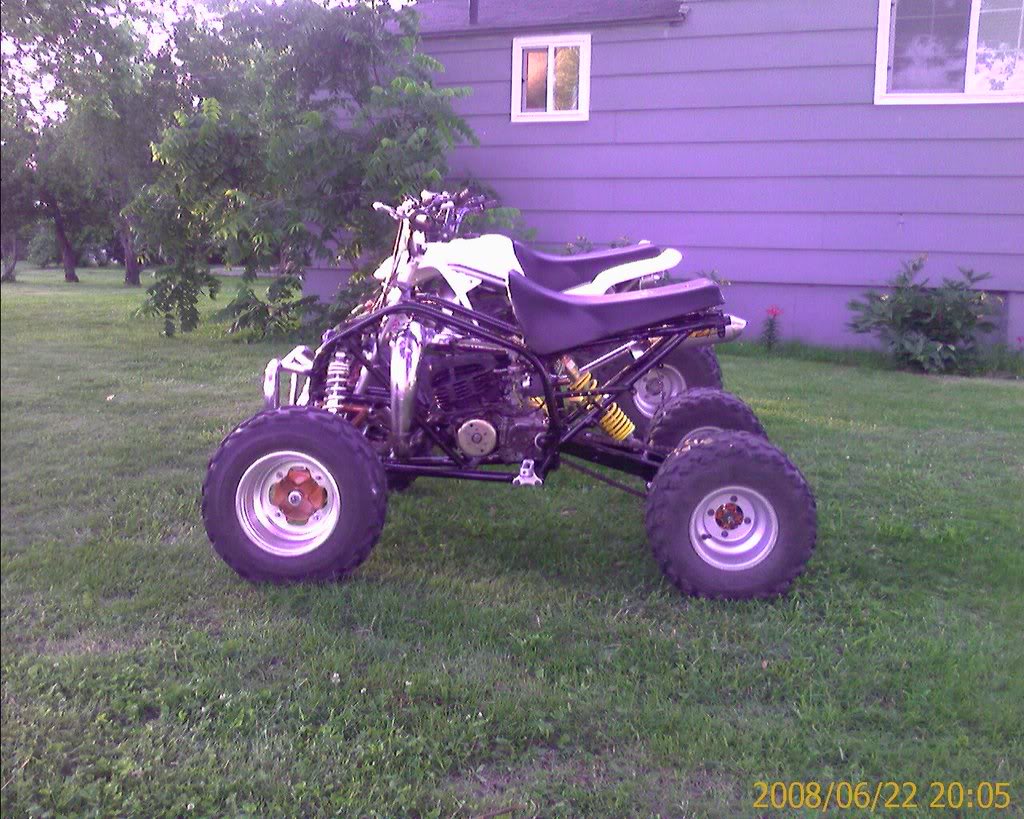

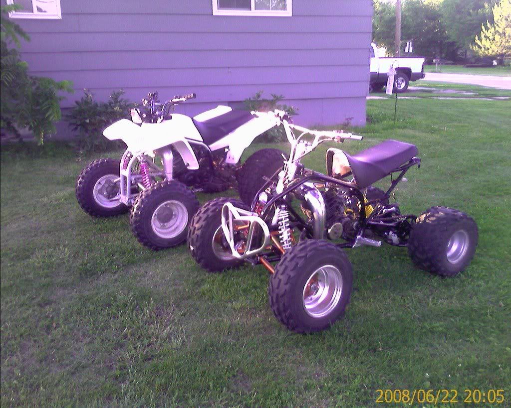

I got pics of Fowlrock!! See if you can guess which is his? (hint, pink shocks) I also got some updates on my build, motors in (except for shift shaft and clutch), seats redone (thanks to Fowlrocks wife), front bumper is done, polished and mounted, rear grab bar is done with tailight and flag hole, to be polished tomorrow, rear spring is in. Plastics aren't going to be blue, I put on the rear fenders while making the grab bar and light mount.
Sorry for the pic quality, Ive taken most the pics with my phone. When it is done, I will get pics with a real camera.
