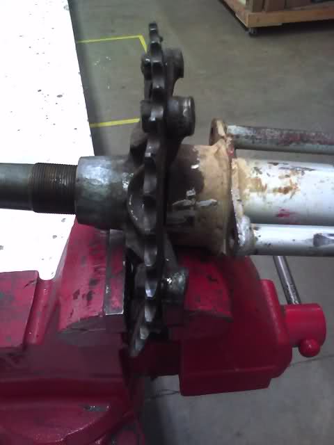

    If I ever get the %#@&ing sprocket hub off the axle, i can work on the brgs. I have heated to dull red, PB Blastered ,more heat, beat with pipe protector over threads , tried one homemade puller, have new design puller in the works. Hate the thought of spending $20 at auto parts to have it pressed.
    Probably take either grinder or cutting torch to brgs because I'm getting so tired of it X( , gotta be ready for Memorial day weekend. I:I Probably won't get swing arm brgs in. Wish I had something bigger than a 2lb hammer. Never force it, get a bigger hammer :D

    I woosed out. Even with a puller made with5/8 threaded rod and some other junk and heat and impact, the hub would not come off. Lucky for me a complete carrier/axle/hubs came up on CL for $50. I:I tite brgs, no rust/corrosion . Going pull it apart and put zerk in it.

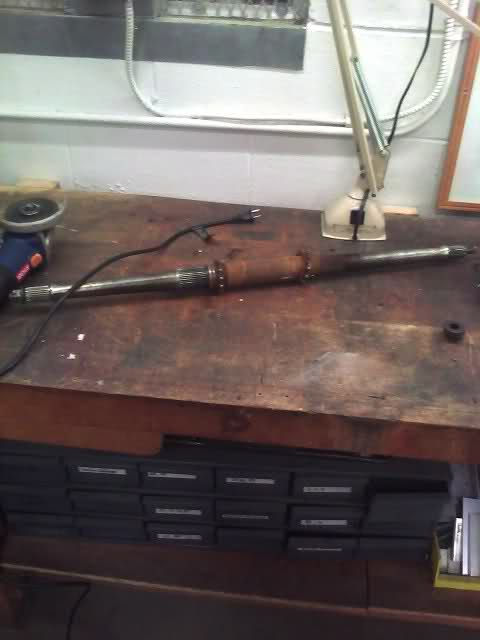

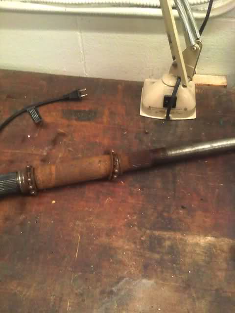

    Here is some pics of the carnage I had to deal with. Lesson learned....Install and use grease zerks.
    After the 8lb sledge wouldnt move it.
    [​IMG]
    After cutting off the carrier, sprocket hub, and spacer.
    [​IMG]
    [​IMG]

    wow poor bearings!!!!!!!!!!

    Actually should put anti-seize on axle where spacer goes and on splines for all hubs. I'll have to get my son to post pics of my puller that deformed and still didn't budge the hub. That's what 20 years of rust will get ya.
