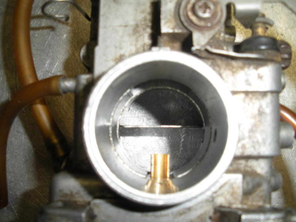

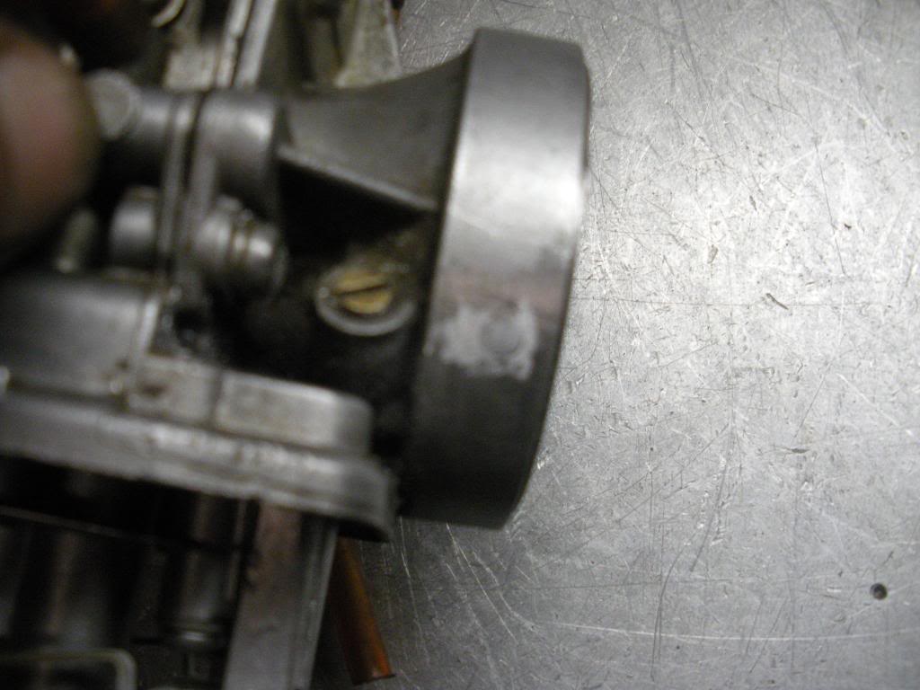

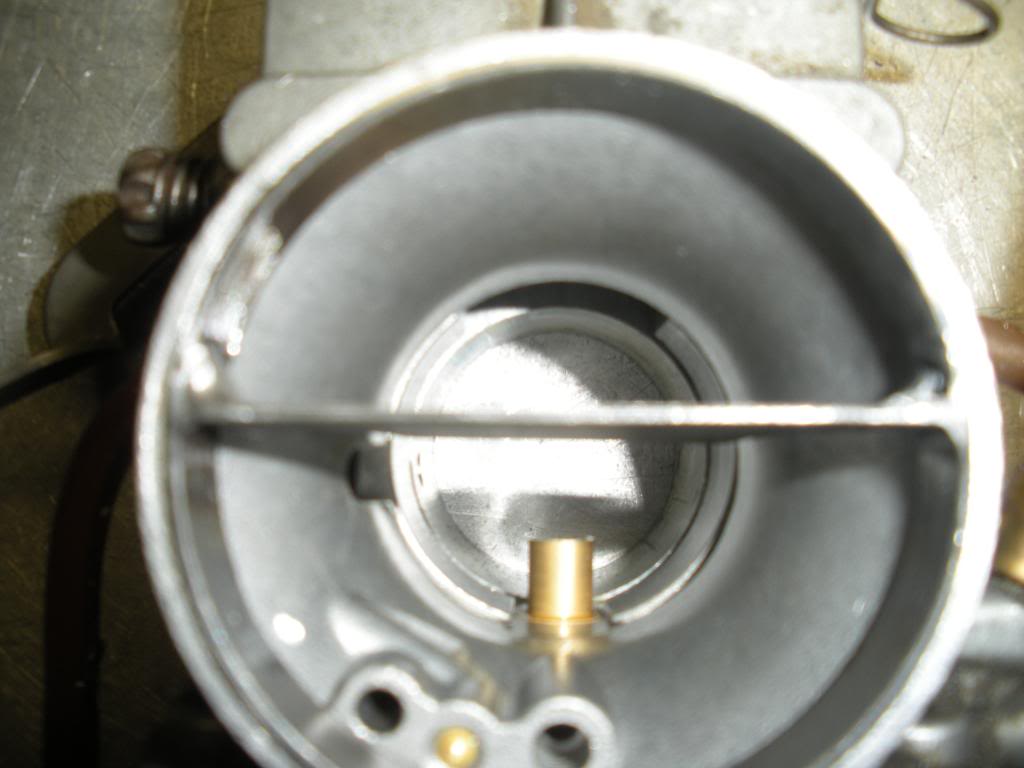

I've been pecking away at a few more mods for this engine. Here's a few pics of something I did to the carb. This is a Mikuni 34mm TM. This is a plate I built for the intake. Nothing new and nothing I invented. Never tried this on a Blaster but it worked great on one of Mike Duponts YZ 250's. The theory is to trick the carb into thinking it's smaller than it really is at ½ and less throttle. I think this may help the bottom end without sacrificing any top. If I don't like it, I can take it out.

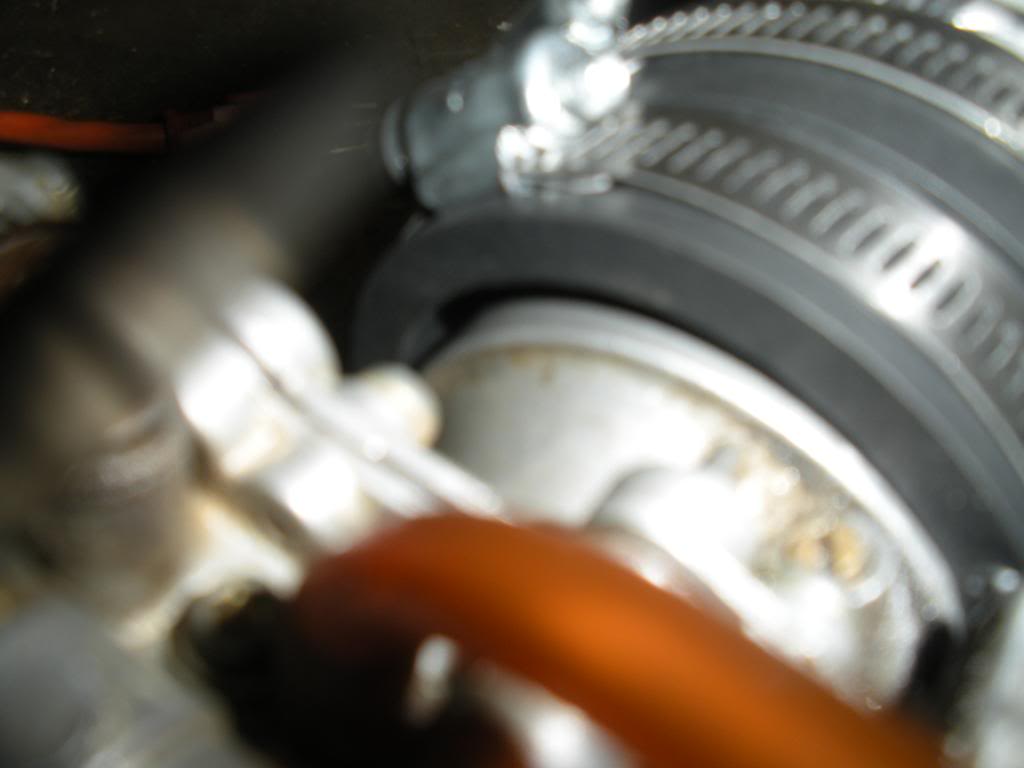

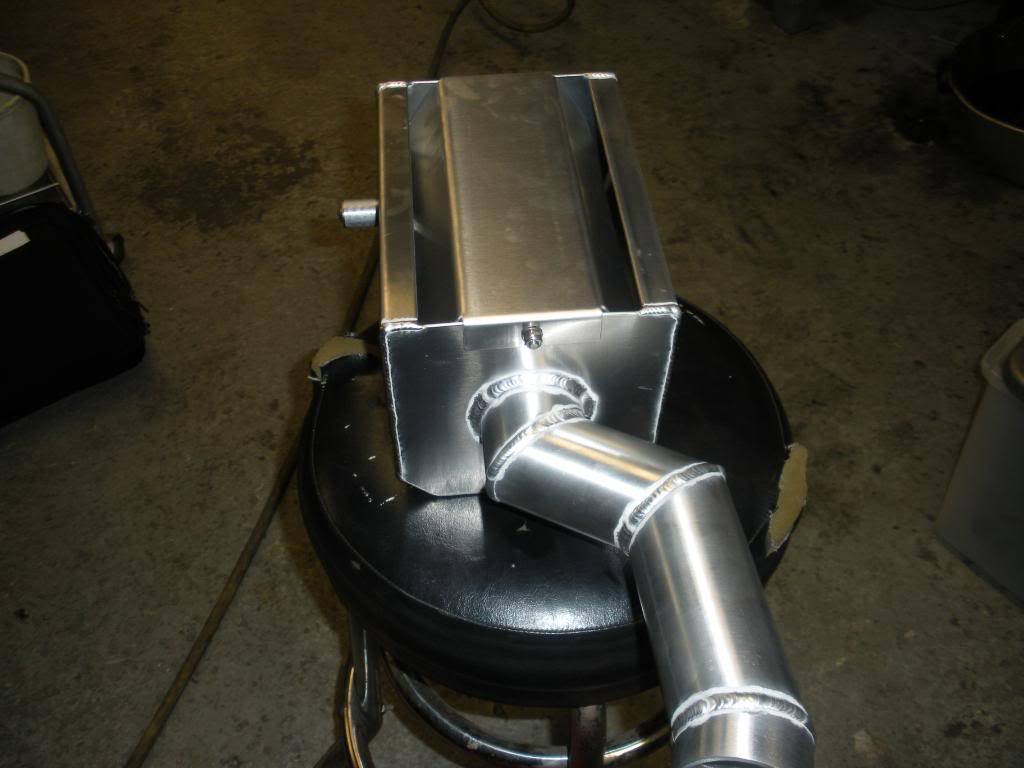

I got this in the mail yesterday. I've been wanting one for a while. As soon as I tool it out of the box, Tarmo said “We can make that”! Not even worth the effort for what I paid for it. I got it on E-bay as a “make an offer”. $75 + shipping. ( Thanks Ian!) Very well built and very light. The Fernco they supplied fits the airbox nice but I don't like the way it fits the carb. I'll be making an adapter for a better fit.

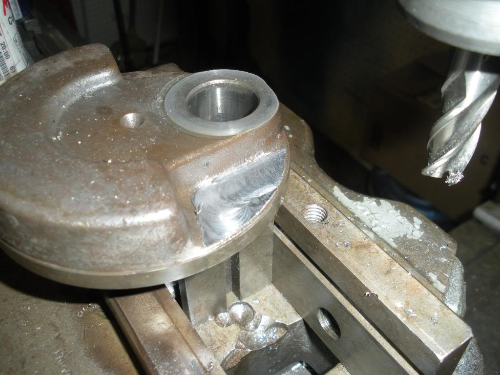

This is a stock Blaster crank. One thing ( the only thing ) I don't like about the Wiseco +4 is the lack of stuffer blocks. I'm doing an experiment to see if I can fit my +4 with blocks. The crank was set-up in my mill and a flat surface was cut. I thought about the radius in the corners and decided not to remove them. I'll relieve the stuffer blocks on the back to clear the radius. I plan on using Delron as stuffer material and bolting it in from the inside. I'll fit the blocks with stainless steel bushings and use green locktite to keep the bolts from coming out. I don't think balance is going to be an issue but we'll find out. Surf and Turf Racing will probably end up balancing the crank.
sweet mod with the "scary fast plate" in the carb, been thinkin of tryin to fab one of them myself over the winter !!!!
as for the adapter boot needed, heres what i found and got, and since then ian has purchased 2 of them and we luv them, excellent clamps too, and come in blue also to match the budlight blaster..........2.5 x 2.25 i believe
Intake Pipe Reducer
and you're gonna luv the cfm box, way better flow, possibly even requiring a rejet ??
did it come with a filter ??? mine was used and had some fakey k&n in it, since then replaced with this uni.............
NOS Uni Air Filter Pod 2.5" ID x 6" UP-6245 Universal - eBay (item 120589193356 end time Dec-24-10 14:40:45 PST)
Thanks Awk. Much easier to change the boot. I didn't get a filter with the box but I'll be getting the K & N with an Outer-wears cover this morning. I'm thinking two sizes or more larger on the main jet. I'll be putting the long-rod in the crank this afternoon and assembling the bottom end. I may shoot a vid of the assembly.
