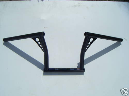

I added the rear pad section just to cover the holes and gaps that are there for now. I'm hoping to finalize the seat as well as drop it 2" front and back maybe a few other little things that will make a nice difference. not sure what all yet but it's definitely getting there... I still may change the bars to this. but it's $175 and this one was $75...
it's about 5-6" wider which is what I want/need and has a 6" pullback so I'll sit more straight up. and it will just FIT better, looks wise it MAY or may not compliment the bike better I'm not sure...
