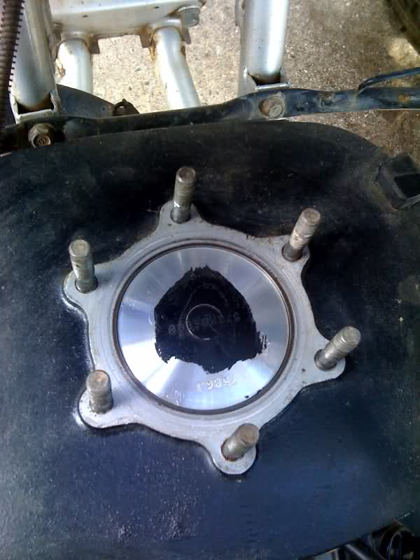

I challenge anyone to show me they've blown a engine from running chainsaw, or whatever oil! None of this hear say sh*t, none of this "I only run this" sh*t, but solid evidence that running chainsaw oil kills your engine. I bet you could use 10W 30 as a premix and not even burn your top end.
Here is my piston after 30 hours of run time with the cheap gas station oil.
When i pulled the top end after about 40 hours is still had over 150 in compression with a modded head.
I can back my statements with picks, can anyone else? I'm not trying to start anything, just saying that oil is oil! keep it oiled and you'll be ok. Dyno, synthetic, whatever just oil it.
I should like an expert opinion on that piston , it sure looks like to me that complete combustion is not being obtained.
