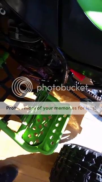

finally got everything but my airbox, started it up and this is what it sounds like
i checked torque on head and base nuts
things we thought it could be
my dad thought it sounded like my brothers with a stock pipe. he suggested i ride it until its warm
im wondering if having 150psi is too high for 91 octane fuel
giz said to check rod play. but i dont want to do that first. i will order a gasket monday though
also, i put this in carb because there is no "sounds funny" section in engine.
and it fouled a plug in about 3-5 minutes. so idk what causes that, it was never a problem for me
