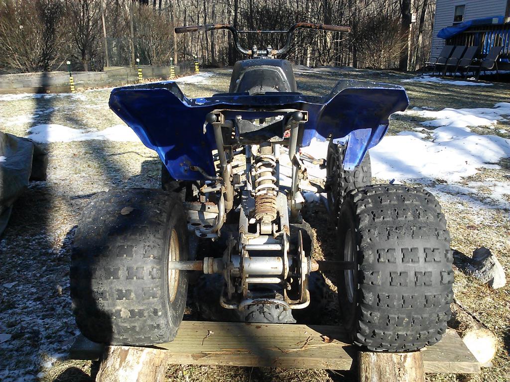

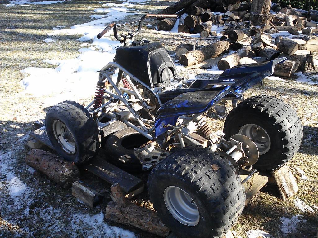

My name is TWal, and this is my first post here on this awesome forum. That being said, I've been sneaking around here for months and have spent countless hours reading up on literally everything about the Blaster. Having gained a semi-decent knowledge about the ATV, my friend and I took a trip up to upstate NY to purchase this beauty:
I don't know the year of it, but I know it's in very good shape for its age. It doesn't have too many dents or dings, barely any rust and all of the core parts are still attached. Here are some more pictures of the rolling chassis:
The Vision
ENGINE: When I find an engine, I will have it professionally rebuilt and bored out to 240cc's (at least). I want as much reliable performance as I can get out of this Blaster.
FRAME: I am going to disassemble everything on this rolling chassis and paint everything. I will have the frame painted (or powder coated) black, the control arms red and the swing arm black as well.
SUSPENSION: I will be purchasing new struts (colored white) but will NOT be changing it otherwise. I do not want long travel suspension with this build.
TIRES/WHEELS: The tires I have now are in good shape. I will, however, be purchasing new wheels to go with them. I'm on the fence between new polished aluminum ones or some other pattern (please make suggestions).
BRAKES: I will need to purchase an entirely new brake system for this Blaster. As you can tell, I'm missing the rear brakes completely, and I still need to figure out if the front ones work. I was told by the guy I bought it from that they didn't but I'll definitely test them.
FENDERS: I need to get all new fenders for this Blaster and will likely paint them red and black. This will probably be one of the last categories I tackle unless I find a great deal.

I am also embarking on my first complete build.I have done a lot of work on quads\trikes but on my first build I paid $140 for a complete 03+ roller engine included[but partially apart].If you don't mind what do you have in it so far?
You can tell the year of it by the tenth digit of the vin. It is located where the gear shifter would be on the quad. I can sorta see the vin in the pics but can make out the numbers.

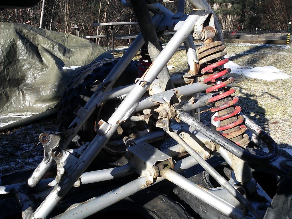

Looks like you have a great starting point. You have your plan set so go with it and make changes accordingly. One thing I will add is no matter how fast the engine you can only ride it as fast as the suspension allows. With that said I would atleast look for some standard travel works shocks in the future.

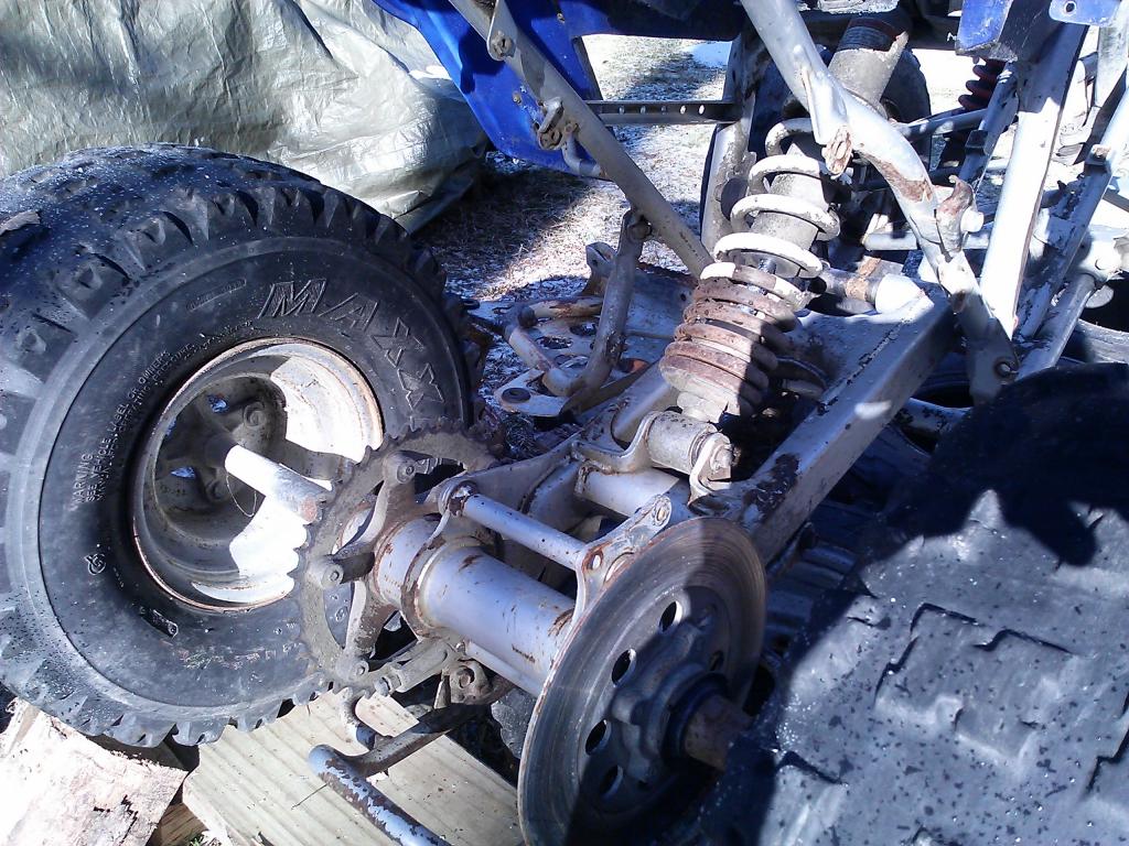

I am not so keen on how the rear sprocket looks, make sure you buy a matched set and a new chain.

I appreciate the suspension tip, and that definitely makes sense. I will look into all of that when the struts become a priority.

Thanks a lot! I thoroughly agree and will definitely be inspecting it closer (i.e., replacing it) when I begin work on the power train.

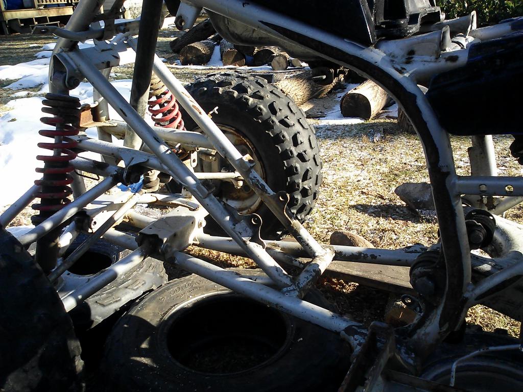

That's how my build started. Just a roller and missing 99% of the original hardware. But my build is anything but stock. As for suspension, you will want to upgrade like everyone suggested. A stock blaster will bounce all over the place and you will fight it over every bump, jump and turn and eventually get bucked off like a rodeo clown. While you have it apart, gusset the frame. That way it won't get bent in an event you can't control. Trust me, it happens.
THAT IS A GREAT IDEA! THANK YOU! The whole thing is going to be apart soon and gusseting the frame is a VERY good idea. Do you know if there are any kits floating around with pieces that are sized correctly? I would definitely be up for fabbing them if not.
Do you have any suggestions for exactly what I should do with the suspension?
There are a couple post on here about gussets with location and sizes. You will have to make them. There isn't a company that pre-makes them for the blaster anymore. I searched everywhere.
I suggest Ken O'Connor for the engine build. Guy can do it like no other.
Depending on your budget, you can send him the entire motor and have him press in a new big bore sleeve (240cc) Or you can buy a whole new cylinder already with a sleeve in it. But if you got a cylinder on last bore, or wrecked, i suggest re-sleeving
Don't know if they are still doing it, but the pic shows the placements.
THANK YOU! This will help me a lot.
