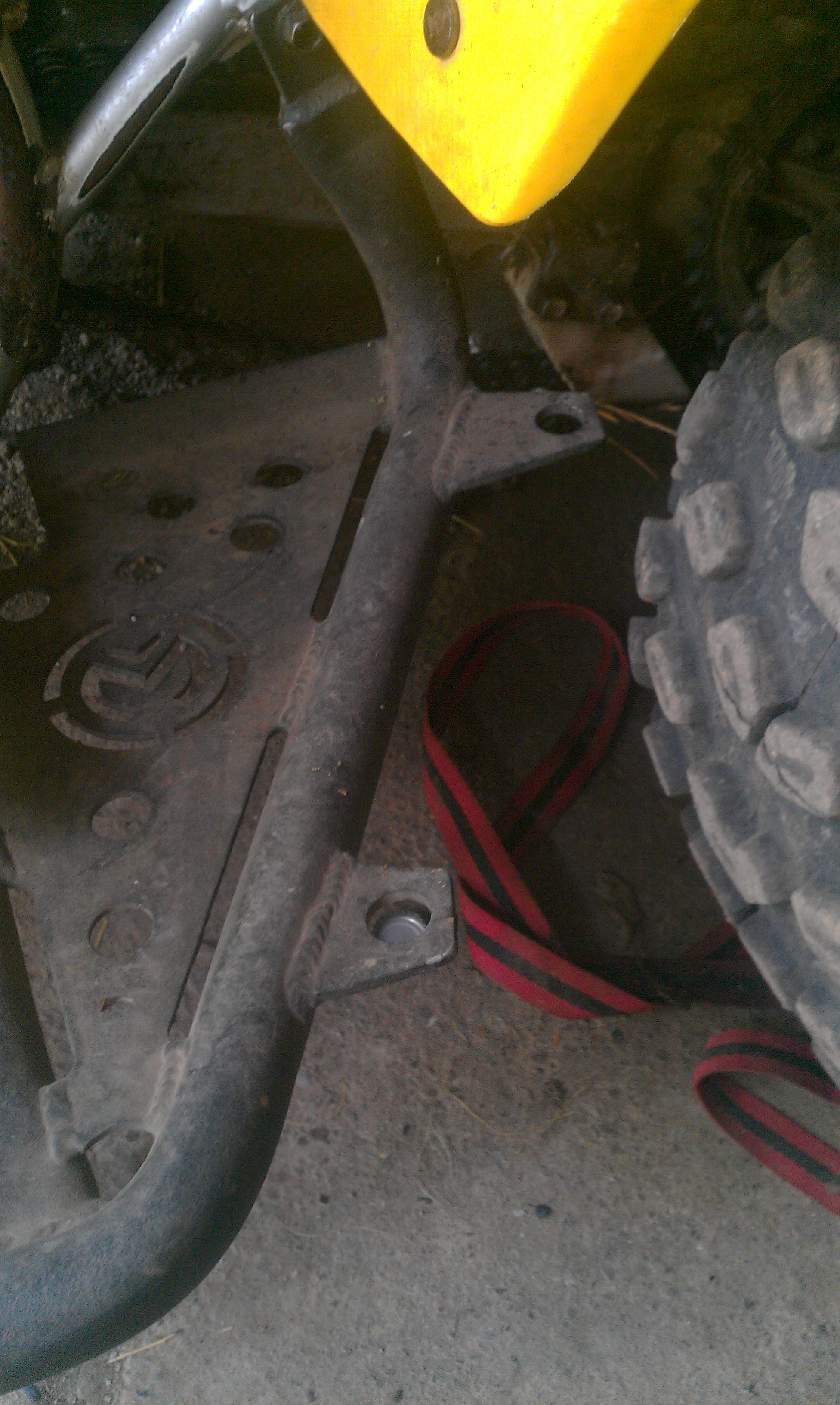

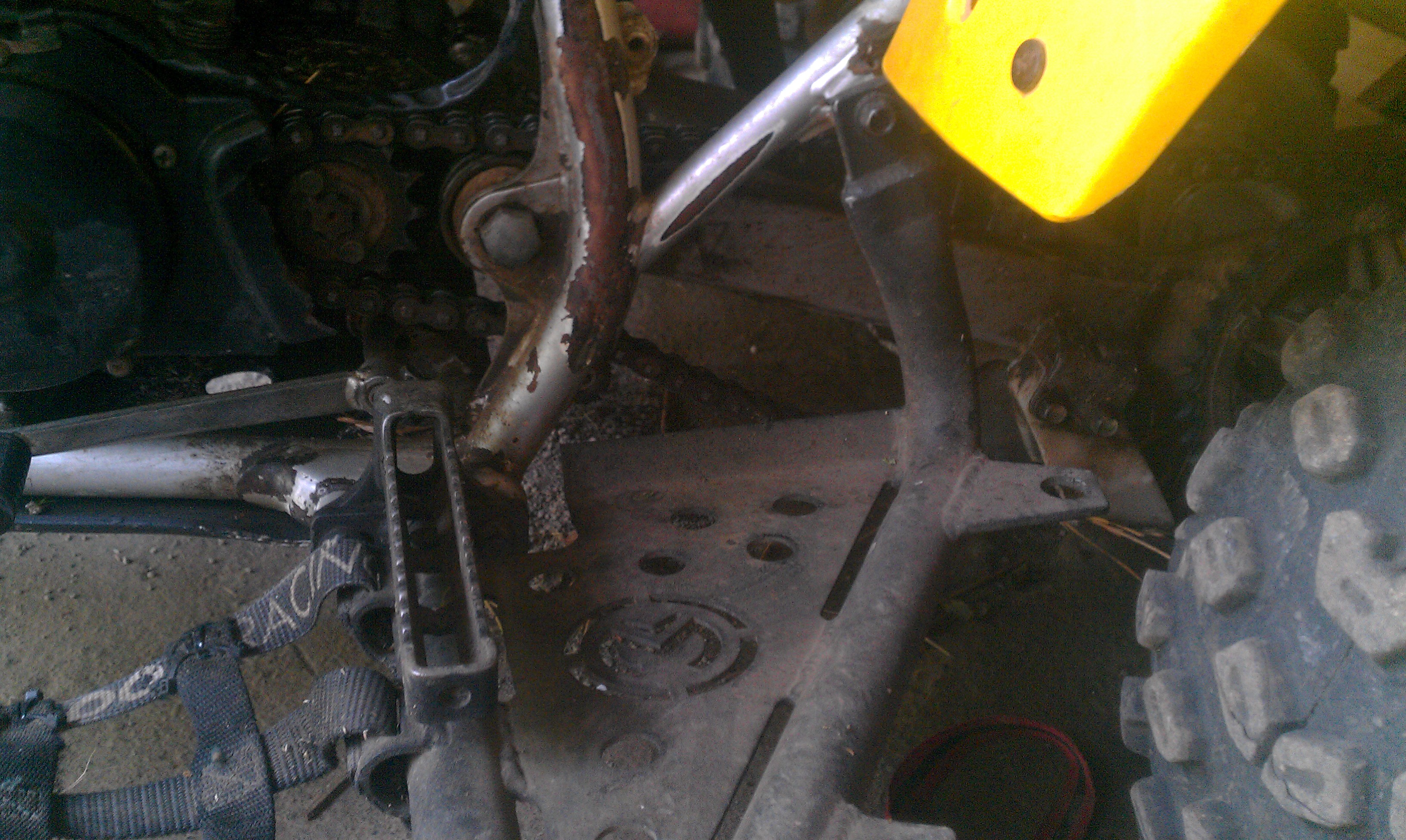

Hey guys. Does any one know where I can geta set of the stock plastic heel guards that go from the metal heel guards to the rear fenders. My foot almost got eaten, so I'd like to get a set lol

I have Moose nerf bars so I doubt the rappy heel guards will fit. Im probably going to have to have some one weld an aluminum grate or a plate or something so my feet dont slide back

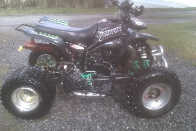

i have yfz's on my black bike with nerfs that extend back past the pegs.............

I have the left side plastic heel guard I'd sell you but don't have the right one so that doesn't do much good. IMO your best bet would be to weld something on to the back of your nerfs. I don't know how you would attatch the stock plastic ones with aftermarket nerfs on there. There would be nothing for the bottom posts to go into. The dealer is probably the only place you could get those stock heel guards though or maybe motosport.com or rockymountainatvmc.com
I know that tusk makes some metal ones that have the back portion fron keeping your foot out of the tire and has the bottom part to keeP your heel from slipping off of the back of the peg. But as far as stock options, I don't think you'll find cheap ones that are usable.
