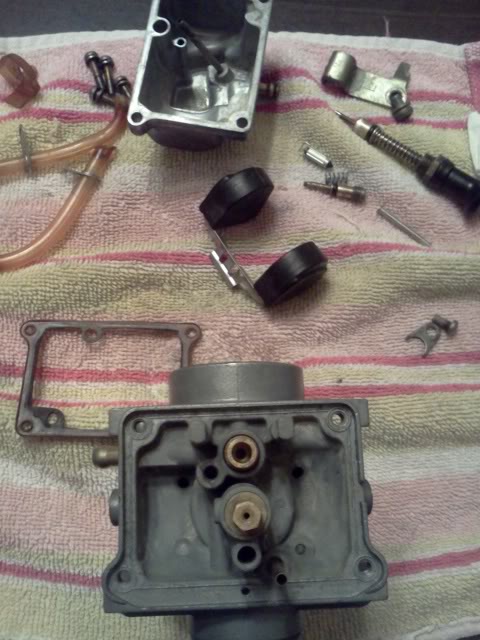

Nope haven't tried that. What's still bugging me is about the carb overflowing with fuel once I turn the valve back on. It done that the first time I cleaned it but cleared itself up and got running fine for a week. I mean that week I would fire it up everyday on first kick. Now, after this second time I took it apart when it stopped running, I put it back together and it did it again, fuel coming out all vents until I either pull the choke or hit it out of frustration. Could the floats be off? And if they are why would they be after it's been totally cleaned? Again if they are how do I go about adjusting them to get them into spec? I saw a picture of where they need to be on here I think on the carb cleaning how-to thread but no directions on how to adjust.
float level on a stock carb is 20 - 21.5 mm, with the bowl gasket removed, measured like this from where the gasket would sit to the highest point on the float..........
they are adjusted by bending the little tab that the float valve hangs from in the center of the floats, bending it down will reduce the measurement, go a little at a time, then remeasure

k not sure if this might be why it is overflowing, but i had a problem where the little needle valve with the rubber tip was not sealing the fuel flow when the floats would raise, causing fuel to overflow... the floats were adjusted correctly, its just that the needle valve's tip had worn a groove and would not seal... so i just replaced it and it fixed the problem...

you need to hold it like my above pic shows, at like a 45 degree angle, so the floats arent pushin the center pin down on the "plunger"
look closely, you'll see that it pushes a little pin in the center of it, it should just be touching it, should just be touching it, not compressing it
but they look too low from your pic, bending the tab down a little will raise the float and make them shut off fuel flow sooner/lower
you can also attach a piece of hose to the fuel inlet, blow thru it while operating the floats to see if it's actually shutting it off completely
and check the neoprene tip of the "plunger" for cracks/tears or other discombobulations, if so, it'll need replaced
