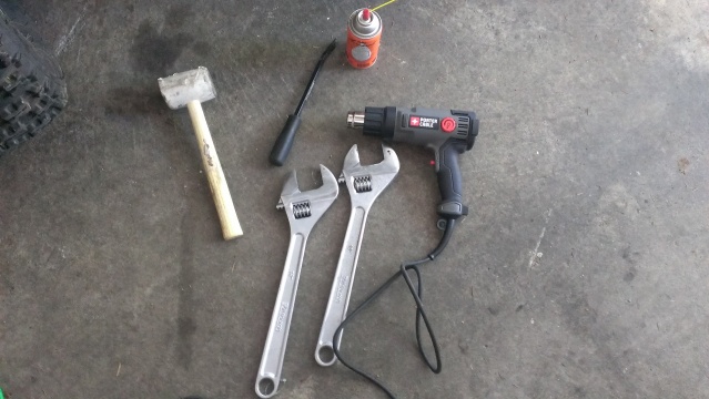

I bought an 18" adjustable wrench from Harbor Freight for $20 and borrowed a second from a friend. Guys have used pipe wrenches but it leaves nasty tool marks. I didn't want to spend $40 for the Tusk tool which is pretty much one time use, you can make your own if you are a good fabricator and know how to weld.
