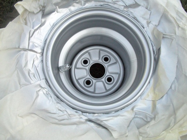

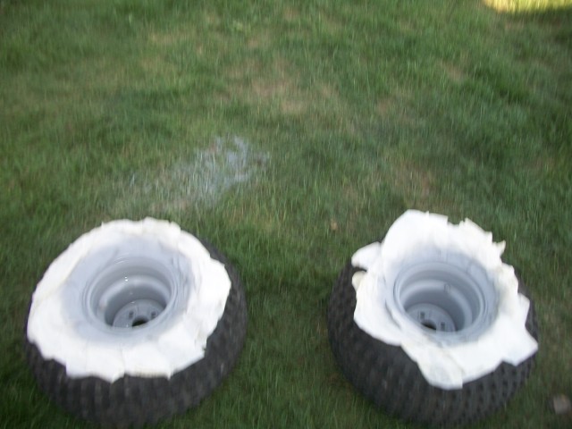

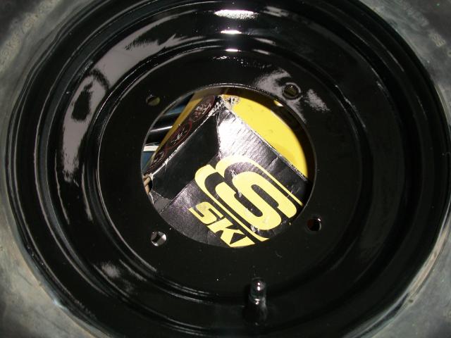

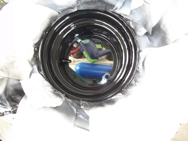

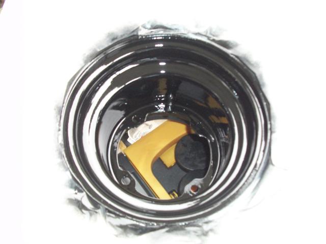

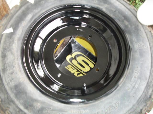

    here is some pictures of my work.
    [​IMG]
    [​IMG]
    [​IMG]
    [​IMG]
    [​IMG]
    [​IMG]
    here is what I do.
    I like to use a wire brush on the end of drill. I get in there and just grind the heck out of it.
    Then I use some 100 and 150 grit sand paper.
    I use like 1 sheet per wheel.
    the I use 220 and 320 grit.
    I wipe the wheel off alot, get the dirt off ad old paint m inside alot, so Im just not tearing up my sand paper or leaving more scratchs.
    I then put 3 to 4 coats of primer on, I put it on a little thick. I use about 1/4 of can ofpaint to start off with. t do the 3 to 4 coats. wait 10 to 15 minutes between coats. or you just gonna get runs.
    I then let it dry 4 to 6 hours, maybe 8 dependson the weather. I ten wet sand wit 400 grit, often it clogs up a bit and watch the sandpaper, dipping and rinsing in water allot and checking for clogs. replace if it looks clogged.
    it will stractch the heck out of the surface.
    then if I ended up sanding thru the sand paper. I re-primer. repeat the sandng process.
    once dry and clean. I then start to paint wth the pant I hae picked out.
    I like to do light coats. I do a light coat on all the areas, tha are angled or look harder to cover. this often is where it tends to run at ad harder to cover those spots.
    I liketo put on 5 to 7 coats.
    Then I let dry, about the same amount of time and wet sand it. 400 grit / 600 grit/ 800 grit.
    the finer you go, the better. if I sad thru. I repaint and re peat.
    then I do my gloss coat !
    I do 5 to 6 light coats.
    I do not always wet sand, it depends how much time I want to put into it and what it looks like. Over the years. I have gotten a feel for wat will show and what I a get away with.
    NOTE: The better condition the rim is in, the less paint you will need and the less work you need to do. I had some ruff rims, thatI painted black and had been painted like 3 times before me. and the prior paint jobs were done poorly and with cheap paint.
    Sporty

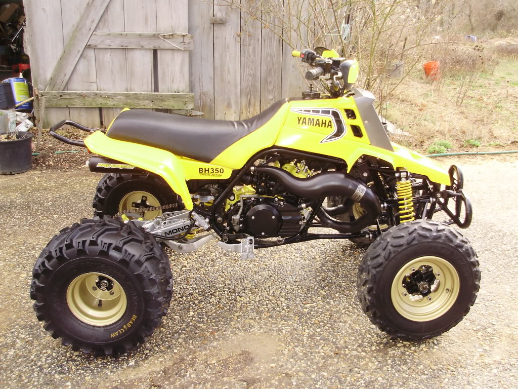

    Painted rims are gonna get F'ed up thats life. Even powder coated ones will get chips. If you want the best finish for that color you have to have on your rims then get them anodised.
    FWIW here's mine a couple years later
    [​IMG]
