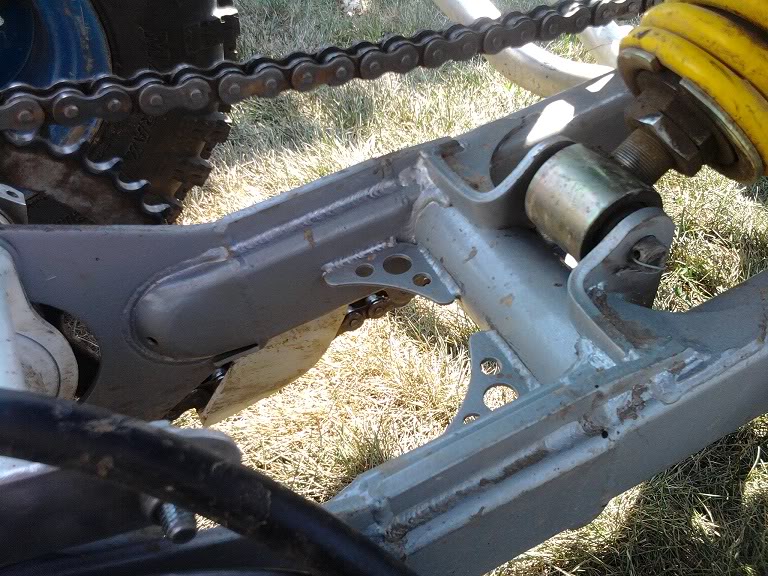

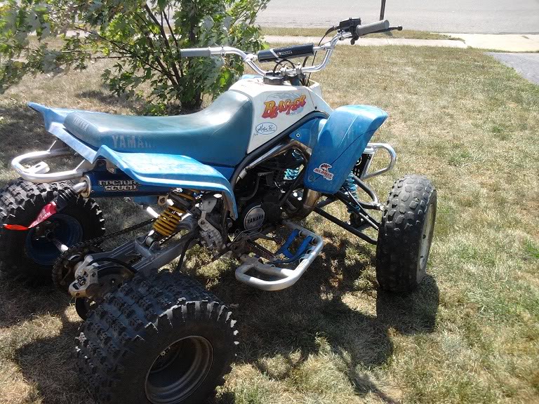

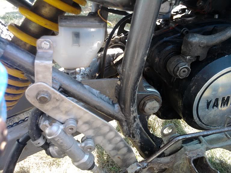

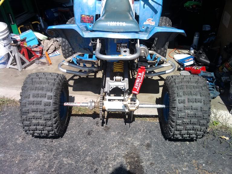

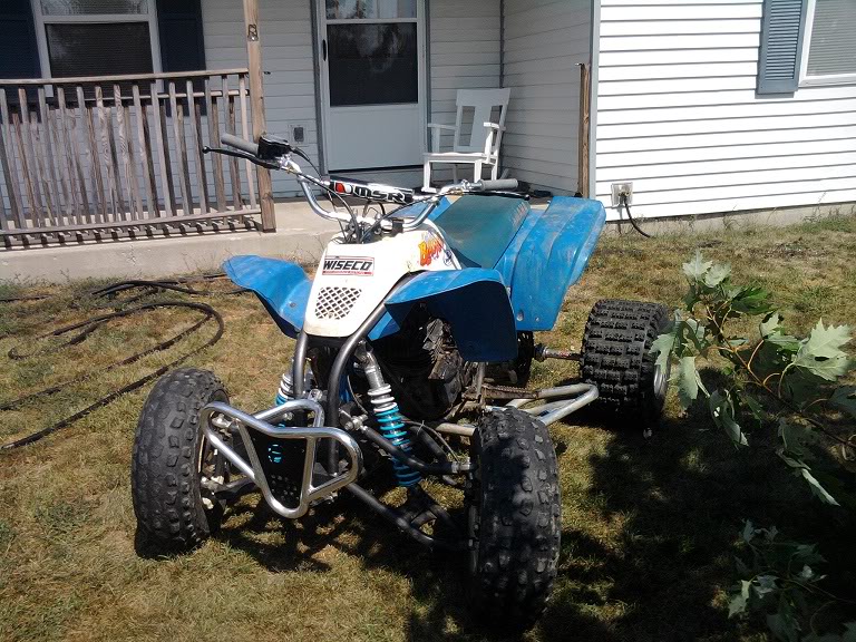

i guess i'll give this another go
A Arms: asr +3+1
Swingarm: custom extended +3, very cleanly done
Steering Stem: stock, custom extended +1.5"
Stabilizer: my arms
Axle: g force adjustable
Carrier: stock/all balls bearings
Locknut: g force
Hubs F|R: stock/stock
Bars: msr atv bend
Throttle/Clutch Lever: stock levers, rm clutch perch on both sides to clean up the look
Grips: fly racing
Nerfs: dg alloy/blue nets
Bumper: tusk comp series
Grab Bar: dg alloy
Front Shocks: works dual rates
Rear Shock: stock for now
Brake Lines: gsxr rear, stock cable fronts
Rotors F|R: stock/stock
Rims F|R: stock/stock painted
Tires F|R: 21/7/10 fronts/ 18/10/8 artrax mxtr rears
Body:
Frame: gussetted 1990. painted graphite
Plastic: stock cut
Graphics|Seat Cover: stock, a few stickers to make it go faster
Number Backgrounds: n/a
Handguards: dont need em right now
Bar Pad: msr
Fuel Tank: stock
Engine|Drive System:
Cylinder|Head: stock
Bore & Stroke: stock
Displacement: stock
Cam: n/a
Carburetor: stock
Air Filter|Box: uni filter, no lid
Pipe|Silencer: factory 7 header/f7 silencer pc'd blue
Clutch|Plates: tusk
Gearing F|R: 14/40
CDI|Killswitch: tether kill switch, stock cdi
Cooling: fins
Other: You will find no monster stickers anywhere near this quad.... Or Redbull or wtf ever. the frame was gussetted, steering stem extended, some other custom fab work that i cant remember right off hand. motor has hot rods crank in it, stock length. everything has been completely redone on this quad

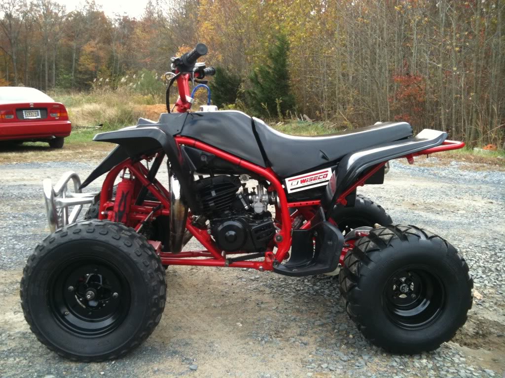

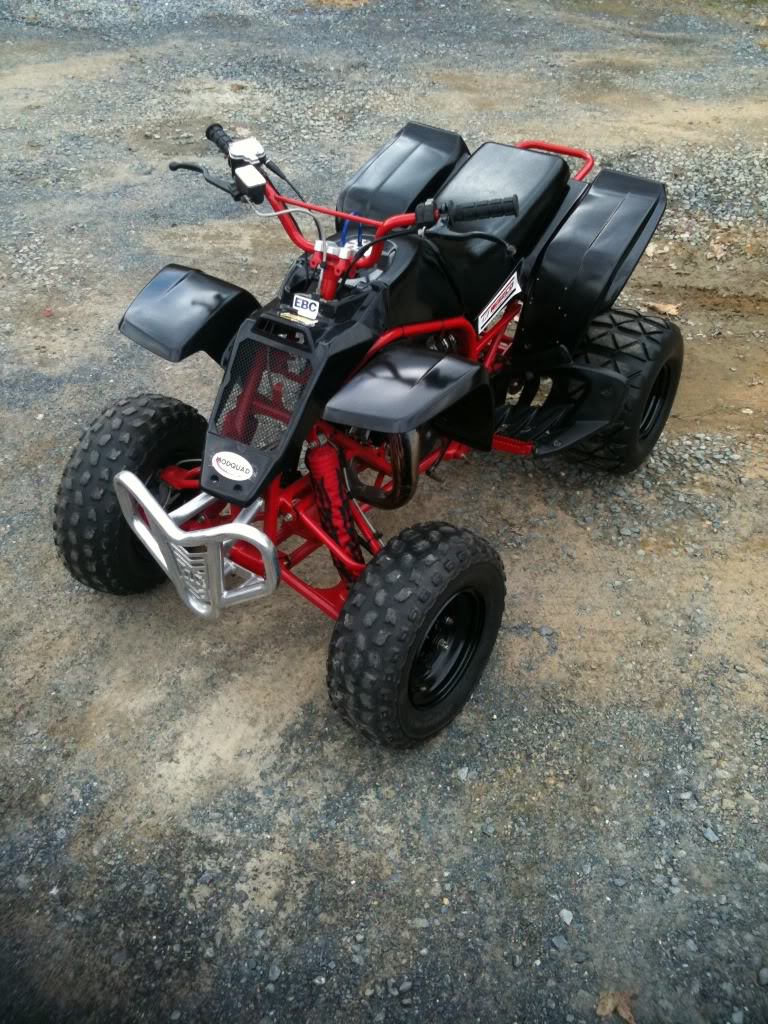

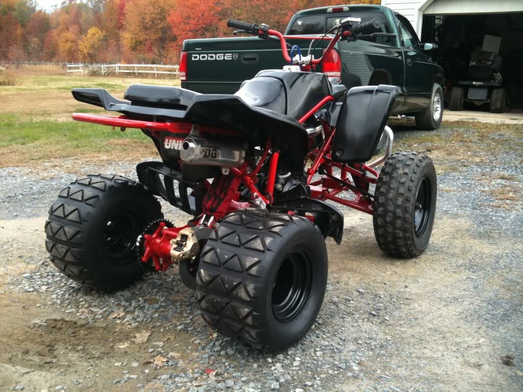

1. A Arms: asr +_3 +1 long travel
2. Swingarm:+ 4 chrome swingarm shop
3. Steering Stem:stock
4. Stabilizer:none
5. Axle: durablue +4
6. Carrier: rad billet
7. Locknut:rad
8. Hubs F|R:banshee front, billet lonestar banshee hubs rear
9. Bars:renthal
10. Throttle/Clutch Lever:stock/asv
11. Gripsury
12. Nerfs:a/c racing WITH GYTR ALUMINUM YFZ 450 HEEL GUARDS
13. Bumper:a/c racing
14. Grab Bar:rath
15. Front Shocks:06 yfz 450 polished
16. Rear Shock:06 yfz 450 polished
17. Brake Lines:speedlinez
18. Rotors F|R:stock banshee front rad wave rotor rear
19. Rims F|R:itp
20. Tires F|R:holeshot gncc
Body:
1. Frame:05 custom painted
2. Plastic:MAIER YFZ RACE CUT FRONT WITH YFZ STYLE REAR FENDER IN CARBON FIBER WHITE
3. Graphics|Seat Cover: none / n style gripper
4. Number Backgrounds: none
5. Handguards:none
6. Bar Pad:renthal
7. Fuel Tank:stock
1. Cylinder|Head:stock floteck aggg trail port
2. Bore & Stroke:67.50 stock stroke
3. Displacement:not big enough
4. Cam:ahahahaha
5. Carburetor:OKO 30
6. Air Filter|Box: factory 7 aluminum air box
7. Pipe|Silencer:factory 7
8. Clutch|Plates:billet hinson basket with driveline products hd clutch
9. Gearing F|R:stock
10. CDI|Killswitch:stock/ abba
11. Cooling:
12. Other: tons of polishing and painting done. a 3 mm stroked la sleeve 240 is going together and will be in soon
