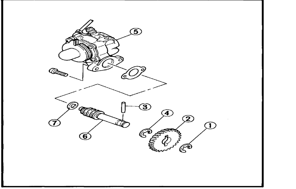

today i went to do the oil block off and i removed the pump cover then removed pump and then the clutch cover. i pulled the top c clip and the plastic gear off the pump. reinstalled the pump as the plate. i sealed up the holes in cover plug, the two pump ports and the carb port. put it all back together. i completely drained every drop of fuel out of the blasty including the carb bowl. then waited about 6 hours for my rtv that i used to seal ports to dry. so i mixed up some 32:1 with 93 pump gas and i started it up and warmed it. then all of a sudden it was was just like clunk clunk clunk clunk and it shut off. now it does not start anymore and when i turn the kickstart it makes a terrible clunking sound. almost like out of the head area??? If anyone has some advice for me id realy appreciate it. before i just start tearing things apart... thanks guys

Did you remove the shaft, labeled #6. The PO of my blaster left it in to block off the opening and without the gear on it the shaft flops around.
I had a similar noise from that.
i didnt. i only removed 1, 2, and 3. i left 4, 5 ,6 ,7. could be making noise but do you think it was cause it to stop running and continue making it with it off and just being kickstarted with no engagement from any drive?

Did you seal the oil injection port on the carb?
honestly dude all u need to put back in to block off the oil inject is 6, 4 and 1. i usually just put a washer in between 4 and 1 but u dont even have to do that.
