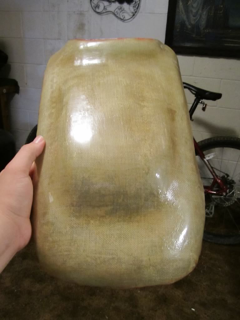

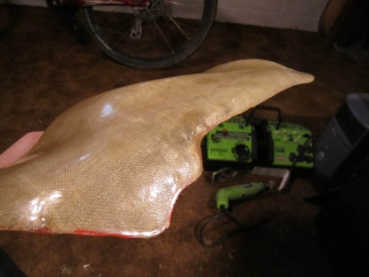

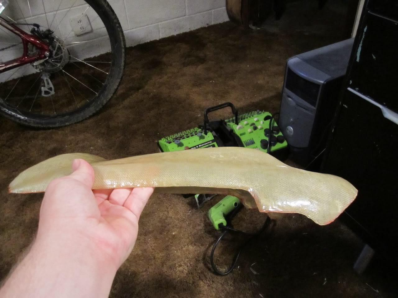

my hood build.
What do you use for release agent from mold? What did you make mold out of? Looks good tho. Nice thing about glass is ability to paint any color easily.
I never seen this post,
the mold was made with plaster I got from home depot.....
and we actually did not use any type of release agent... we just painted the mold with a thick layer of latex paint. so when we pulled the hood off it just pulled the paint off with it... worked great
If you do need a cheap release agent, I use dawn dish soap thinned out with 99% alcohol from work(the regular % will work just as well)
I am gonna tackle a hood this winter, I got a vac bag in the closet so I might try some carbon fiber. Gonna use fiberglass first though just to save money on mess ups.
It all depends, I do Special effects as a hobby and use a 50/50 for silicone molds, but for fiberglass I would just use a splash of it. So around 10:1 dawn to alcohol

I put a layer of bondo auto body filler over it and polished it today, im gonna use dish soap and alcohol as a release agent like said above.
well, I destroyed all the work I did on the mold..... that thing was STUCK on there..
so back to the drawing board for the mold lol, gonna trim the hood and sand it down tomorrow..
