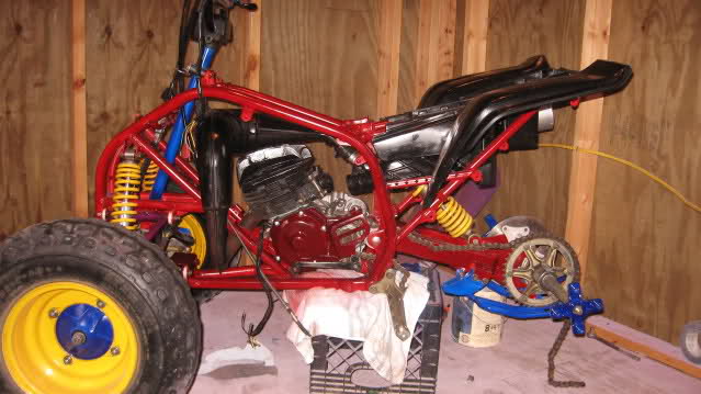

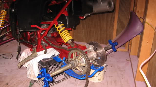

My blaster rebuild updates
For now until i get some spending money,i got alot of bills right now..
Cant say when but i will be getting
itp rim front and rear
Works shocks
new front tires
port job
bigger carb
shearer exhaust
extended swinger and a-arms
and longer axle
Yb can hook you up with a longer swing arm any size up to +6
You was talking about getting your flywheel off. If you have access to a "tap ad dye" you can thread the two holes in the flywheel then screw botls in them. This will help you hold te flywheel while you unscrew the nut. The you can hook just a regular gear puller to the bolts to pull the flywheel off.

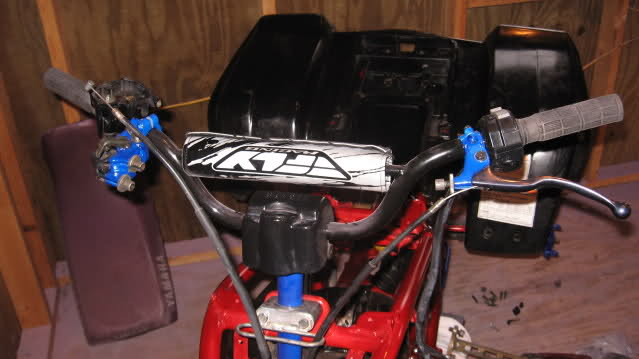

I like the blue and red...
Other than that idk i would have done some stuff differently but thats just me.
For starters, i would ditch those banana wheels and paint em black or silver for the time being.
No thanks,waste of time to paint them,
i dont throw up when i see them so im fine
Now if you do thats your problem.
Edit
but thanks man,i love the blue and red also!
No offense taking but you understand right?
No need to waste my time on those sh*tty rims
ill buy new ones after i get out the debt hole im in.

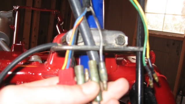

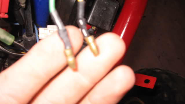

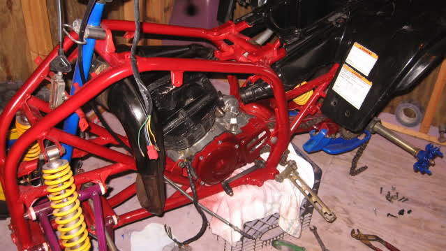

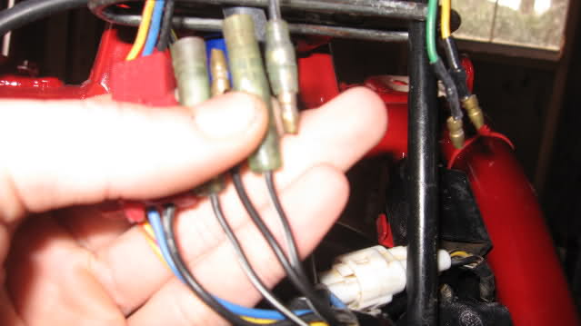

How do these wires go together
My blaster came without a headlight and its a 96
Pictures below
Green and yellow=?
"Black wire with white stripe" and the red plug coming from the kill swith and headlight on the bars,Along with the green and yellow from a different strand..
Then i have the red plug coming from the harness together,and also coming from the harness i have "2" Black wires with white stripes and a SOLID black wire..
Then i have this strand coming from the harness and it has a green chopped wire,brown wire?,and a solid black..
How do they go! im stumped
