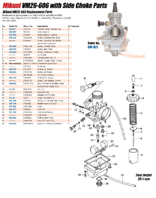

Here ya go, This is not your carb but it's close they are all in the same place!
number 29

Re assemble and check the float level, 20.0 to 21.5mm on a stock carb.
Img courtesy Awk08
