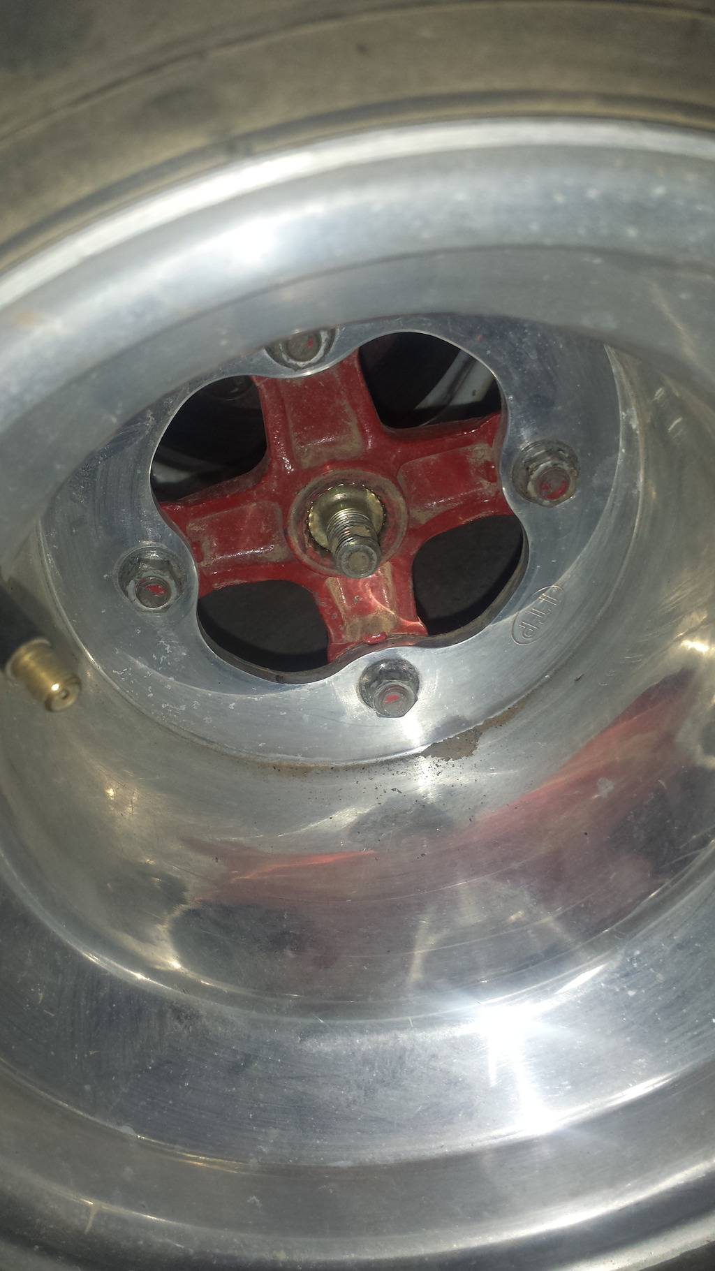

So this happened...
Not sure how the wheel didn't just fall off while out on the trail??? lucky I guess lol. Apparently the cotter pin broke, and the castle nut worked its way off. Good thing Fast6hand has me covered!
