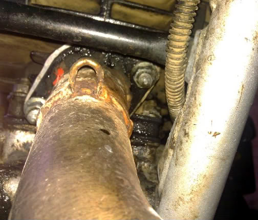

yo idk wtf id up with FMF i just got the flange in and heres what it looks like. theres NO loop on the FMF flange neither. had i known that i wouldntve bought it! i called FMF and told them wtf! they said that the spring hooks in the bolt hole. i said NO bc its gonna leave a gap between the motor and the flange and plus the loop on the header doesnt line up to the bolt which will make it SIDE WAYS. he said i can drill a hole i said are u serious?!? what kinda company are u ppl??
Hey man, I'd post a pic if I had one of the FMF flange. Unfortunately, I sold my 2002 Blaster which had the FMF pipe installed. HOWEVER, here's what you do: You can indeed make the spring work without drilling or cutting on anything. None of the FMF flanges I have ever seen come with spring holes. Since you now have two flanges, throw one up here in the 'For Sale' section. People are always needing FMF pipe flanges, and you'll be surprised how fast it will sell.
Instead, you hook the spring from the loop on the pipe to the casting on the cylinder jug. If you look carefully above the exhaust port on your cylinder jug, you will see a metal strip running up the center of the jug. There is room behind this strip to hook your pipe spring. Hook it there; then use a spring puller or a pair of locking pliers to stretch the spring over to the loop on the pipe. Release it, and its a done deal. This method has always worked well for me. If the spring is too short, order a universal one from Bikebandit or elsewhere. Just be sure to measure the distance between the head and anchor on the pipe, and remember that exhaust springs don't stretch more than a few mm without requiring extreme effort. You'll need a spring a few mm shorter than the distance between engine casting and mounting loop.
Hope this helps! :D
i didnt see a hole in the jug when i had the pipe off but i'll give it a shot again. i started drilling a tiny hole in the flange and the steel is too hard and wont go any further than half way down. FML i wasted $ once again on another useless item just throw it in the blasters part box....
