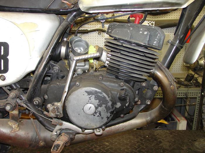

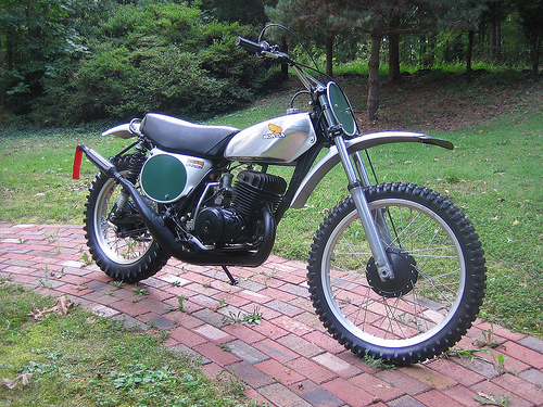

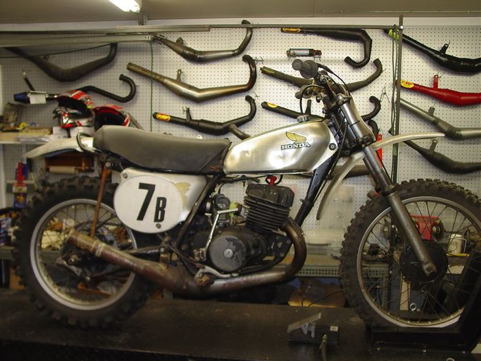

I had a 1974 Elsinore 250 this is not it, but pictures of what we are talking about:
This guy has an excellent restoration page on ths year bike:
CR250M (1974) | 32:1
Here are the highlights:
There were a piston port engine that I recall, NO reed valves, no low end torque:

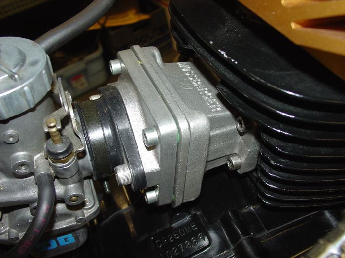

Here you can see where he has added reed valves:
