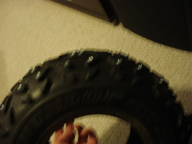

Alright decided to try it, but yet to test it but i have no doubts at all.
First thing your going to need is a set of tires, they can be new or used.
i used a set that are actully 20 years old and worn.

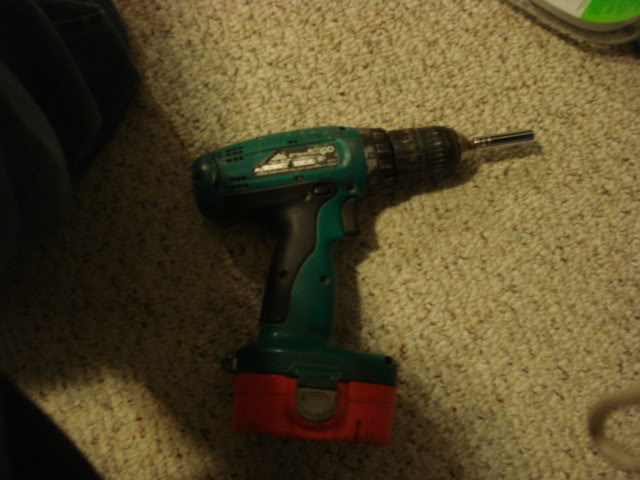

Second thing your going to need is a drill.

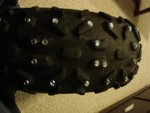

Then get some screws just like this, they have to have the big head on them.
Then you can make up your own pattern to screw them in.
all in total i used 200 screws, 100 in each tire.
hope this helps!

Well up here in Wisconsin we do a lot of Ice riding. You have the basic idea but the wrong studs. You can buy studs made just for this. I have used this for bikes and atvs. They are Goldmax Ice studs. They are similar to the ones in your pic but not. They are deeper and sharper and have a light gold plating to keep them sharper. You try not to go through but if you do, slime works ok. As far as 89customs question, If you plan to drag race, guys use dry wall screws from the inside out with a tube. You need a lot so that they kind of support each other. This takes time because I mean literally a lot. Like 1000 per rear tire. The front is not so important for drag because you go straight. If you river ride these studs are not the best , the goldmax are. Then you want the front studded due to cornering. IF you go into dirt or gravel with any of these, they will dull fast so dont. Snowmobile studs can work, but they tend to add a lot of centrifugal weight and slows you down.

i dont do any drag racing myself just trail ripping and in the winter it doesnt turn good haha. i had these old tires so i thought i might as well try it.
Hey well tested them out they work great about a 75% improvement

At $5 per 100, you just buy the gold max for $60 for 1000 and they are meant for studding your tires. You have to have common sense doing this. Look at your tires knob size, shorter knob shorter screw. I have turf tamers with about 300 per tire, rode twice, never lost a screw. I used the 7/16 length and screwed them in flush. I am not easy on them either. I also had a 400ex and a 250ex. Maybe through the season, lost a couple handfulls between the two of them. You have to stay off of rocks and pavment or they will dull. Ill take some pictures of mine, just studded up my holeshots, wanted 18inch tires to stay lower because Im hanging so hard around the corners.
im running about 250-260 #10 hex head sheet metal screws 3/4 lenght... works great will wheelie in 1-2-3 gears with my 250 pounds on a blasterand will still hand sideways around corners with the best of them!... got my screws at menards.. box of 100 for $1.90
