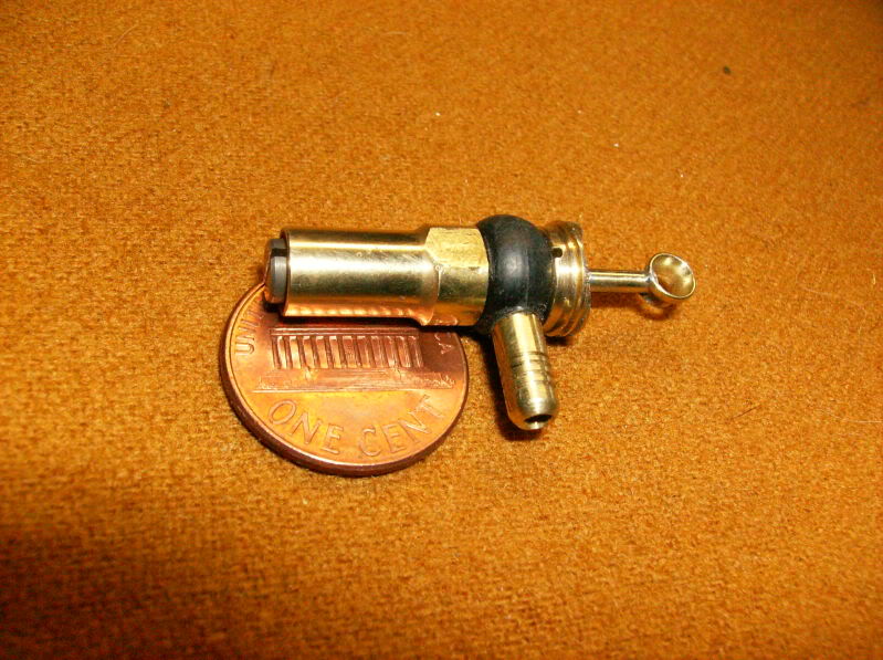

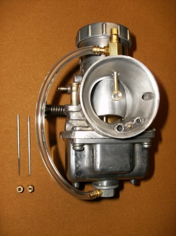

I think a Blaster can be safe with just the proper needle & jets for the build. Dirty petcock screens, filters & jets are often the culprit. A power jet can give you some adjustability. I don't think the mikuni kit is adjustable. Get one with a needle valve so you can tune it. Then you can adjust for altitude changes also. Here's a pic of one I made for a LT80 we run on alky.

No way man, did you actually make that?I:I
Nice work!! What did you use for the venturi? Looks like a compression ferrel. I remember when the Dial a Jet came out how popular they were with the GS1150's and Ninjas

you should do a DIY on this.I:I

You won't hurt anything by installing a power valve unless you don't understand plug chop.. Just be ready to spend some time getting it dialed in. Cheaper ones have coarser threads so they are a little harder to tune. Jet to low/mid, then tune the top with the power valve. It's not a big deal & it's nice to be able to fine tune the top without taking things apart.
Here's a $20 ebay power valve kit on a 38 mikuni for our alky CR250. I added the venturi.
