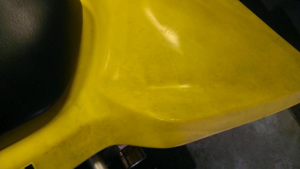

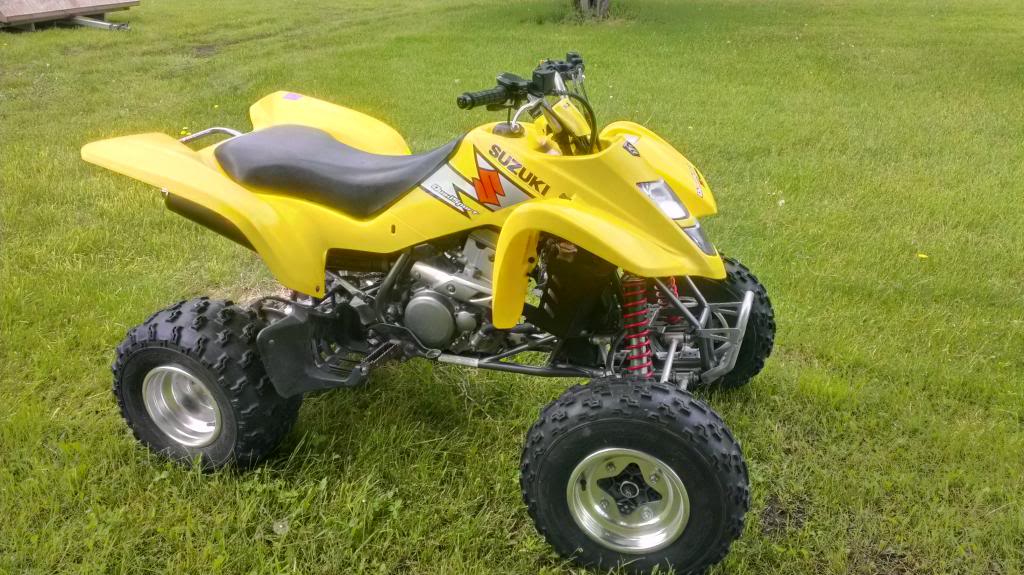

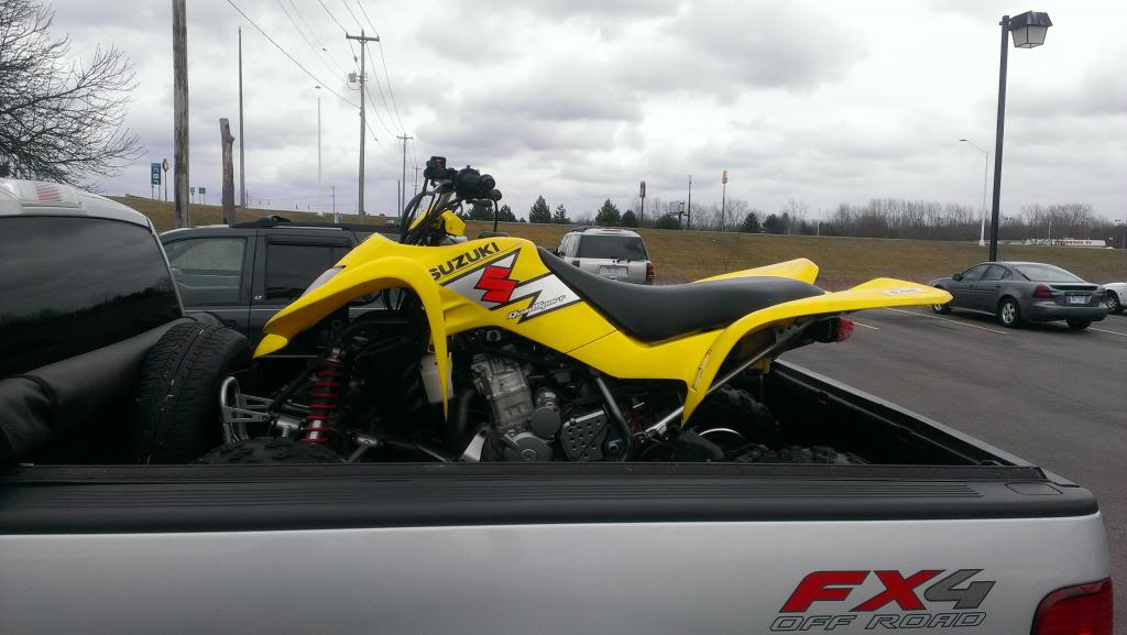

Yep I got it, ended up getting the yellow one. The white one had two huge baseball size gouge marks that were very deep on the rear fenders on either side of the seat from c clamping a tree blind to it. I got him down to $1900 because of a bad battery in it and a few other things that need fixing. The tail-light was busted, easy $45 fix. The choke (cable with lever on bars) doesn't work, and the parking brake doesn't work(might remove it). The plastics are pretty bad, they're discolored and it doesn't just wash off, I got an electric sander with scotch brite, and it worked well. It's still in pieces in my garage from looking over everything, but good purchase overall.
Guess I should give everyone an update. It was a biotch to fix up the plastics. Eventually ended up sanding them down with red and gray scotch brite, then buffed them with Turtle Wax rubbing compound, then finished it up with some wax. Shiny, looks better than new. Not much else was wrong with it, a few bolts missing, the taillight was busted, it needed a new battery, and then just some basic maintenance (oil, coolant, etc.). This quad is so much more cofmortable and fun than the Blaster was, I have no clue how you big guys can stick with a Blaster. Planning to do some upgrades over the winter like better shocks, new tires, and possibly a new exhaust.
