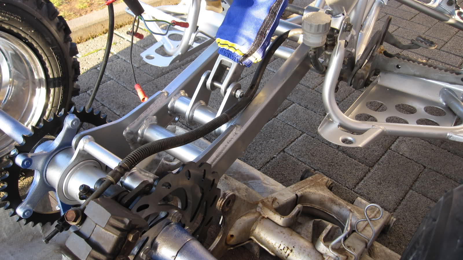

here is a pic...
sorry for thge size of the pic ....the stock swingarm is on the pic too...i was thinking the same thing ,cause i read a lot here in forum that you need a longer line but when i putted it together to messure the lenght it just fitted ....
the bolts on both ends of the line on the stock swingarm was mounted to the side i turned them towords eachother and i hade some more playroom
that looks like it is possibly a banshee brake system, as the pedal looks banshee to me, what year is it ??? which also would explain the line being long enough.

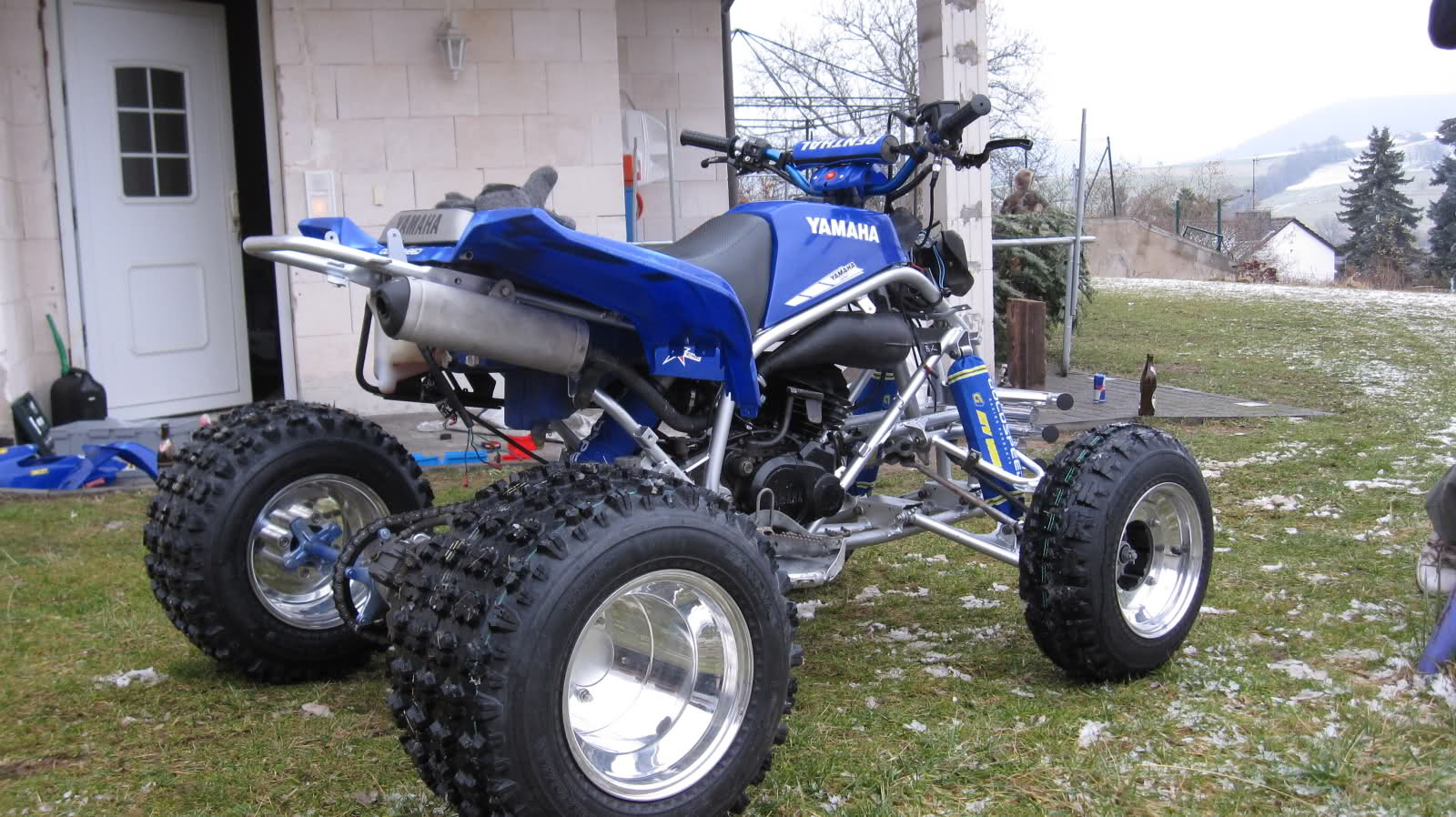

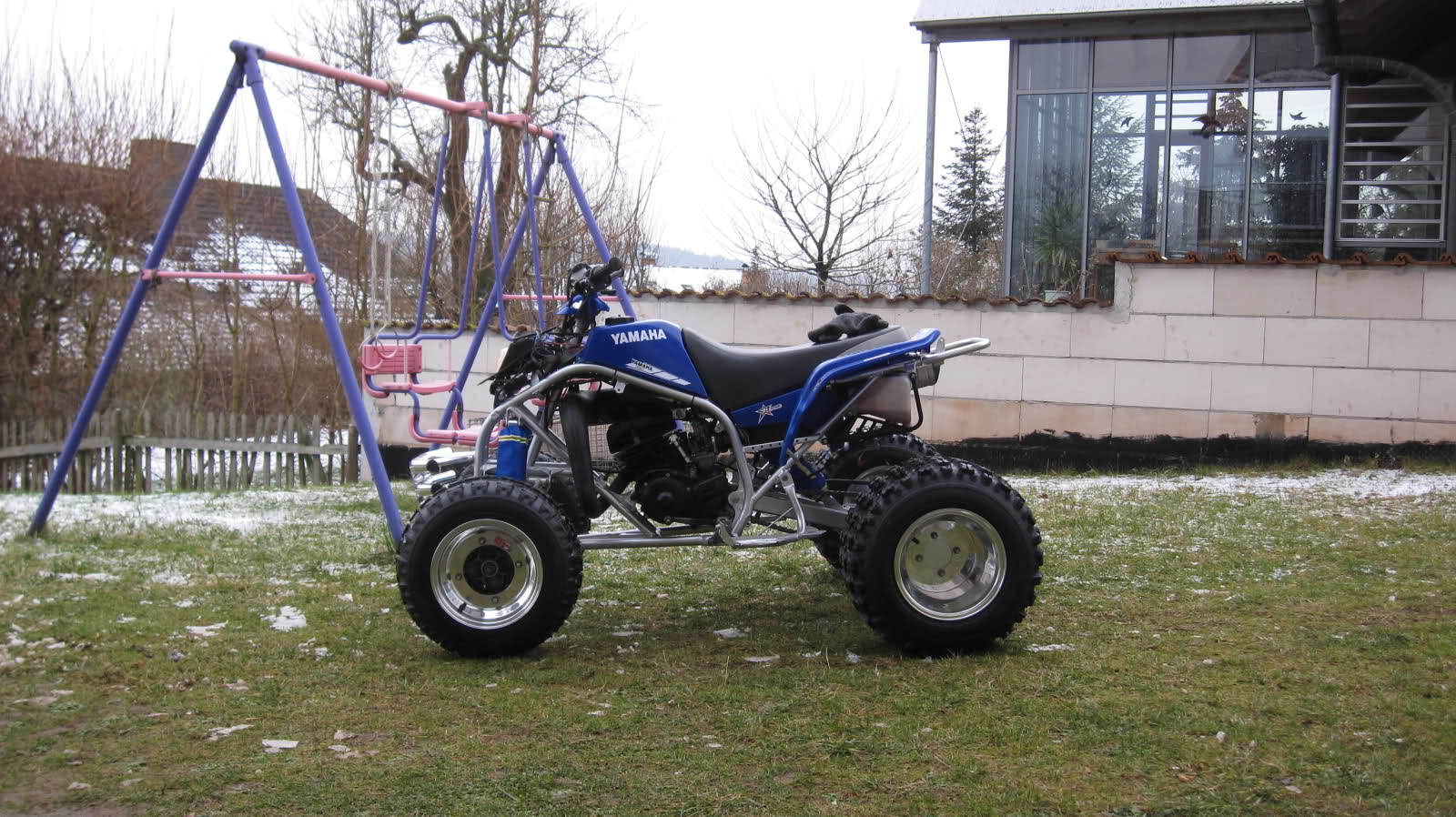

sure ,im from germany ....its a 2003 ...i took it appart and painted renewed some stuff trhats why its looks so clean ,i will be putting the engine back in tommorow i make some more pics of it all as long as its still clean ...cant wait to make a test ride whith the new stuff on it
thanks but my old ones fitted ...i made a rtest ride today and i love the new swingarm ..here are some pics i made today ..
im still not don yet..
lookin good bro !!!!
and holy deep dish rear rims !!!!!!!
