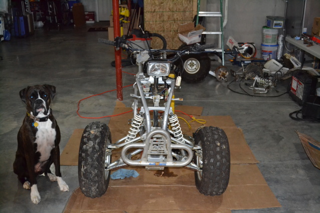

Props for armyboyjared. He has a left fender he is sending me. Headed to my buddy's shop Thursday to get my Banshee hubs, 05 axle carrier, Banshee axle & stem to prep for paint. Stripped everything from the frame and taking it to a sandblasting shop to strip it and prep it for paint tomorrow. Will post pics after I have everything ready for primer. A big thanks to all who have been helping and support.

And here are the pictures
Great looking Boxer I have one myself. Great dogs! Bike is looking great also
