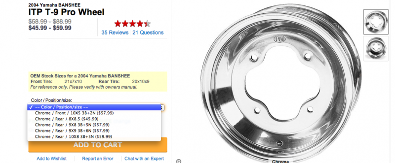

I am looking to get some new rims for my blaster 9" to give me more options with tires. The stock rims do not have many options. I figured if I had to change the hubs anyways I would see if anyone had a whole setup and widen the rear at the same time. If not if anyone has a deal on some hubs let me know.

9x9 means a 9" rim and its 9' wide. a 9x8 means a 9" rim and only 8"wide, a 9x10 is a 9" rim and 10" wide.. The other numbers are the offset.. A rim of 9" in width with no offset would mean that the bolt holes for the hub are in the center of the rim 4.5" each side, a 9" rim with a 6+3 means the outer of the rim is 6" while the inner hub side of the rim is only 3" this will actually widen it a bit , actually just found an easier way to describe it here ya go..
http://cocomponents.com/dealer/blog/wheel-offset-explained/
Also with banshee rear hubs beware of the 4/156 rear hub.. they r from a 89-90 Banshee.. Nothing wrong with them just harder to find rear rims to fit..
