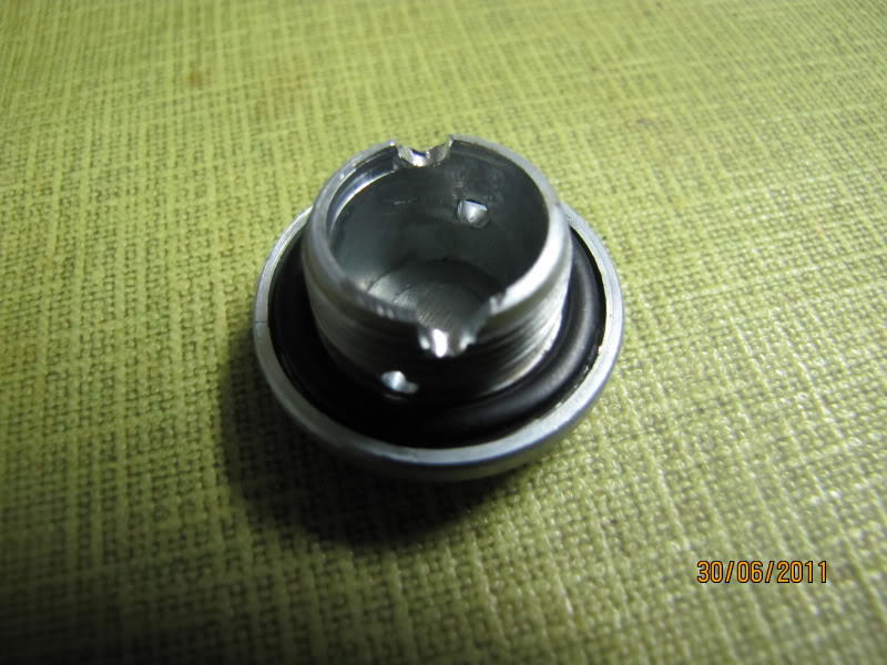

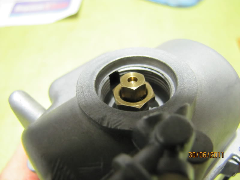

this is what I did...
to line up with this
I was able to get my holes to line up properly so I didnt have to worry about that. Well, Im going back out there to mess with it some more. Hopefully I can get it somewhat sorted.
