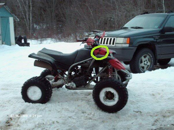

Anybody have an aftermarket kill switch that attaches to your wrist? I think jet skis use this type of kill switch or drag bikes possibly too?
Anyway, thinking it may be a good idea to install one on my blaster as a, just in case, precaution, plus I'm pretty sure if i race it (drag and MX) I will need one like this.
Also, if anyone has pictures of where they have it installed, that would be great.
really useful bit of kit
luckily ive not had to use it from being off the bike but because ive eliminated the use of a key i use that to switch my bike off instead of stalling the engine
i have one on mine and i just spliced into the black/white ignition wire and grounded the other wire. works great. i installed it like right by my key switch. and ive even used it a couple times unfortunitally:(
look at full size pic. its easier to see
