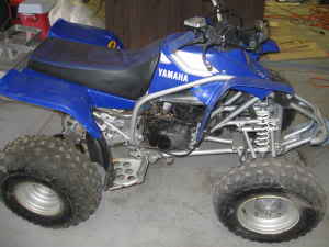

i might get a 2000 blaster with 240 kit vforce reeds and pipe/silencer. the guy wants 1200 and it dont run cause it needs the carb cleaned. what are things i need to look out for before i buy it? i got a spare carb, should i clean it and take it with me to swap it and see if thats the problem?
first of all take a look at the exhaust if it aint aftermarket then the 240 kit on their is gonna suck. the bike i bought had a 240 kit and a dg exhaust and had all kinds of problems. maybe check for compression you can rent the tool at autozone if you dont have one

Check compression ! since you can't hear it run i would offer less.
make sure that it is a 240.

yeah i might go tomorrow. i asked him who did the 240 kit and if it runs but he hasnt gotten back to me yet so if he gets back to me ill go look at it and post pictures of. if i get it. what compression should it be at??
take a compression tester most important.i would take ur spare carb but i would put a bigger pilot jet in it just to see if it starts.yea vitos jug is silver but he could have painted it black.find out what kind of 240 it is.chances are if he dont know then it dont have a 240 kit.ask him if its a big bore

well the guy said its a big bore done by a shop near him, and it has a 40mm carb. isnt 40mm huge?
