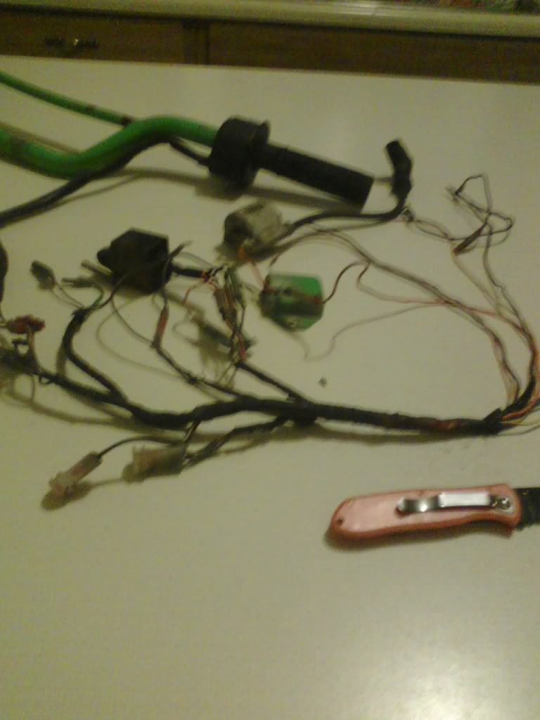

ok i decided i wanted to get rid of all the "junk" on my harness so im gonna teach you how, and remember it can be stripped down farther too.

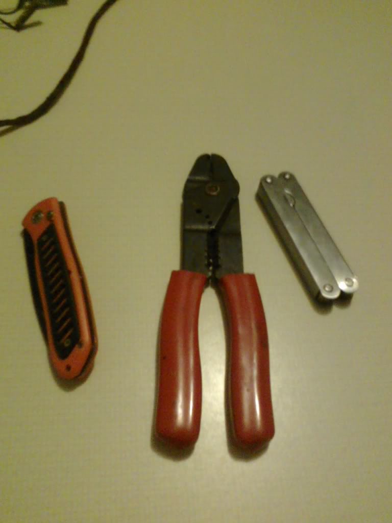

tools a SHARP, i cannot emphasise that enough SHARP knife and or rasor, and a wire stipper. the multi tool wasnot needed

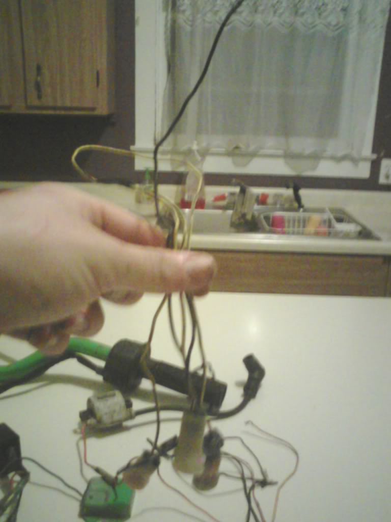

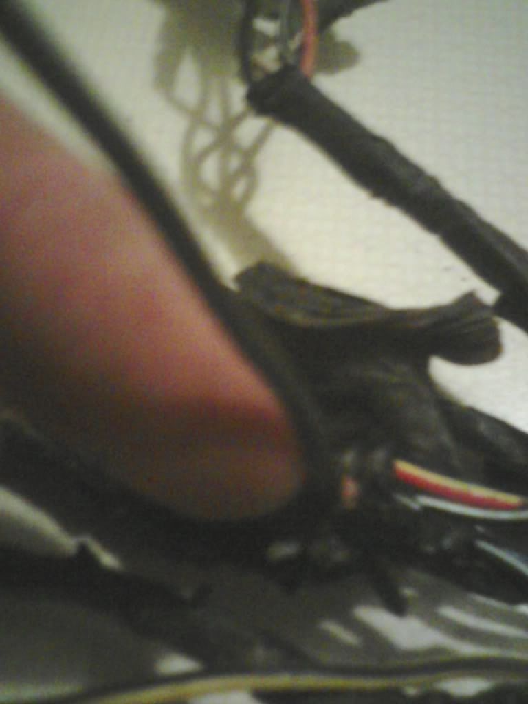

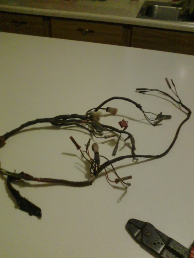

the harness before "slimming"
ok now take your knife and slit the harness tape all the way down the center and split it, be careful not to cut the wiring

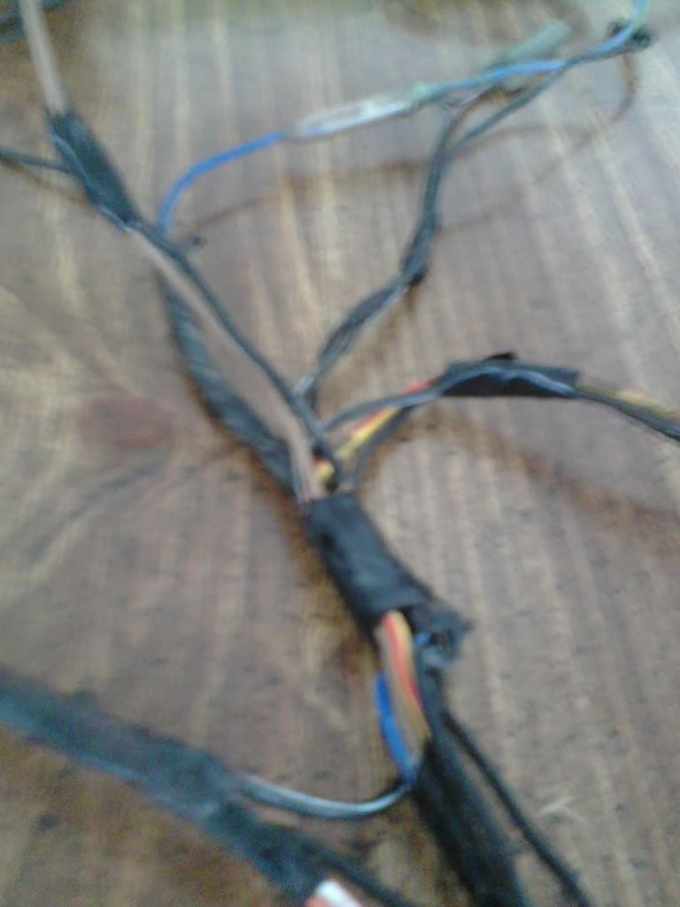

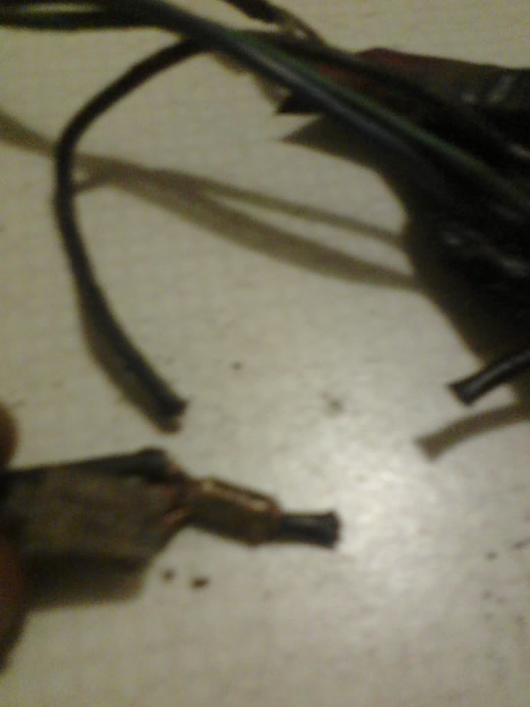

when you get it stripped down you will find quite a few ground pigtales like this

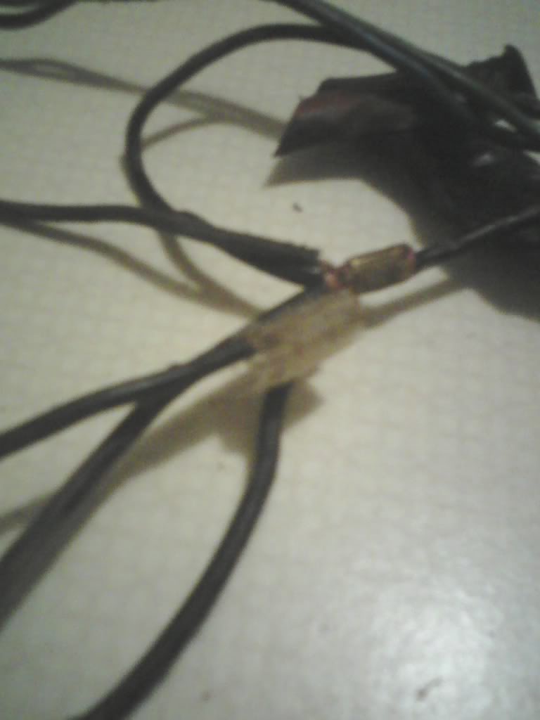

all the black wires ar grounds

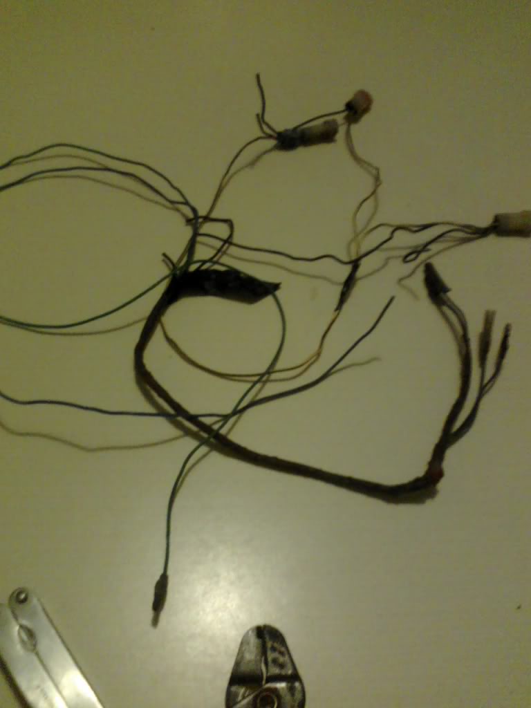

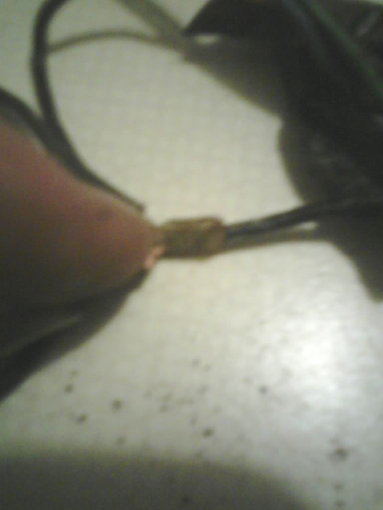

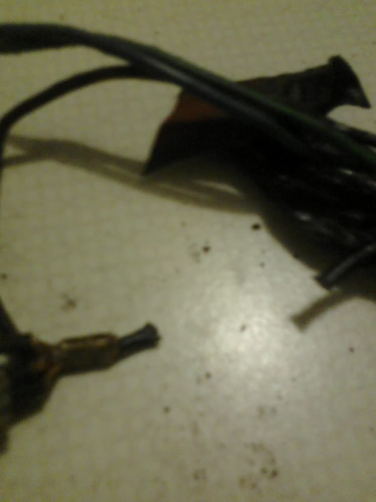

as you see in this pic i trimmed alot of the un neaded grounds off, the ground for the oil pump and the ground for the tail light is what it was
some clipping of the grounds
more clipping
say bubye to that
ground is clipped

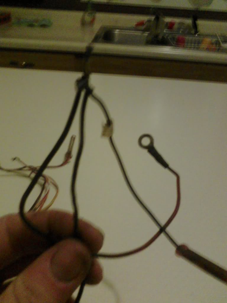

heres whats left of the ground pigtale, as you can see i cut a few wires
heres where were at so far

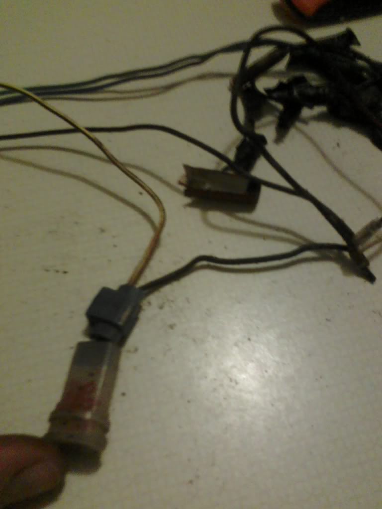

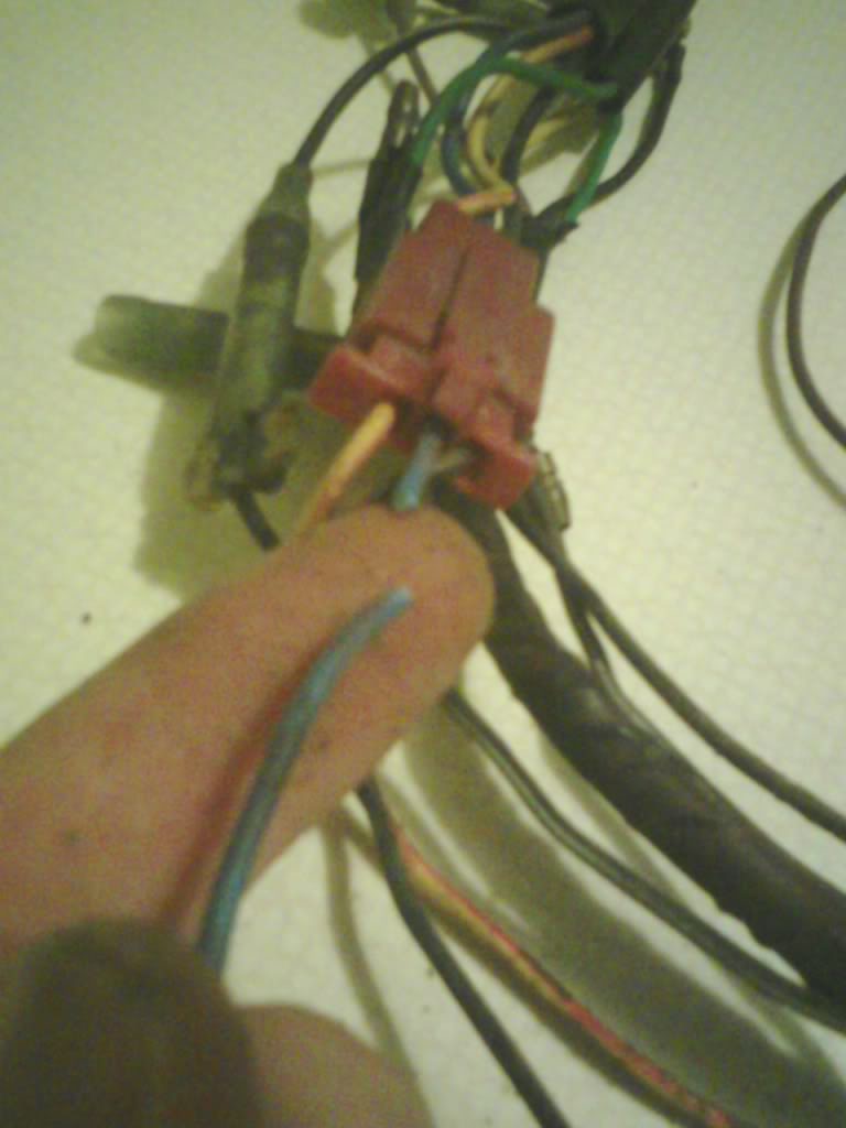

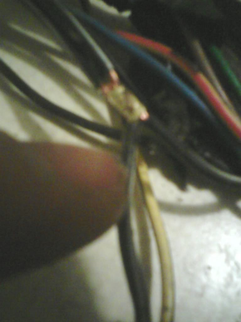

now farther up the harness is another pig tale you wanna cut that wire
now cut this blue wire, no more brake light

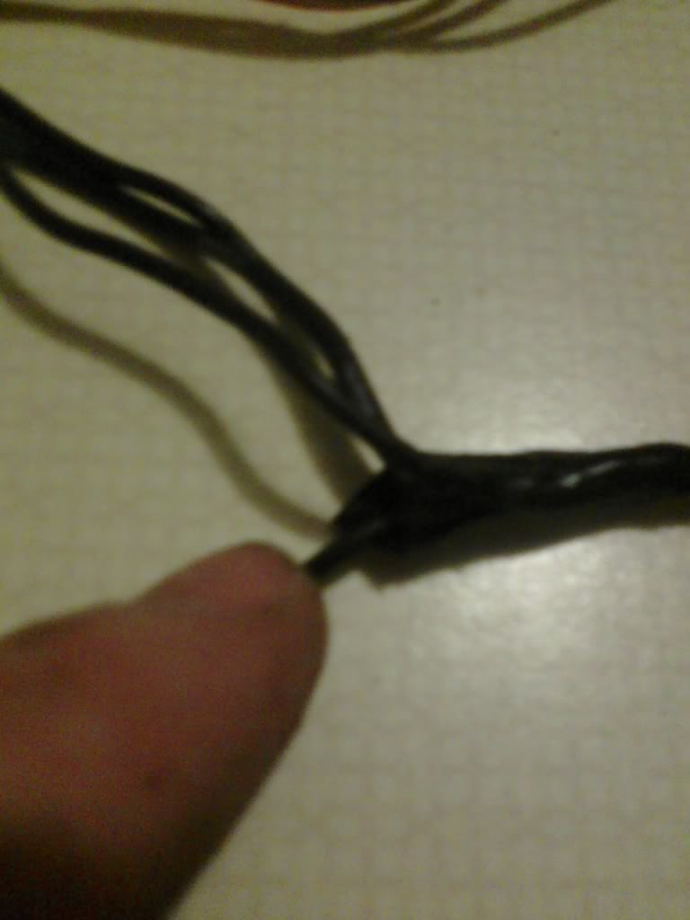

cut
found the end and cut her out

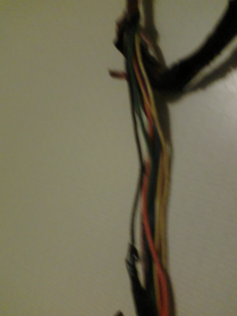

view of the harness
now once you get it all torn down you will wanna rewrap it, and i deleted everything excepth the key, headlight killswitch and stuff for it to run,

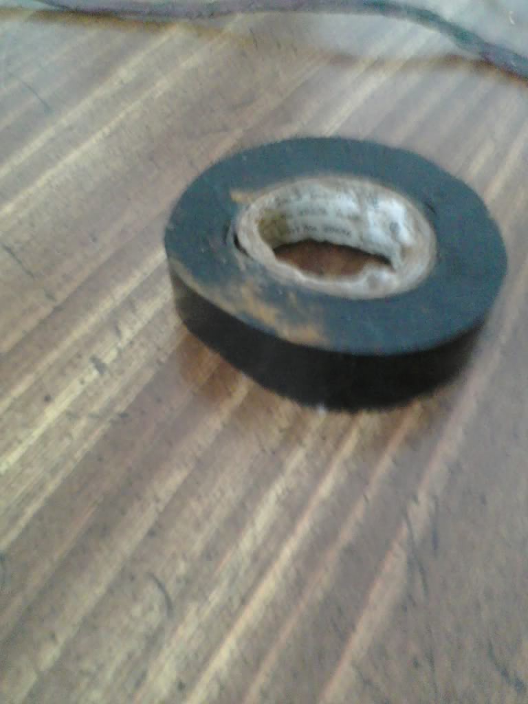

tools, electrical tape color of your choice and a sissors, not picture but yea

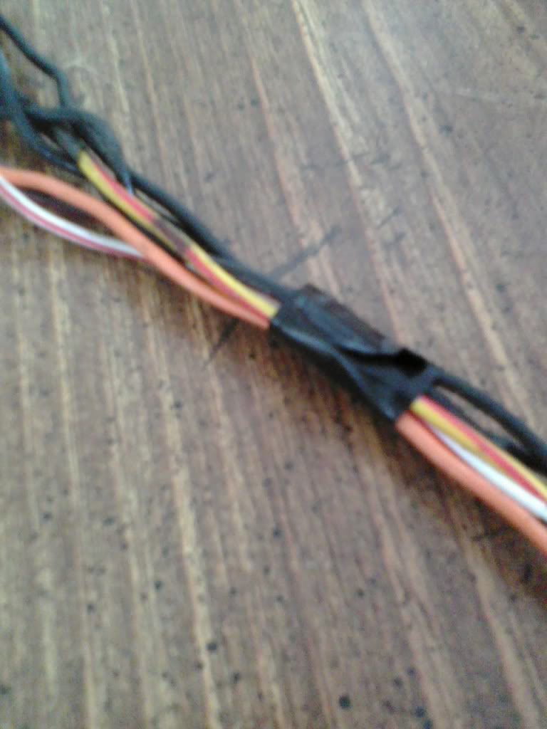

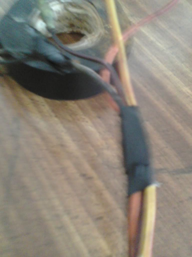

too keep the wiring in groups of where it goes i used little loops of tapes tightly holding the wires together
another example

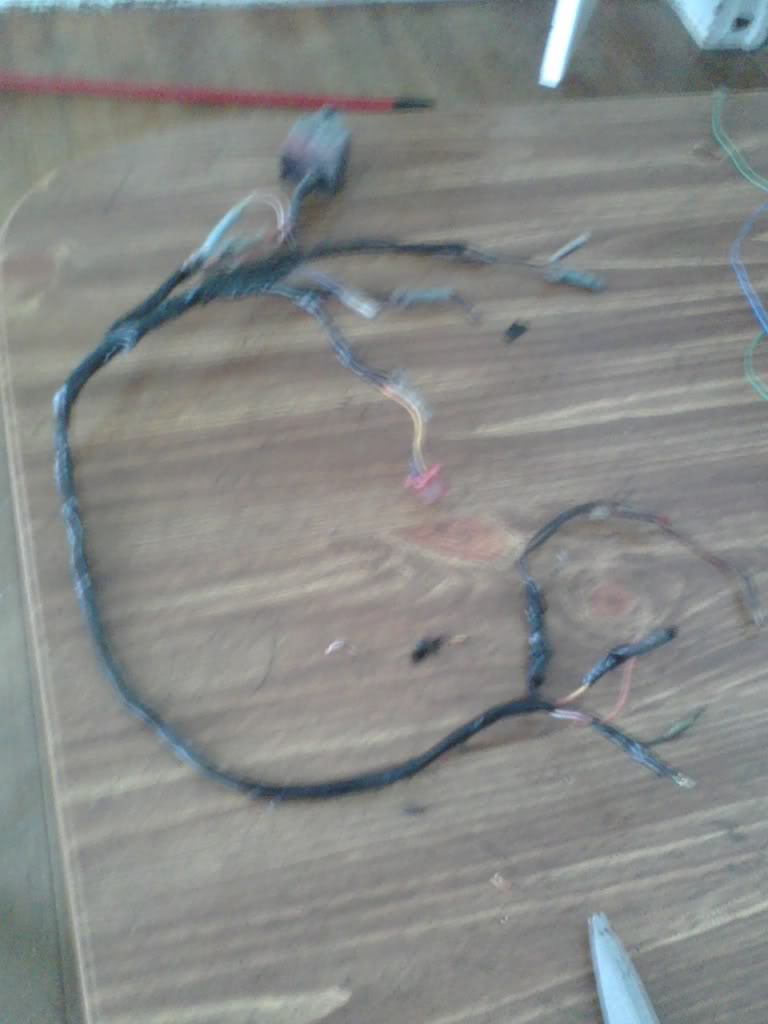

here it is all organized
startyed wrapping, keep it tight, you dont want it sloppy
I did all the "branches" seperate then came back and taped up the parts where they connect
and thats what that same section looks like after i came back and wrapped it, just wrap the sections like you do an ace bandage
