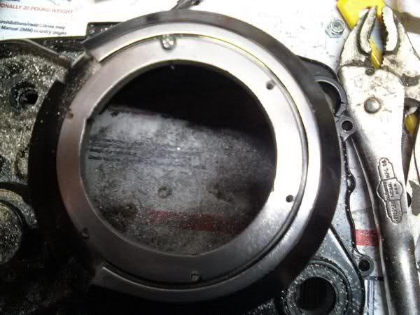

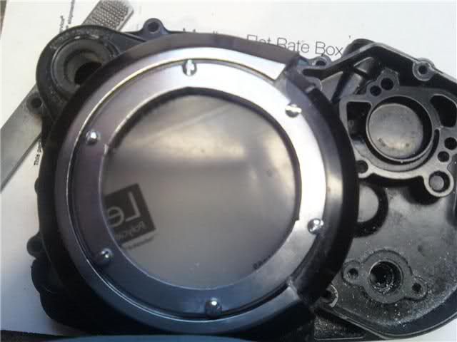

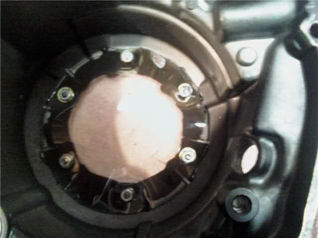

im sure this has been posted but i thought i would post up mine

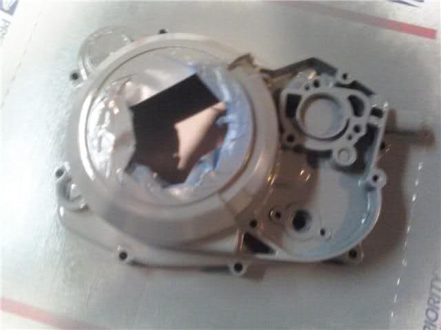

1. take a coffee can or small paint can and center it in the middle of the opening you want to cut out. you can use a compass if you want to be perfect about it make sure you leave enough room for your bolts.
2. Trace around your coffee can with a sharpie
use a dremel or a band saw or whatever you have to cut out the hole(i used a dremel till my bit broke then i just drill a bunch of holes as you can see in the pic)
3. take a file and some sand paper to smooth out the hole, and drill the holes for your bolts.
4. test fit you plexi with the bolt (leave the film on the plexi till final assembly)

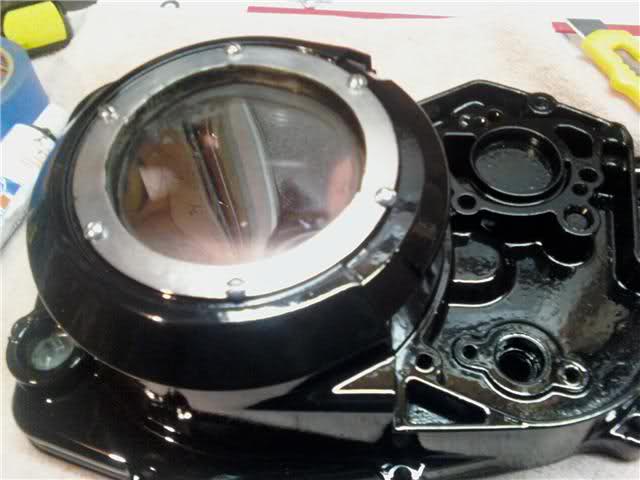

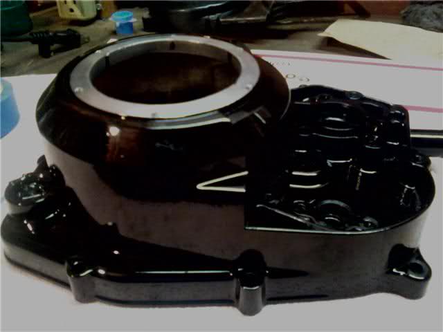

5. take everything apart again and primer and paint

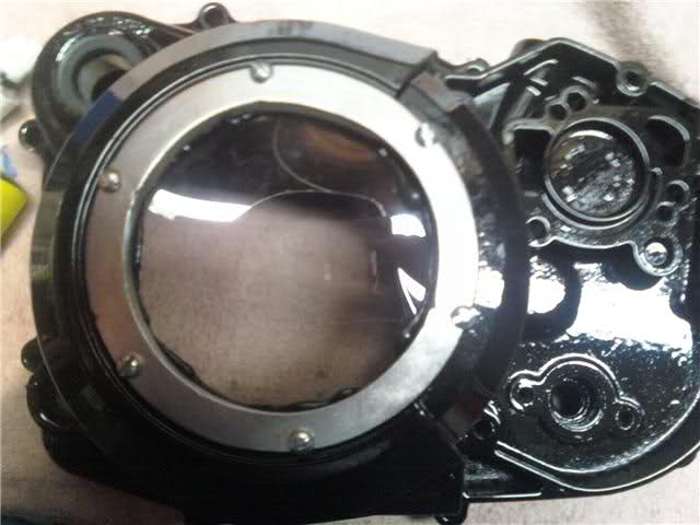

6. put the bolts in and run a bead of sealer on the stator.
7. take the film off the plexi and lay it on the bolt. put the nuts on and tighten (i used loctight on the nuts.)
final product.. I:I

i dont like it. as a matter of fact, i think it looks like ass. the whole you cut isnt even perfectly round. if your goin to put up your custom work, at least make it look good.
wow captain buzz kill... the door is over there ----->
climb, i am pretty sure BF is not the one to come up with this idea. He might be the first to do it on a blaster but he surely is not the first to do a clear clutch cover.
not bad work. the initial cut looks like sh*t but that was covered up. also why not PC it? and is that E-tape on the inside?
not bad work, but take some better pics these suck. also take a pic from the inside facing outward.
That tells me Freek30 was the first to do it on a Blaster, the stuff he creates does not exist in the aftermarket world.
That's why others follow and copy the mod.
i dont like it. as a matter of fact, i think it looks like ass. the hole you cut isnt even nice and round, it just simply looks like sh*t. if your goin to put up your custom work, at least make it look good.
theres the instructions, if you think you can do better...give it a whirl
