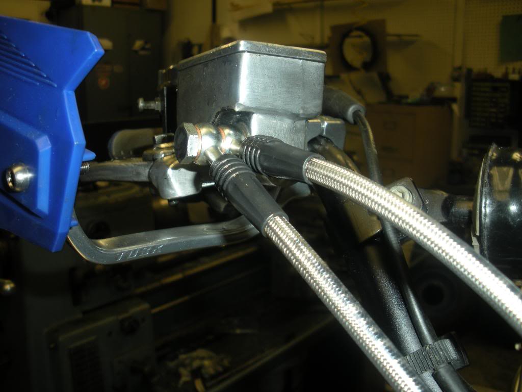

I ran double lines to the front hydros with a double banjo bolt. Thanks for the advice bleeding them!

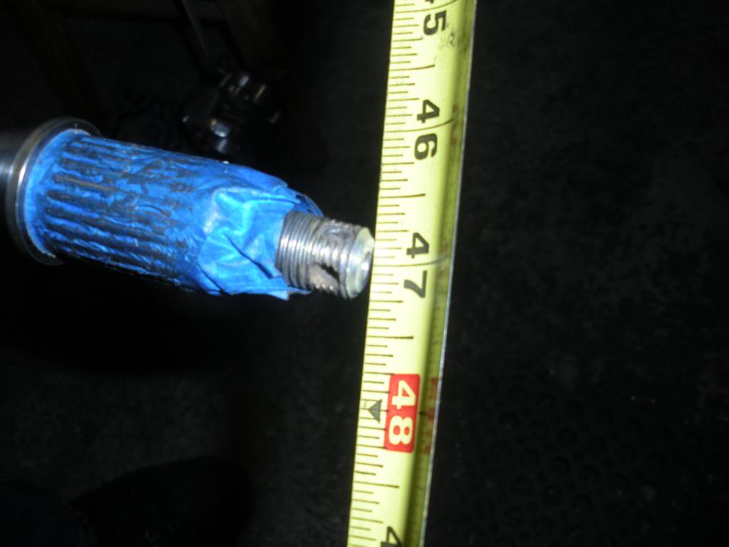

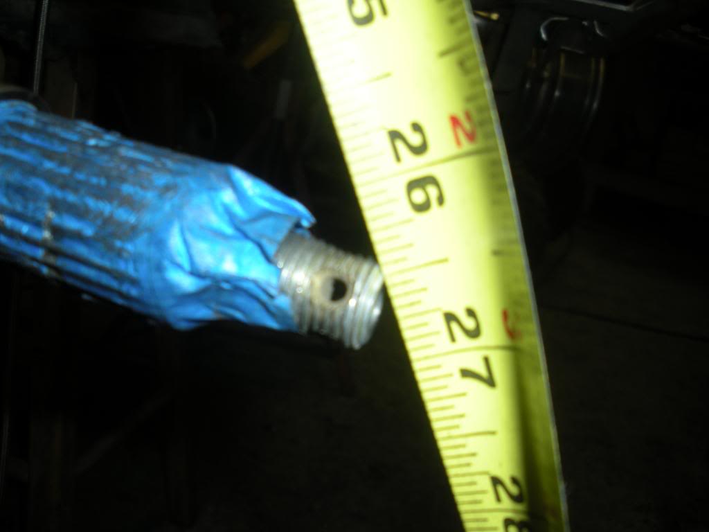

This is the right side of the new swinger from the front upper A arm to the end of the axle.
This is the left side. not bad for the first one.
Right side, frame to axle
Left side, same thing..........Run it!

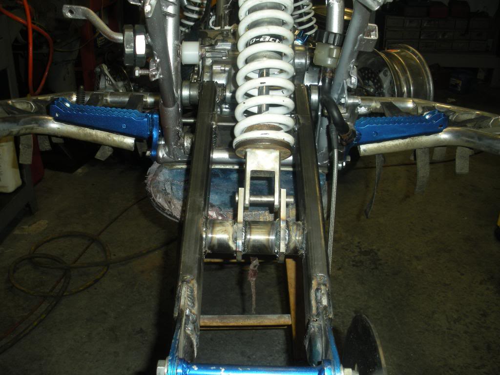

This is the swinger mounted. I still have to finish welding it in the front, add gussets at the front cross member and support the shock mount at the bottom of the swinger.

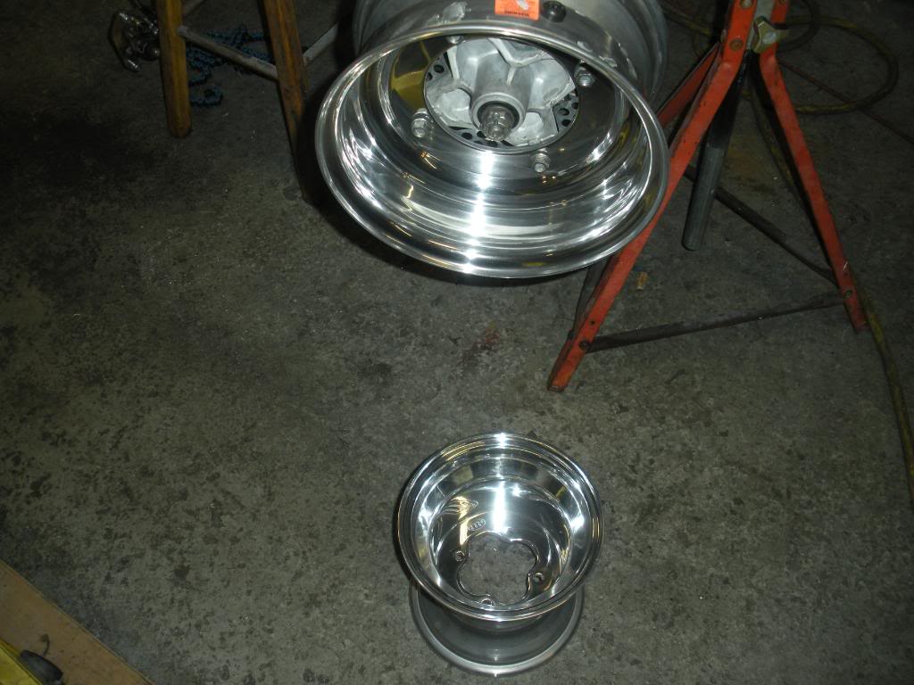

These are the new rims.........Went with ITP's

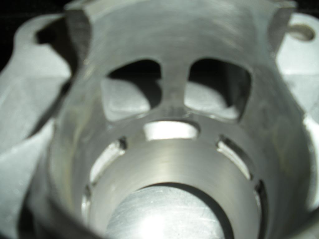

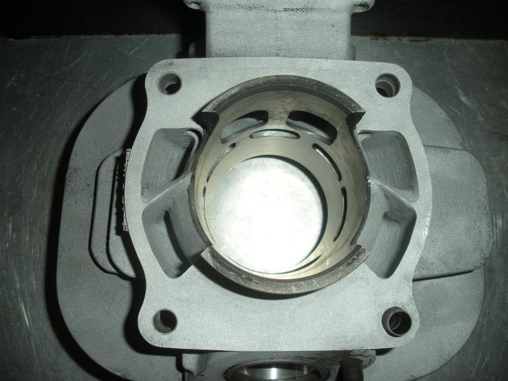

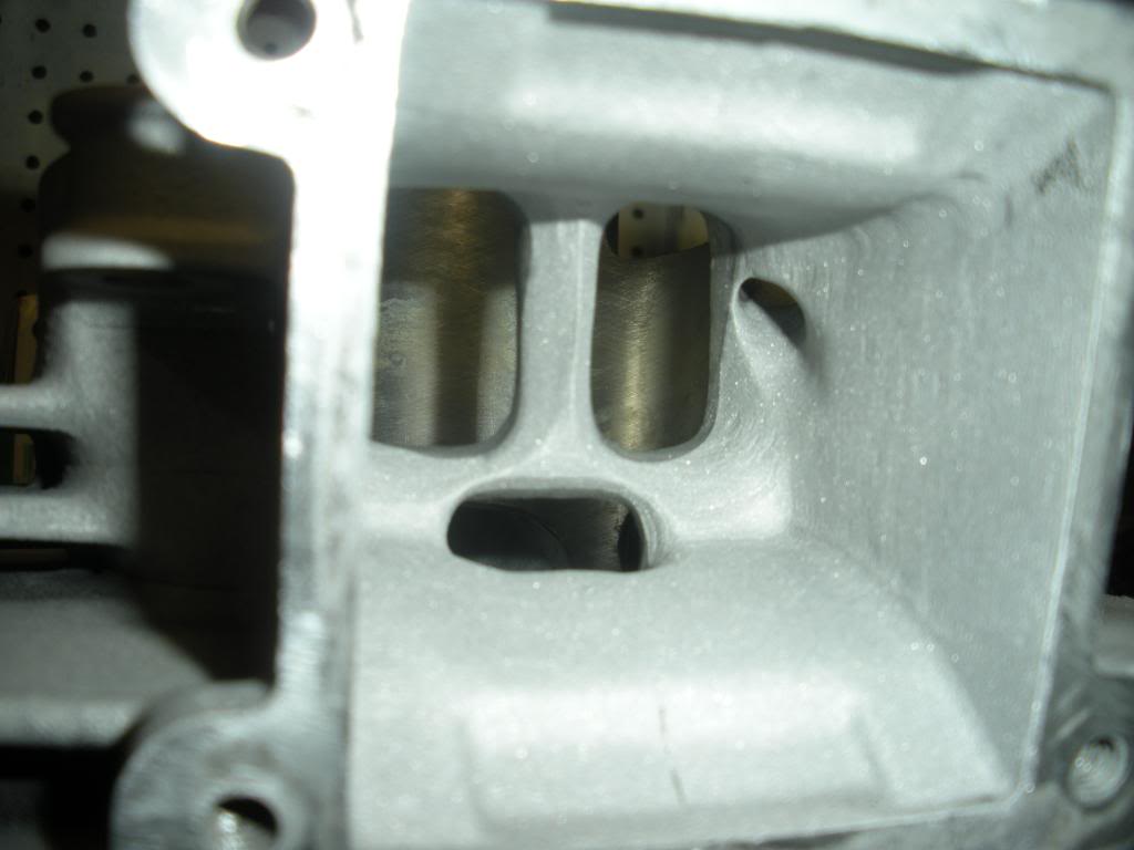

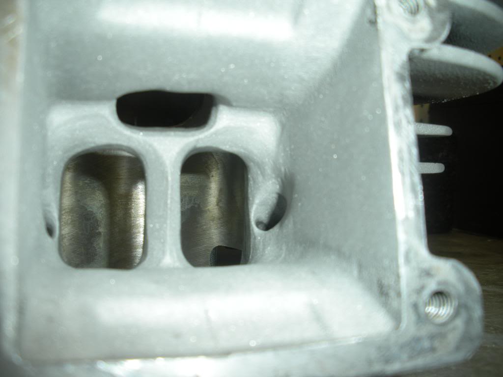

I finished the cylinder porting tonight. I got all of the ports where I want them.......all that's left is to blast them and the outside of the cylinder. I built two cylinders for this project. One with a plate and one without. I'm starting with the one with no plate. I built it for mid / high. I'm also changing pipes. Giving the FMF to the wife and stealing her Toomy B1. I told her she would never even notice and she believed me. God I love blondes!!!!!!! This quad will run by Sunday!

This is the cylinder I'm going to run. No spacer plate.
I'm in the home stretch on this project. All that's left is to put the head on, change tires, finish bracing the swinger and paint it, then check every bolt on the bike (safety first). I'm on schedule to finish Sunday. The cylinder isnt as clean as Awk's but he's a customer. Little more effort for him. More to come.
