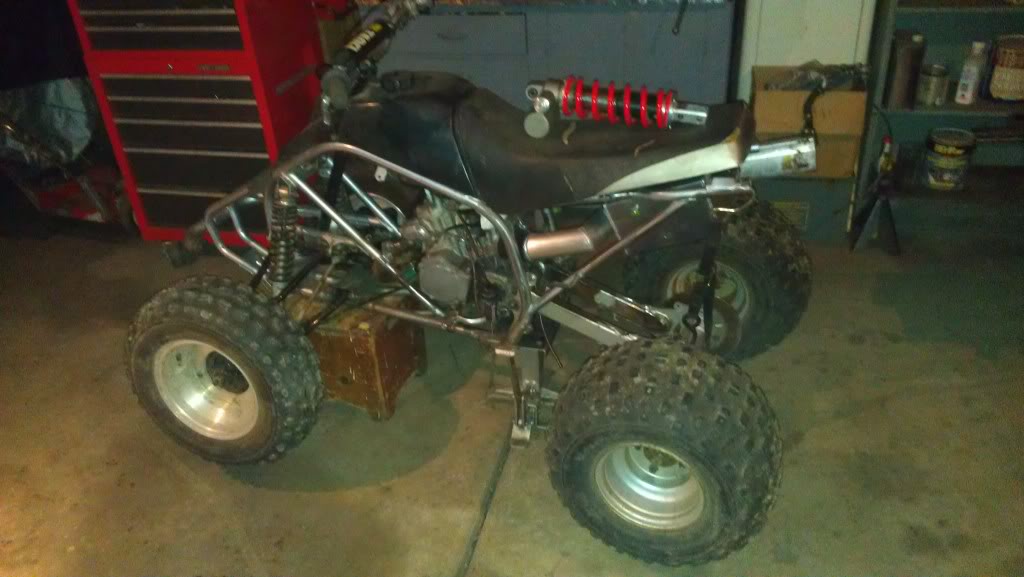

got most all the main welding done today. tacked up a couple things and forgot the airbox so didn't weld up one tab.
I:I look close I:I
I got the motor started. It has an airleak at the exhaust flange so it revved a bit out. Plus the idle screw on the carb was out all the way. Since the kill switch is broken, shutting it down was fun...lol I won't be restarting it till I fix those two issues. Anyway, I started it to see how bad it would vibrate. Well, it doesn't vibrate much to none at all. :D

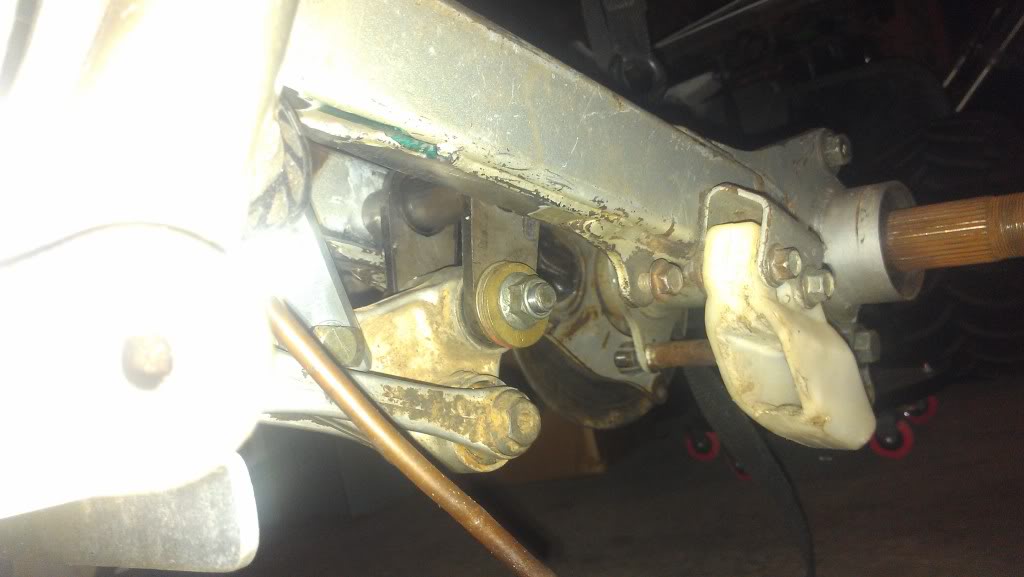

For those who have been following, I was going to link the rear with a banshee setup along with the cr motor swap. Well, I can do it. I figured out what I needed to do. Only one issue came up. That was the shock. I could get more travel out of the suspension but was having issues with the link length. So I'm going to try something else before I go with a standard blaster suspension. I'm picking up a new take off trx 450 rear shock and going to try that and see what I can do with that. I also picked up a banshee carrier for the hydraulic mount. Got my yzf450 caliper to mount but the blaster disk is way to big. So that idea is out. I have another idea that will work. Modifying can be a tedious task. But I need to get this all done so I can get the frame powder coated.
Picked up my new trx450 shock and link today. Pretty cheaply I might add.:D I can make the shock and link work pretty good. Just need to find some D.O.M. in inch and a half and will start getting the mounts made and welded to the frame and the swingarm. I may even just extend my swingarm myself.

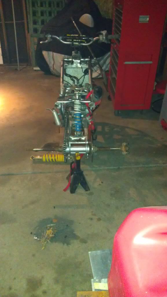

well, here are some more pics. it is freezing but im doing the best I can. I put it together for some inspiration.

Got a couple of the suspension brackets made.
