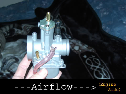

I have this new 30mm carburetor waiting to be hooked up, but alas, there's no port input for 2-stroke oil. Just to get it out now, I ride to BFE on a regular basis and enjoy the convenience of pulling into a gas station at will to fill up the bike. The gas runs out a lot faster than the 2-stroke oil, and I'm not ready to transition to premix because I hate havin' to tie a gas can to my broke-ass grab bar.
SO..here it is;
My question is this-
What's the best way to fit this thing with a nozzle for the 2-stroke oil?

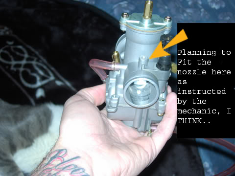

I've only spoken to a guy over the phone at this point, but had a hard time visualizing it, hence why I've taken pictures, Photoshopped 'em, and put them on here for your assistance.
Now, the nozzle is pretty short, so I also wanna make sure I'm putting it in the right place.

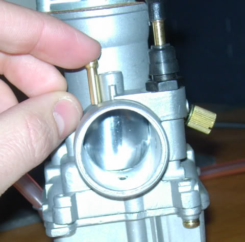

Obviously, if it comes down to it, I can still convert to premix. In the meantime, how should I do this? Is the carburetor made of the same metal as the crank case, thus able to handle forcing the nozzle in after applying blowtorch heat, or should I drill a hole the same size as the nozzle and hold it in place with some sort of adhesive?
And, uh, am I planning on putting it in the right place?

Until I get there, I just need to know 1) If I'm drilling in the right spot, and 2) how to keep the nozzle in there. Thanks!
The placement on this carb is totally different than the stock one. I'm not sure that the port in that location will let it mix correctly. I'm not sure that it needs to mix but I'm betting that it needs to.

lindso, take a real thin pick and stick it into that hole to make sure that it passes all the way into the venturi. you don't wanna mount up an oil line to a plug to nowhere.....then if you're determined to make this work, i'd say you don't wanna just glue it into there cuz if that sh*t pops off while you're on the trails, you're f*cked.

get a tap and die set (a decent one) or just take them to a machine shop and have em tapped and died. also, i would add a couple layers of teflon tape to the threads on the nipple before installing.
after you've got the line hooked up, pull the spark plug and crank the kickstarter a bunch of times to make sure that the oil is flowing into the carb.
my only concern would be if you're increasing the carb size (and of course the jet size) and running the stock pump, then your oil ratio is gonna be off......it'll be like 45:1 or something. so the best way to fix that would be to install a smaller pump drive sprocket (maybe 1 or 2 teeth), but i'll be damned if i know where the hell to find that!
...get a tap and die set (a decent one) or just take them to a machine shop and have em tapped and died. also, i would add a couple layers of teflon tape to the threads on the nipple before installing.
The nozzle is a brass piece literally 1mm thick, I don't think taking a die to it is the best idea. I thought about it, but it's so thin and the metal is soft, so I dunno..

Heres your problem. That 30mm carb that you bought is meant for a more built motor. Most people who build their engines use the oil block off kit. In fact if you get the 240 kit you HAVE to block off the injection. I can not think of one built blaster that is still running the stock oil pump. It just cant keep up.
