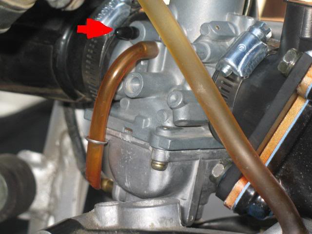

Look and see if it has the oil injection port. If it does, it's a Blaster carb. If it doesn't, it's off something else.
carbplug004-1-jpg.12560
