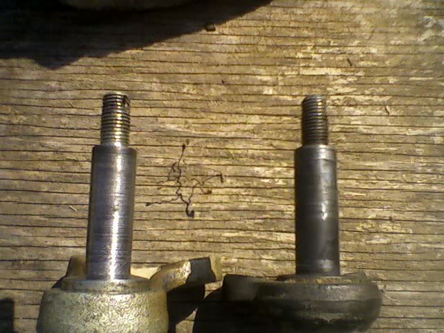

it will not. the bottom mount has to be turned down on a lathe. Its very little work, a local metal shop will be able to do it easily in little time.
Blaster on left banshee on right
After i turned it down. banshee on left, blaster on right
