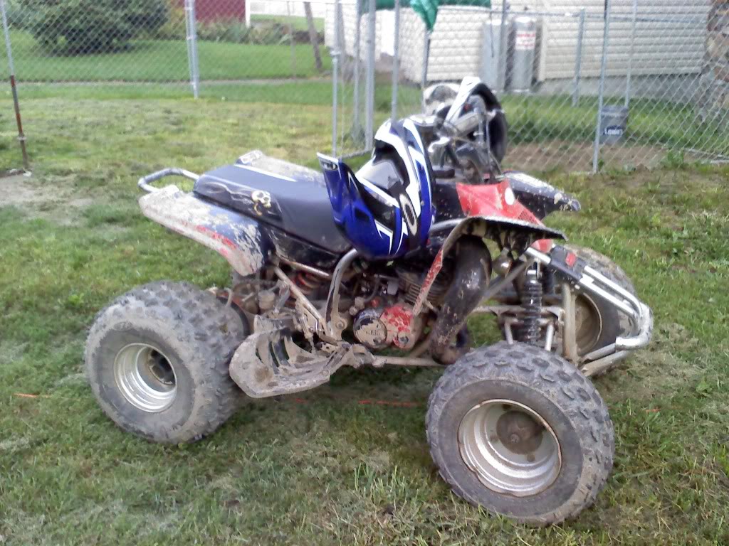

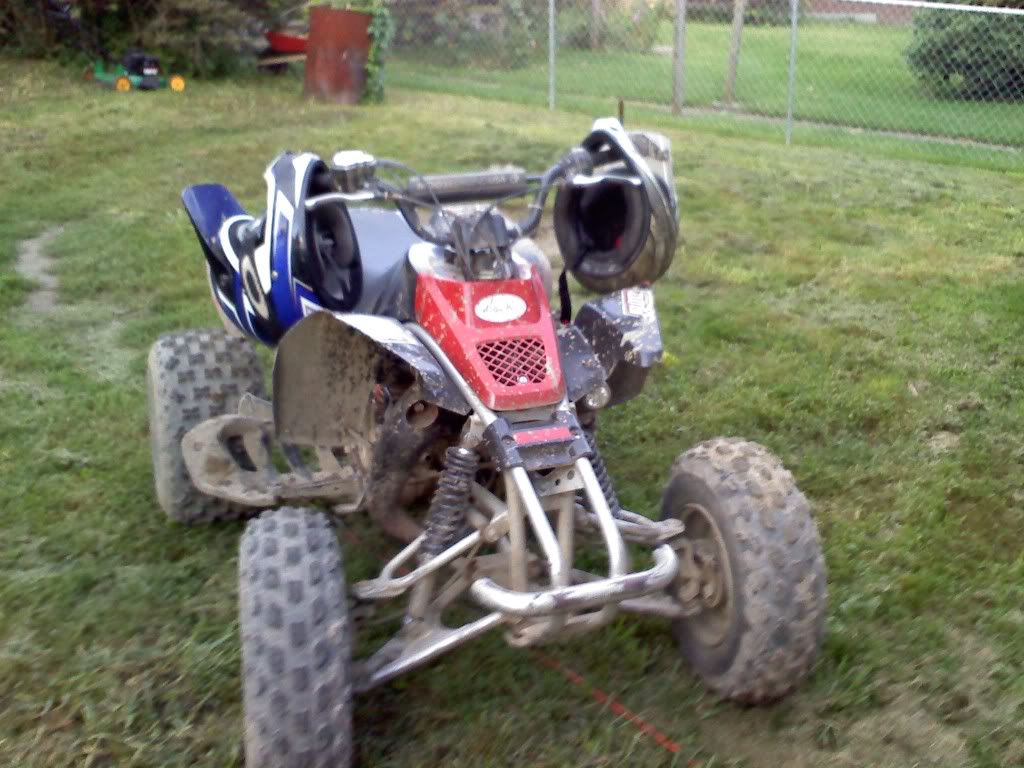

A Arms: stock
Swingarm: stock
Steering Stem: stock
Stabilizer: none
Axle : stock
Carrier: stock
Locknut: stock
Hubs F|R: stock
Bars: stock
Throttle/Clutch Lever: polished|also polished
Grips: cant remeber
Nerfs: none
Bumper: stock
Grab Bar: stock
Front Shocks: stock painted
Rear Shock: 450r
Brake Lines: gsxr
Rotors F|R: stock
Rims F|R:|stock: aluminum not sure on brand
Tires F|R| dunlop: itp holeshots
Body: stock
Frame: stock
Plastic: Rear stock painted front stock painted and cut
Graphics|Seat Cover: after market seat cover unsure of brand
Number Backgrounds: none
Handguards: none
Bar Pad: moose
Fuel Tank: stock
Engine|Drive System:
Cylinder|Head: .040 over bore, strokedtatter aggr trail port: kor redsigned head
Bore & Stroke: 67mmx57mm
Displacement: 201cc
Cam: custom purple one to match powerband
Carburetor: mikuni 28mm
Air Filter|Box: uni? no lid
Pipe|Silencer: graydon proline, toomey b1 silencer.
Clutch|Plates: stock
Gearing F|R: 13/38
CDI|Killswitch: stock
Cooling: aircooled
Other: yfz450 heel guards,gsxr rear brakes,5 inch rear wheel spacers

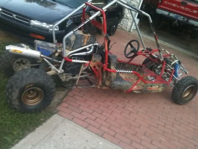

I'd like to nominate "thatcarguy09" for his hybrid blaster......:eek:
WTF ... that thing is crazy hilarious. We should have a "WTF did you do to your blaster of the month" thread and that dude with the trike can throw his in as well....lol
