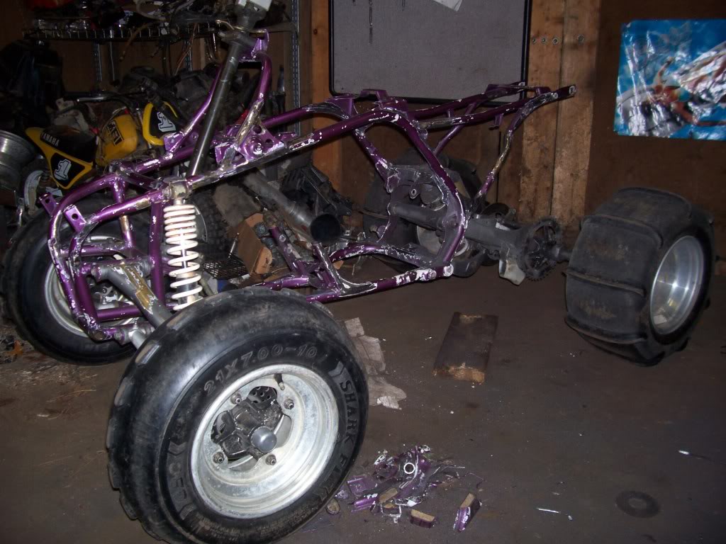

for the record it wont stay purple..hahaha all the welds are getting smoothed also.
what a pile-0-sh*t cockstar.....lol jkjkjkjk man easy now calm down there ya go now take a drink does that feel better ....goooood
more progress.....

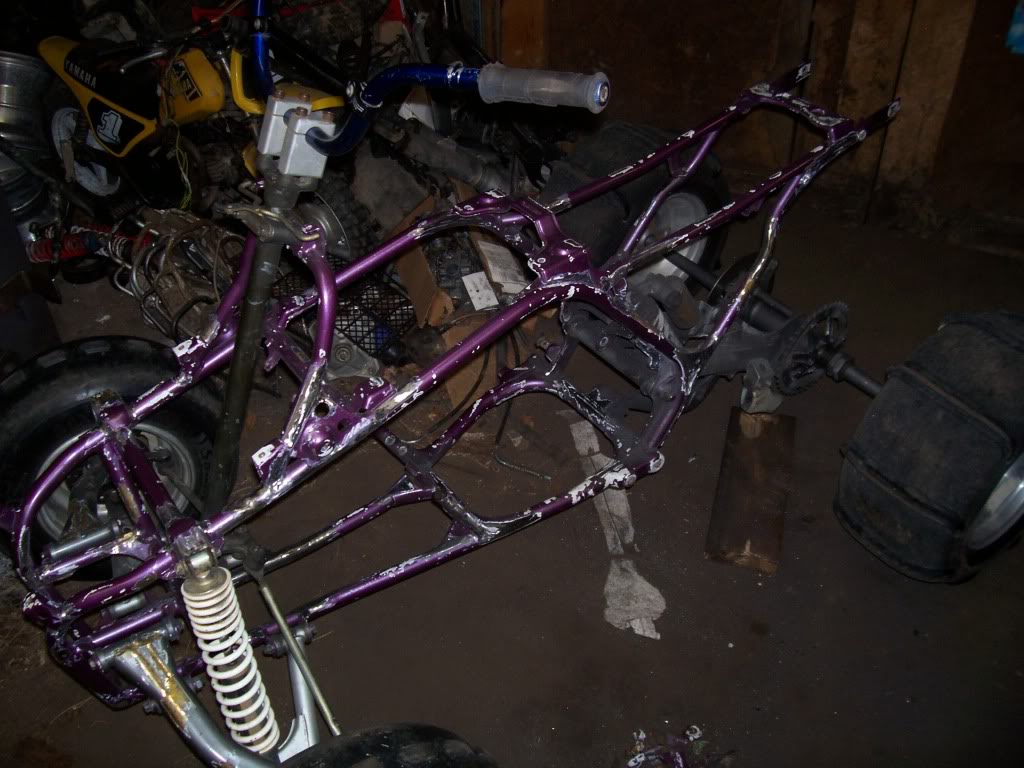

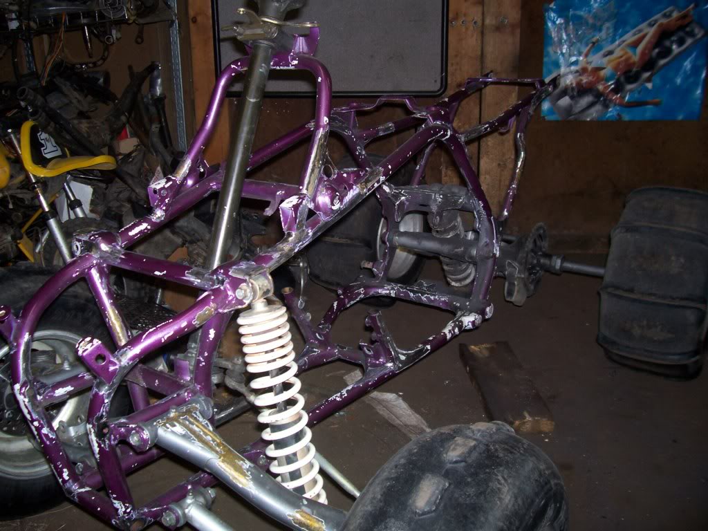

got a good portion of the welds smooth, and finished cutting whats gonna be removed. there are a few spots that are getting some gussets, like in front of the motor mounts, and between the frame rails, where i cut the factory one out. still strong and stable, and also lighter than stock.....

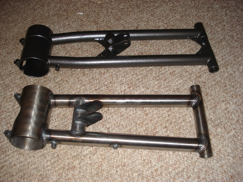

also gets a 4 over round carrier swinger....silver vein one, the bare one is the one on my trail bike

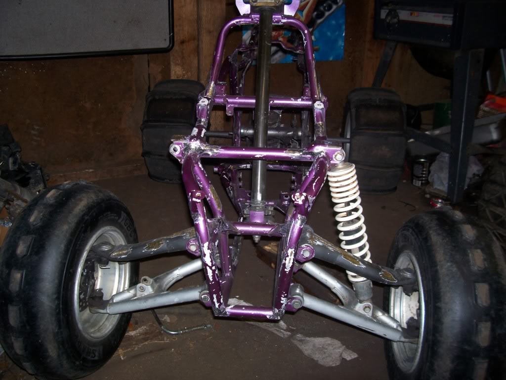

those first gen banshee's have funny a-arms haha, lookin good so far though! love seeing these old hawgs get all redone, given a new life
j arm bikes are the red headed step child...nobody wants em. but for something like this they are great. cuz they are lighter. not as much frame, and just that top j arm....thats why i picked this bike.....i coulda used an a arm chassis, but this was just sitting there calling my name..hahaha
yeah blasters always had a arms, they never gave them this style arm....surprisingly tehy make +2 arms for these too. im not running them, just changing the shocks. i wnat a nice ride, but dont really need the wideness for stability.....dual duty, duner/drag racer. if i wanna climb hills i can, if i wanna do some drag racing i can. est 85hp.....i think it will be fun....

its not all there either..haha the 2 down tubes are on the bench, cuz i thought about reusing them as gussets..but i have a different idea. i'm shaving ounces now, shaving all the welds smooth, and drilling holes in a few spots for looks and less weight.
im almost to the point where i have to fill/patch with the welder. then back to grinding!!! then after all the grinding, its off to sanding...gotta smooth out the grind marks so it wont show thru the powdercoat.....

yeah time consuming as hell. j arms are wierd/ugly/funny..etc. but when you wanna light bike, its a good platform to start with....im not a fan of them, but for this project, i had to have it.....i actualyl traded a 2001 a arm frame for this....kinda crazy yeah, but i have 2 other a arm frames, it was time for a change......so i went nutzo on this....

The frame looks ALOT cleaner without all the extra fat on it.
Care to detail what all you removed?
who built the swingarm??
the stock length (trail bike, bare in picture) swingarm was built by slc quad customs, paid 200. the 4 over was built by some dude on ebay. he had a whole lot of them and sold them for 150 each. he was getting out of building them or something....and ebay deleted his account......cuz after i bought it, ebay sent me an e-mail, and i couldnt find anything on him. his listing was gone, and it disappeared out of "my ebay".....luckily i got mine....a friedn of mine ordered the same one, and he got his also....
