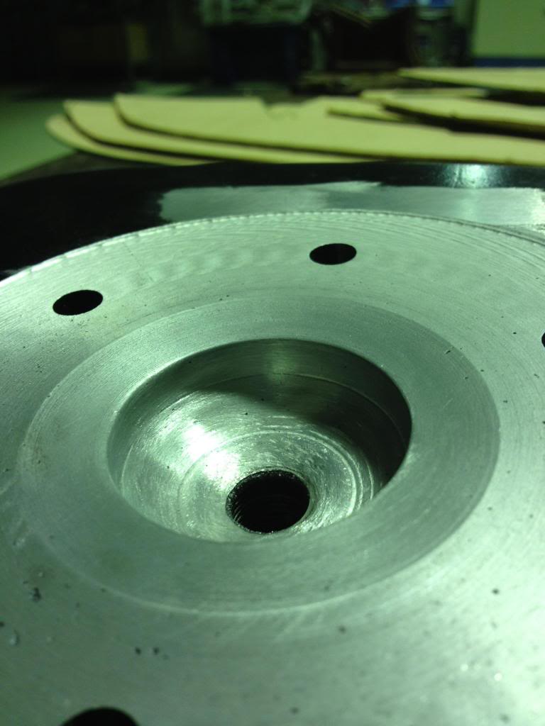

I used a small boring bar for the combustion chamber at about 80° so nearly perpendicular to the head gasket sealing surface and have since gone a bit deeper to increase the volume to ~23cc
I will go measure it up and get a new picture later on but at a guess, the near perpendicular cut is about 1/2" deep before a radius of about 1/4" and a flat section around the spark plug!
After seeing more pics I'm keen to get my cylinder back off and work on the intake side as well as more on the exhaust!
All I've used for my port work is a dremel
