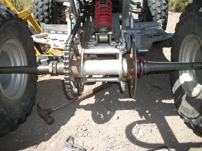

this is the only pic i can find of the spacer. in this pic, i am running the shee axle and brake hub cause i thought i needed it for the shee brake hub. i was wrong and it put my axle too off center for the banshee axle and hub. but this is the spacer i fabricated for use on the stock hub with the banshee axle. i just went to ace, got the biggest lock nut i could find, heated it with a torch, pounded it with a bfh to get it flat, then honed it out so it fit on the axle.
oh and the things circled on the caliper are spacers i had to make. the banshee brake hub with the caliper sat too far towards the carrier, so i used some 1/4 inch spacers so i didnt have to modify my brake mount on the carrier.

^^wrong and wrong again. i am running a cable brake just fine on my blaster with a banshee axle. also, you CAN run a stock blaster brake hub and caliper on a banshee axle. you just need to space it as i showed in the pic. trust me. i ran my stock blaster hub for a while with no problem. then i got the shee hub so now i am running my shee axle with my mechanical brake. absolutely no problems

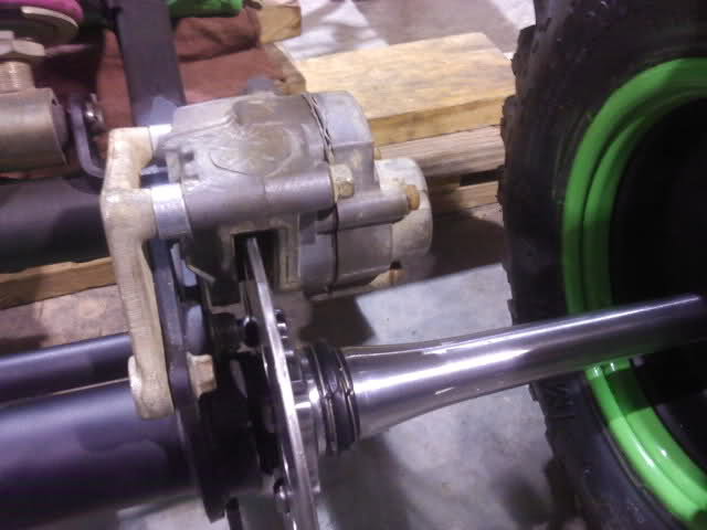

Heres what i came up with last night. The stock bolts barely went threw with the spacers so i got to go get some longer ones but i think this will work out just fine
it should. did you have to use the spacers in the brake mounting plate like i did? or did you just put them there? you should think about getting the shee brake hub in the near future though. thats one shiny axle btw
youre running the caliper bracket on the wrong side btw. if you put it on thr right side of the carrier, i dont think you will need the spacers on the brake.
Thanks...took me about 3 hours to polish it lol. But the only places i used spacers was on the bolts that hold the carrier to the swing arm and where the caliper mounts to the bracket. Also the bracket has to be on the wrong side or the left side of the caliper hits the rotor.
yea..hopefully it will hold up well. ill report back when i get this blaster goin....maybe it will help others out
