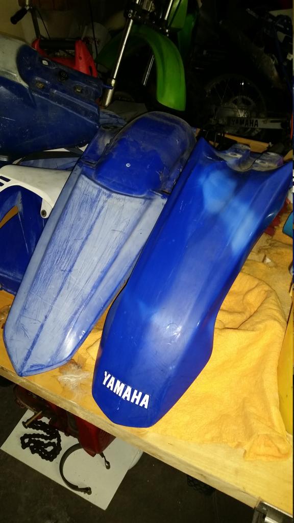

I got this bike. 06 Ttr230. Craigslist, 500 bucks. It spent it's life in the Florida Keys.
The sun and salt water took its toll on the whole bike.
I read about using Olive oil, so I had to try it. Sounded to rediculous to work. A little on a rag, wipe on, let sit wipe off.
I didn't take a before pic but the front fender was just as bad as the rear.
