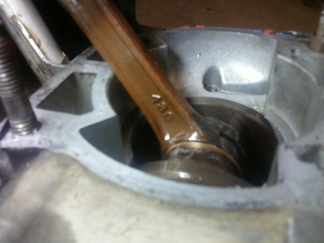

Crankshaft
This says "H"
"43G"

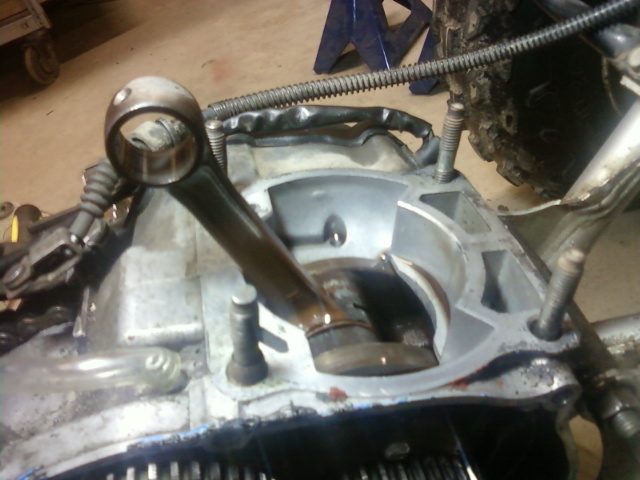

More crankshaft
That's an OEM gasket. It does looks like multiple layers but it's not. It's kinda gooey sticky on both sides to take the aluminum REALLY well.
That appears to be a stock stroke crankshaft. You'll have to measure the stroke before you put the head down with a depth caliper but it looks like a stock stroke crank. It's clean dude top end gasket set and rock out!
Sweet. Thanks! I just wasn't sure about the crank. Probably should've looked 10 feet to the side at my other bottom end and the other crank to see about the "serial numbers" on the connecting rod. I'm fine with it being stock stroke, I just thought it'd be pretty cool to have a stroker in there.
