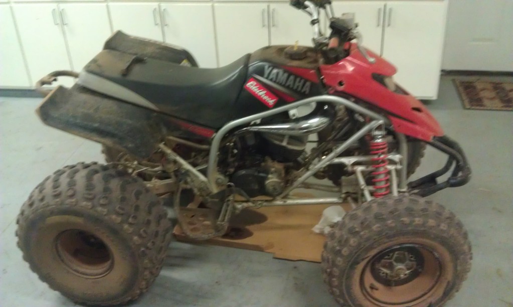

hi i just picked up two blasters an 92 and an 03
the 92 is in pieces but had an rebuilt engine
and the 03 has a crank that detonated and deatroyed the cylender
i put the 92 engine in the 03 frame
the only thing i have noticed is that the 92 is an 5 speed
is there any thing i should be concerned a bought or does everything fit between the models?
the bike has vforce reeds, full fmf exhaust, oil pump plate and a vitos air filter
im runnning 32/1 in it

its leaking oil out a nipple thats next to the cylender on the right side
is it an trans breather?

I thought all blasters had six speed tranys, nt 100% though, so maybe the 92 has one of the older bike motors like the dt or it 200? maybe someone with more knoledge of theese motors can chime in. post a pick of the 92 motor.
I just looked at a 92 tranny parts breakdown and it showed 6th gear parts.
that nipple is the breather and there should be a hose attatched to it either routed up next to the gas tank and hanging over the exhaust but a lot of people re route it under the seat and out the back. if you have to much oil in it it will come out there.
