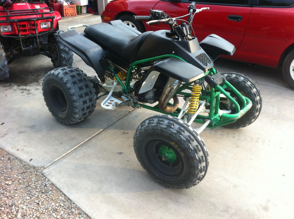

Before:

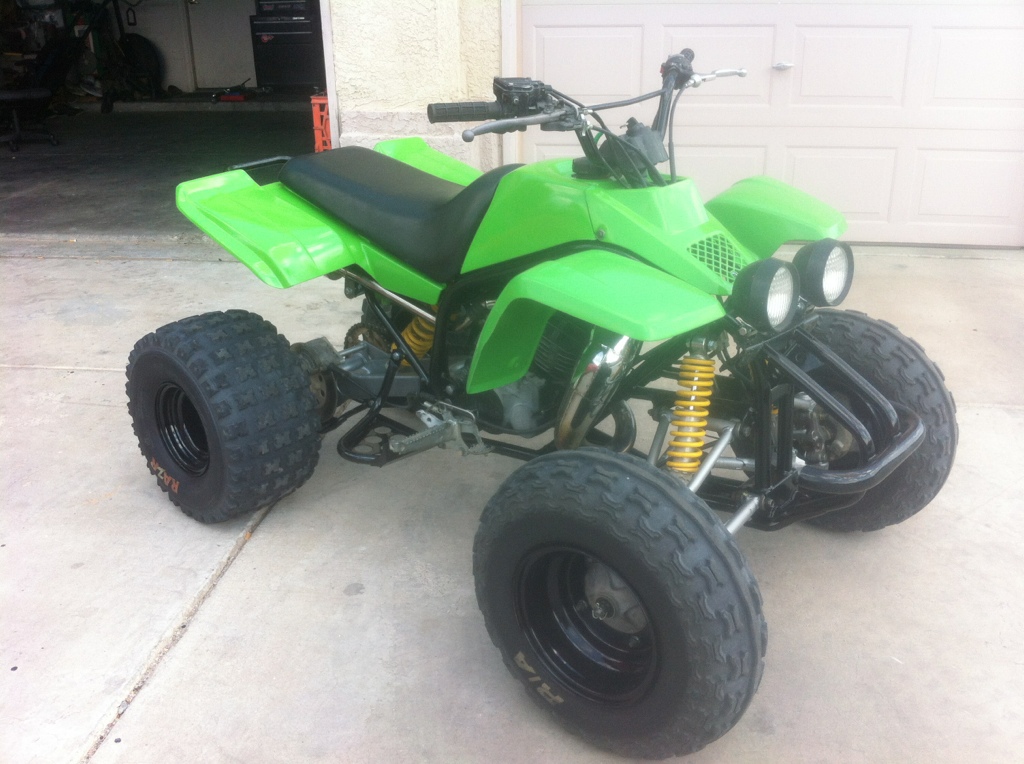

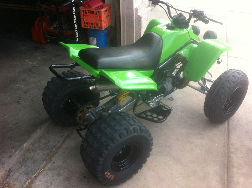

After:

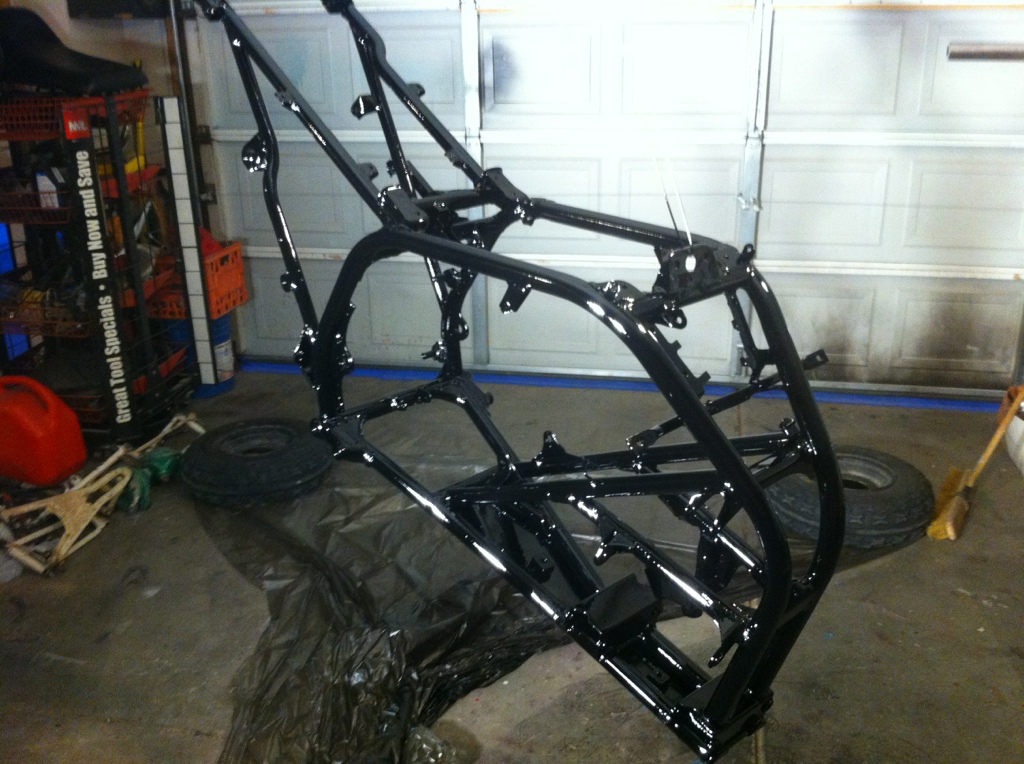

I took some advice I found on here before I joined and used an industrial enamel coating for the frame, seems very strong and chip resistant so far

Before:
After:
