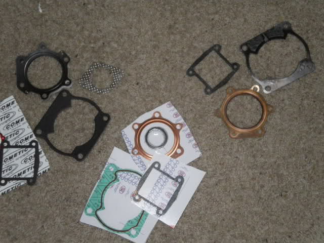

You have a crush seal that looks similiar to an metal ring that is the stock seal,
It is pictured in the unopened package with the stock type head gasket
If that is not sealing properly, Cometic makes a exhaust seal thatr works in conjunction with the crush seal - Pictured here -

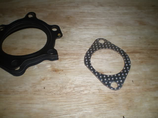

the cometic gasket works great but you need to make teh holes considerably bigger in order for it to fit. i have no idea wtf they were thinking there.. its not even close lol :eek: :eek:
u can get the one beats is talking about at any auto store, i used them and it stopped it completely, they are thermo gaskets, cost me 2 bux i think.
