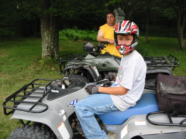

my brother had one of those. this bike rite?
anywhooos, try connecting thr charger directly up to the positive and neg wires that go to the battery. and then try to start it. it it dosent turn over or click, check your ground alll ur ground wires. and check that the key is working, cause without the key working, it wont turn over or anything. so try to bypass that. than turn it over.
yep one of those, except its the older 225, and yes it will start if you have it hooked up to another vehicle or a booster, so i know its not the starter or the solenoid. When it is running there is no charge going to the battery and none of the lights work, and about the only thing I can think is that its the pick up in the stator, but was wanting more opinions on the matter.
