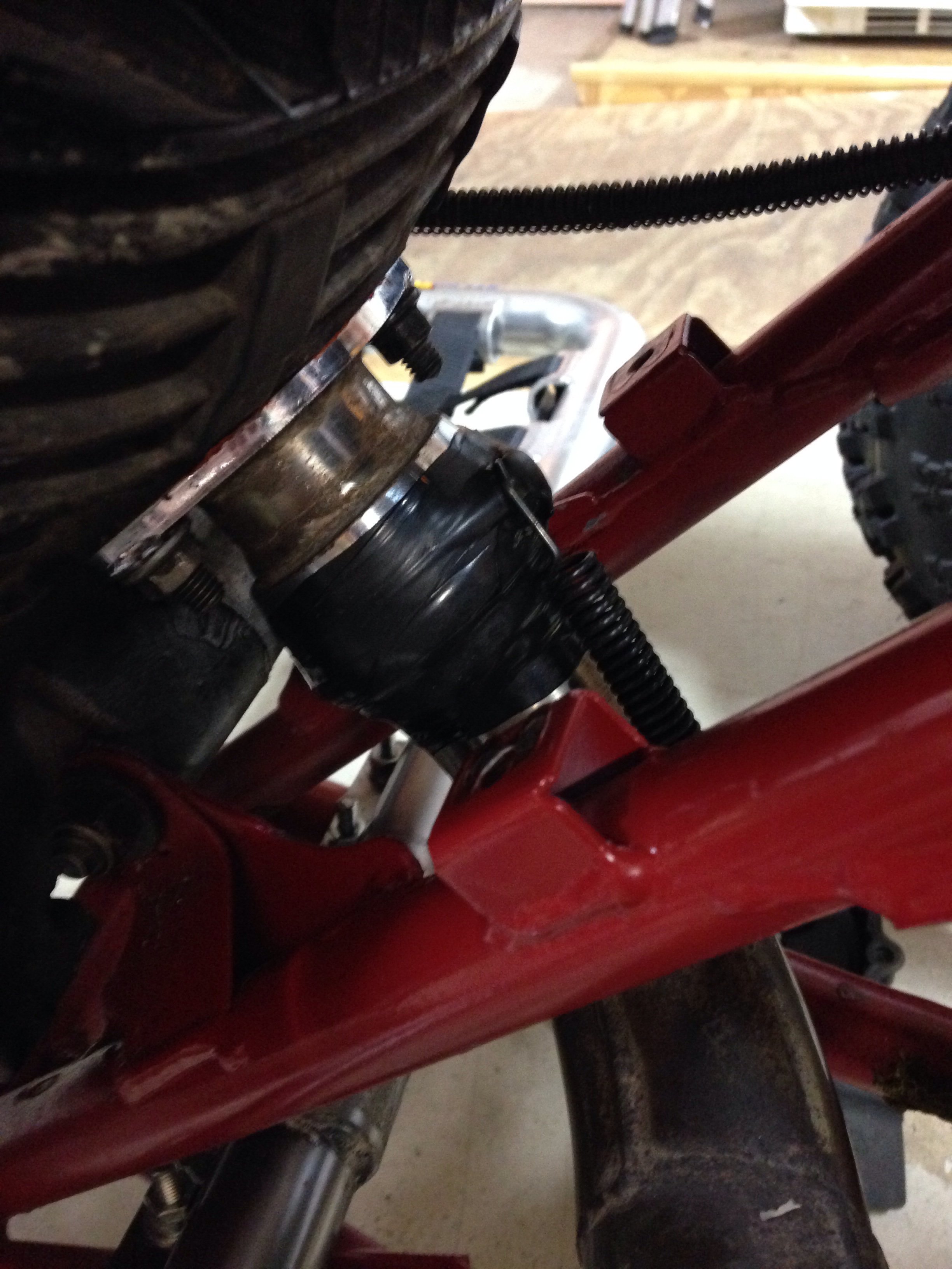

ah yes it has been a while. either way all i need is the plate with the 2 bolt holes. i doubt anyone would be scared of chopping a stock header
image-jpg.13760
perfect time for him to post these pictures :D
again, it's not going to work, it's stamped steel and like hollow on the cylinder side. it will not seal to the cylinder, ever !
it would need slid onto the pipe, then a raised end that matches the crush washer welded to the pipe to trap the flange.
