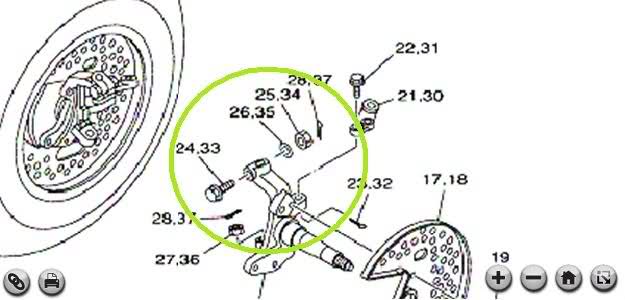

i thought all blasters used the pinch style on top ????
and banshees were the ones that use the threaded style ????
if fact heres a link to an 04 yfs200 blaster from bike bandit and it shows the pinch bolt on top ?????
2004 Yamaha YFS200S BLASTER Parts, 2004 Yamaha YFS200S BLASTER OEM Parts - BikeBandit.com
heres the pic...............
i think you need to ream and cross drill that spindle to accept our pinch bolt ball joint, not sure if there is a DIY on it or not ???
but some members have done it, i believe dualstroke can steer you right, and also what size reamer to buy ????

Not the A-Arms that have me confused but the 2003+ Blaster front Hydro spindles that look like they call for the bolt joints, not plungers, what the F am I missing here???? Does not look like the plunger ball joints will mate to my 2003 + blaster front spindles????

You've got banshee spindles....
They have taper ball joints upper and lower and the tie rod ends come in from the bottom instead of the top like the blasty.
Also, the banshee spindle has a different angle between the spindle and the ball joints. Unless you have a-arms made that are the correct length, the spindles will leave you with MASSIVE camber
