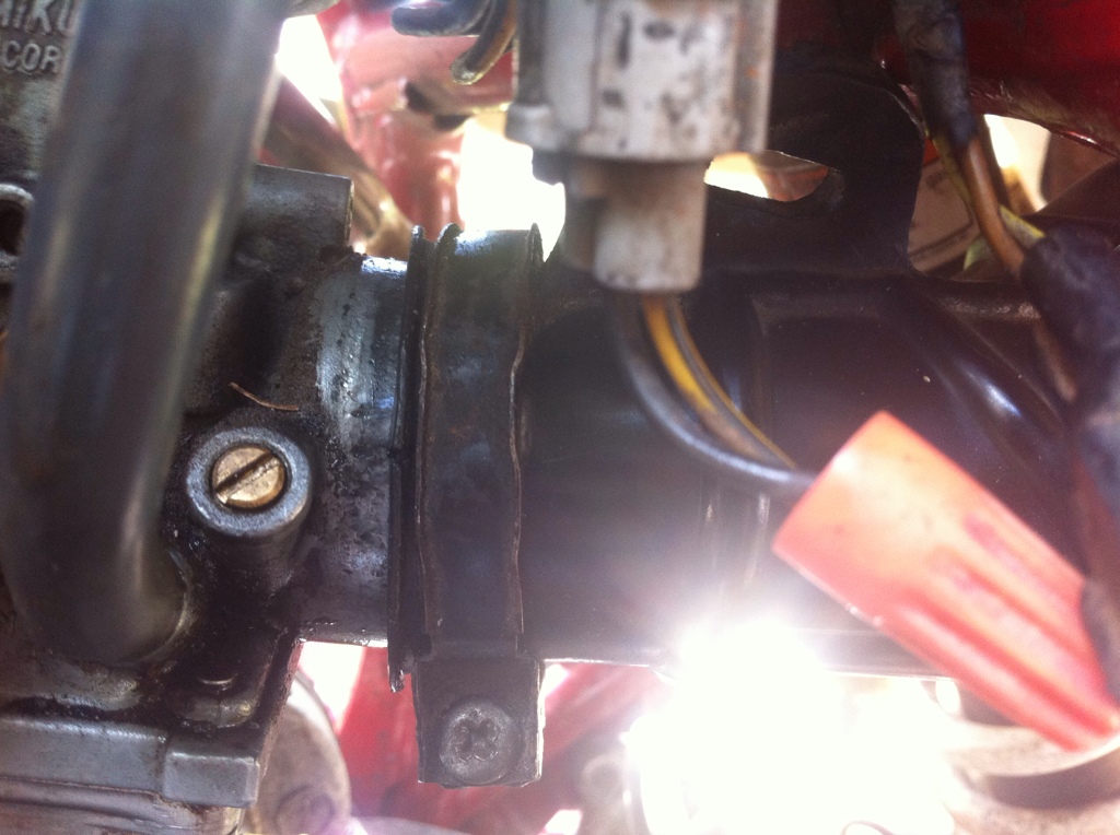

My intake boot(the one on the rear fenders) barely fits onto my carb it maybe goes on 1 millimeter, wtf (it wasn't like this on my black fenders.
well theres a hole in the intake boot that sits on a peg on the frame to hold it close to the carb , I see that it is not on that peg , it needs to be manipulated !
loosen your plastics up and push them forward , the rears have slots in them and can be moved around some , just a thought !
does it look to be the plastics or the boot itself ?
can you transfer your old boot onto these plastics ?
