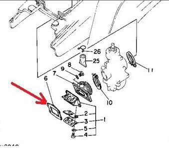

i use 2 COMETIC gaskets and a thin layer of ultra grey
I'm with noober on this one yes one gasket each side, and a thin film of Grey or copper!
the stock cage or intake (i forget which one it's been so long)
has a built in rubber gasket and requires no extra gasket, my experience is an extra gasket there causes leaks

aha, my old ass memory is still intact, as shown below only the "reed to cylinder" takes a gasket on a stock system, the intake boot has it's own built in rubber gasket that seals to the reeds, i used a gasket there once and it leaked bad
