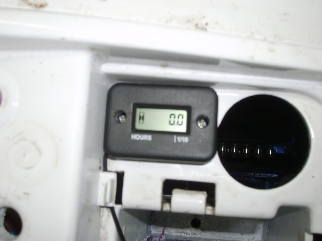

hi i just installed an hour meter does anyone know how long before i have to change the piston?? and how many hours for bearings??
my blaster has a 244cc ct kit 45 horces
